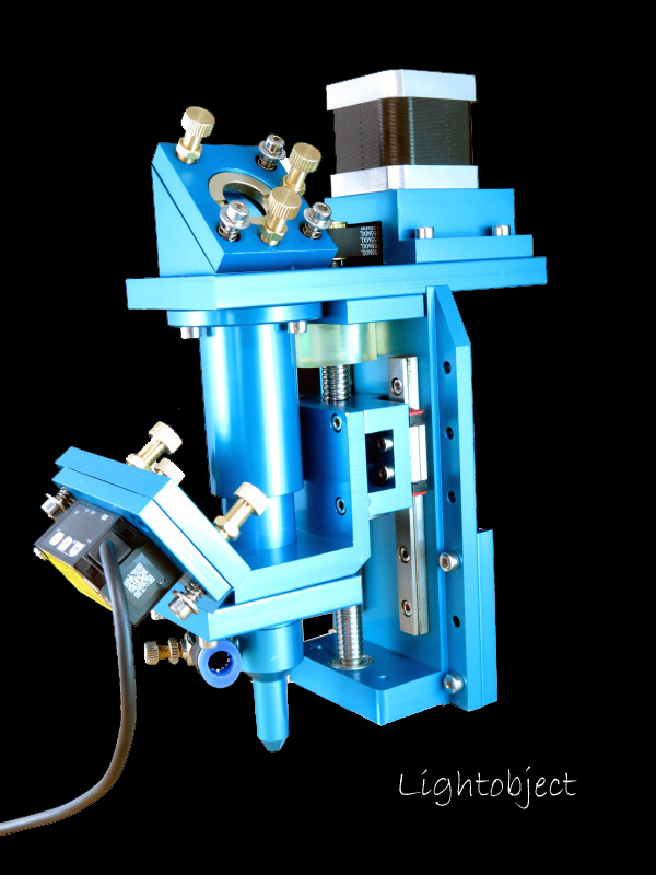

I have that idea back to 5~6 years ago. At that time, I couldn't find any digital distance sensor and thinking to design one. I went to talk with an engineer in Parallax, Rosevile in California where is 45min drive from my office. Anyway, long story short. Recently I found the sensor so I teamed up with my buddy Rix who know programming well. So, we split the project in half: hardware and software. I take care the hardware production and he take care the coding. First prototype was terrible because wrong ball screw was using and some design flaw. It cost me a trip back to China and got it fixed. The first version could travel as fast 80mm/s. The revised model can run as fast as 300mm/s.

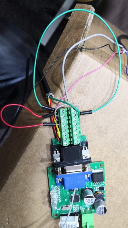

We need to re-work the circuit board on the ATF. We found some glitch with the current board. So, I need to push 2 more months before launching

Update:
This version has 'sinking' issue fixed and bouncing has been minimized by changing sensor location
What is next? Need to make sure no more bouncing appear during cutting. Fine tuning on sensitivity to get optimized speed

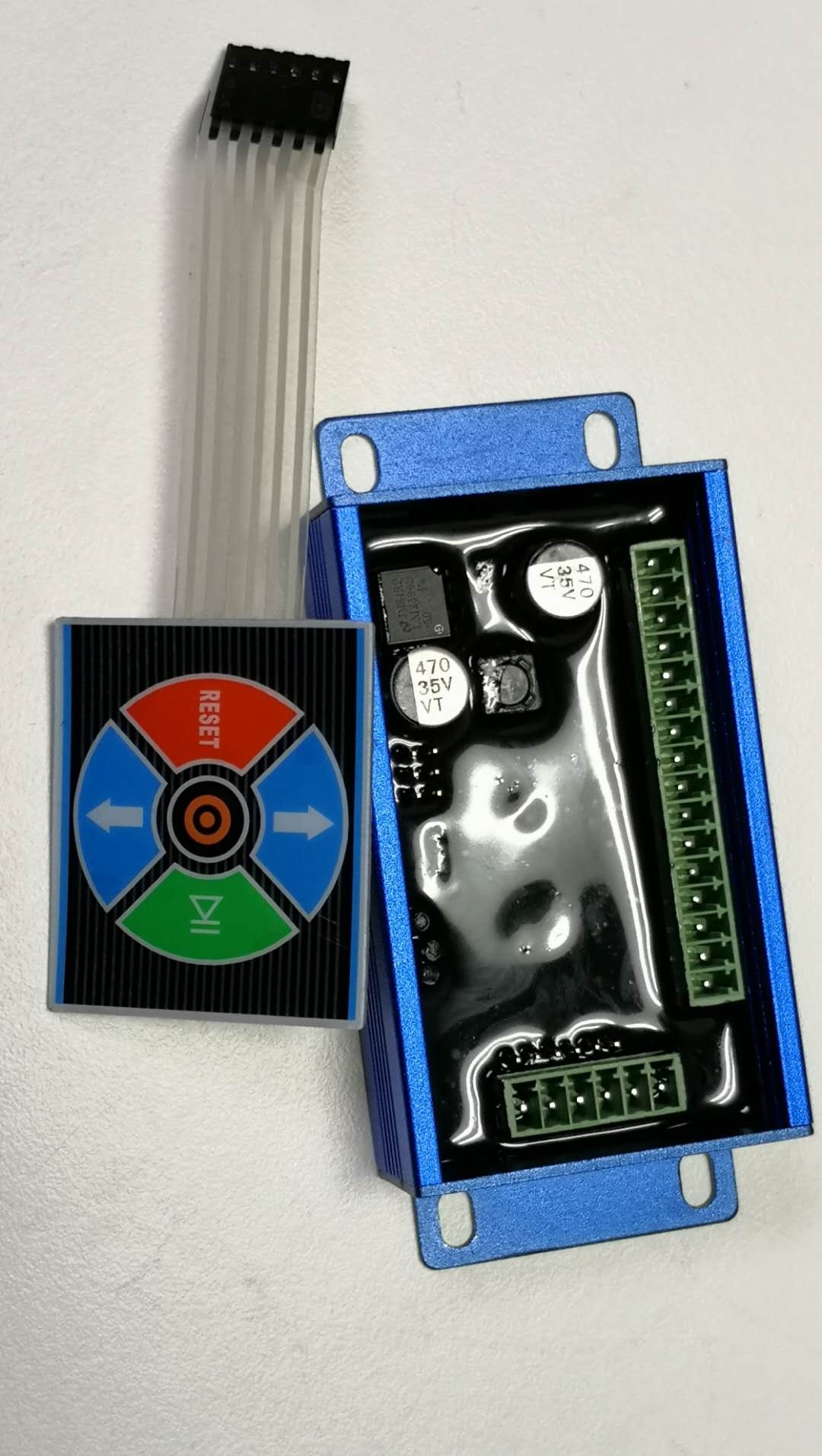

Logic is OK and it works as expected. We redesigned the controller board but the tech made a mistake so we have to send it to fabricate again. Bummer!
I'm heading tonight and I'll be there by 15th. I'll spend some time with the tech to get it done. Once new board tested and function well, we're ready to ship. Currently, another tech is working on the manual. I'll post it once completed.
