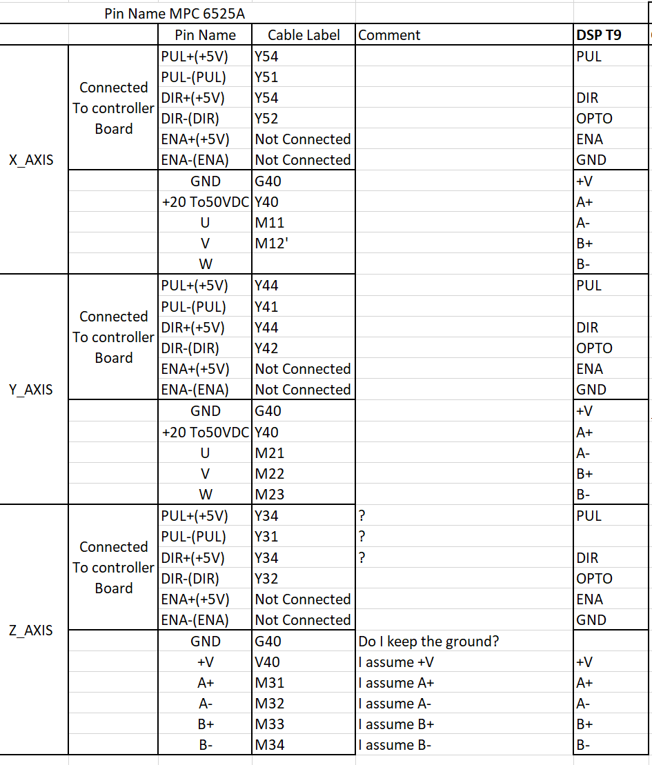

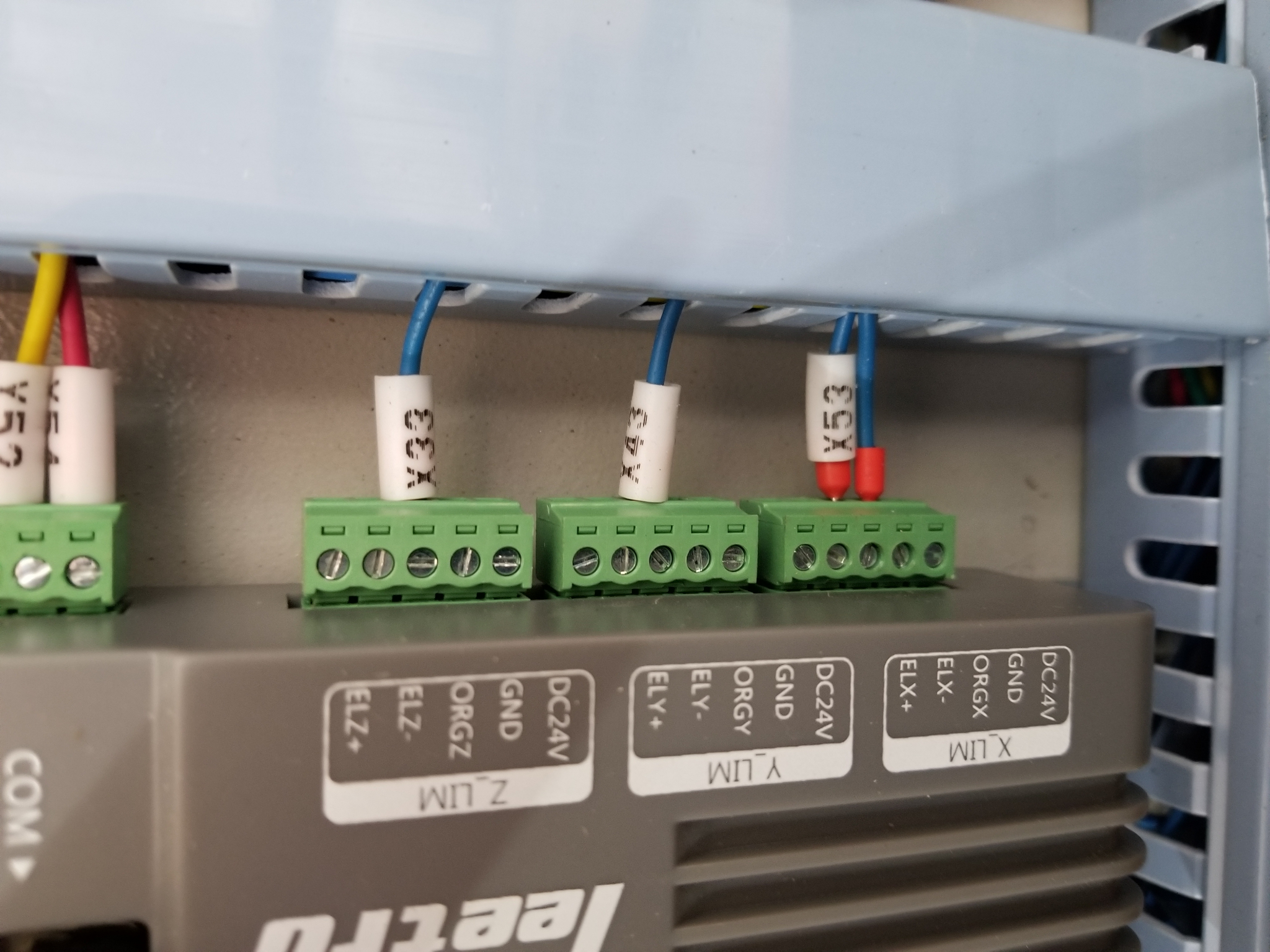

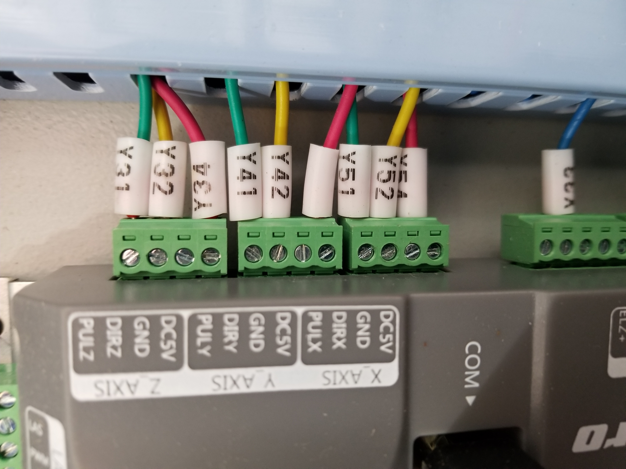

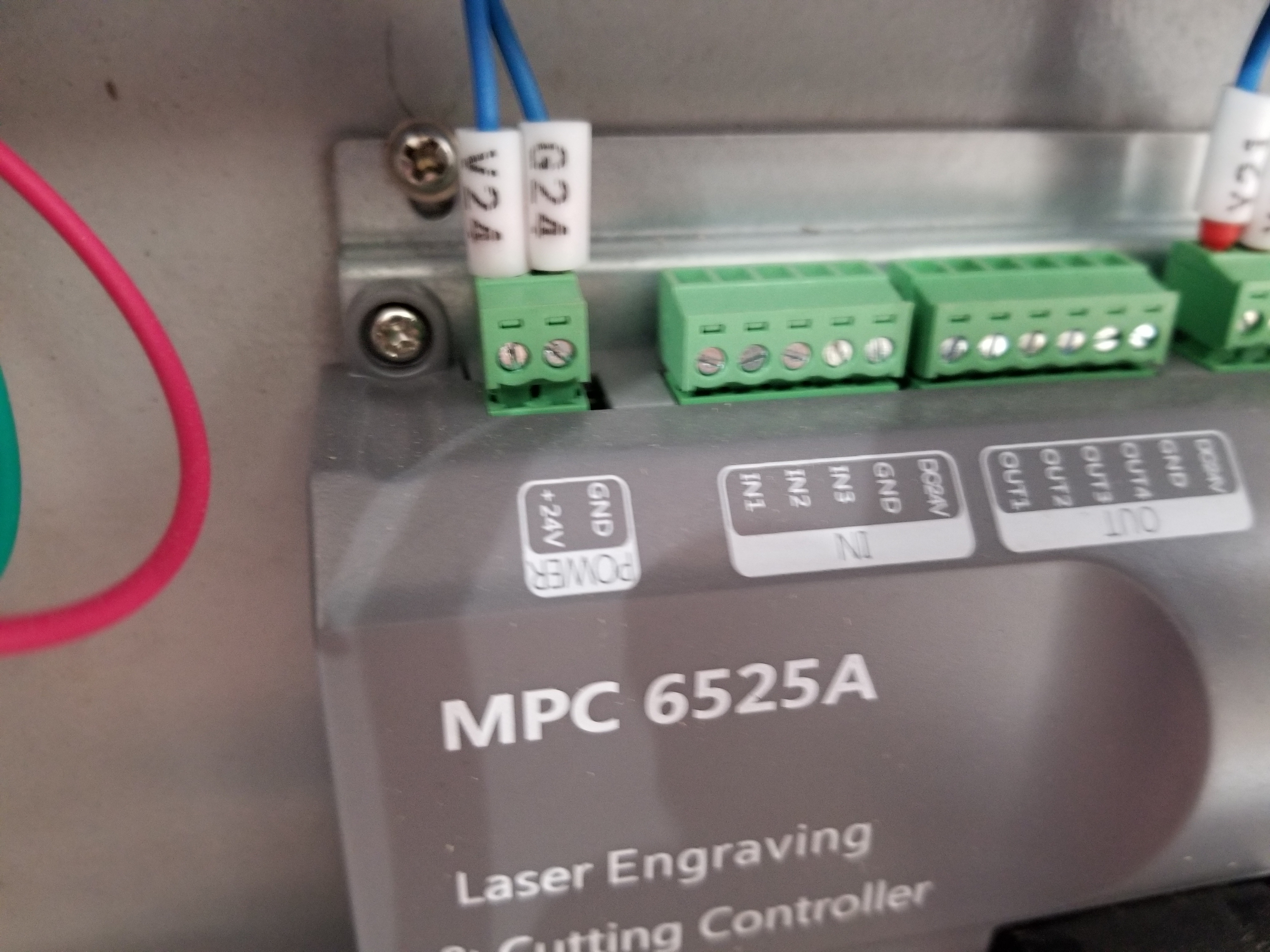

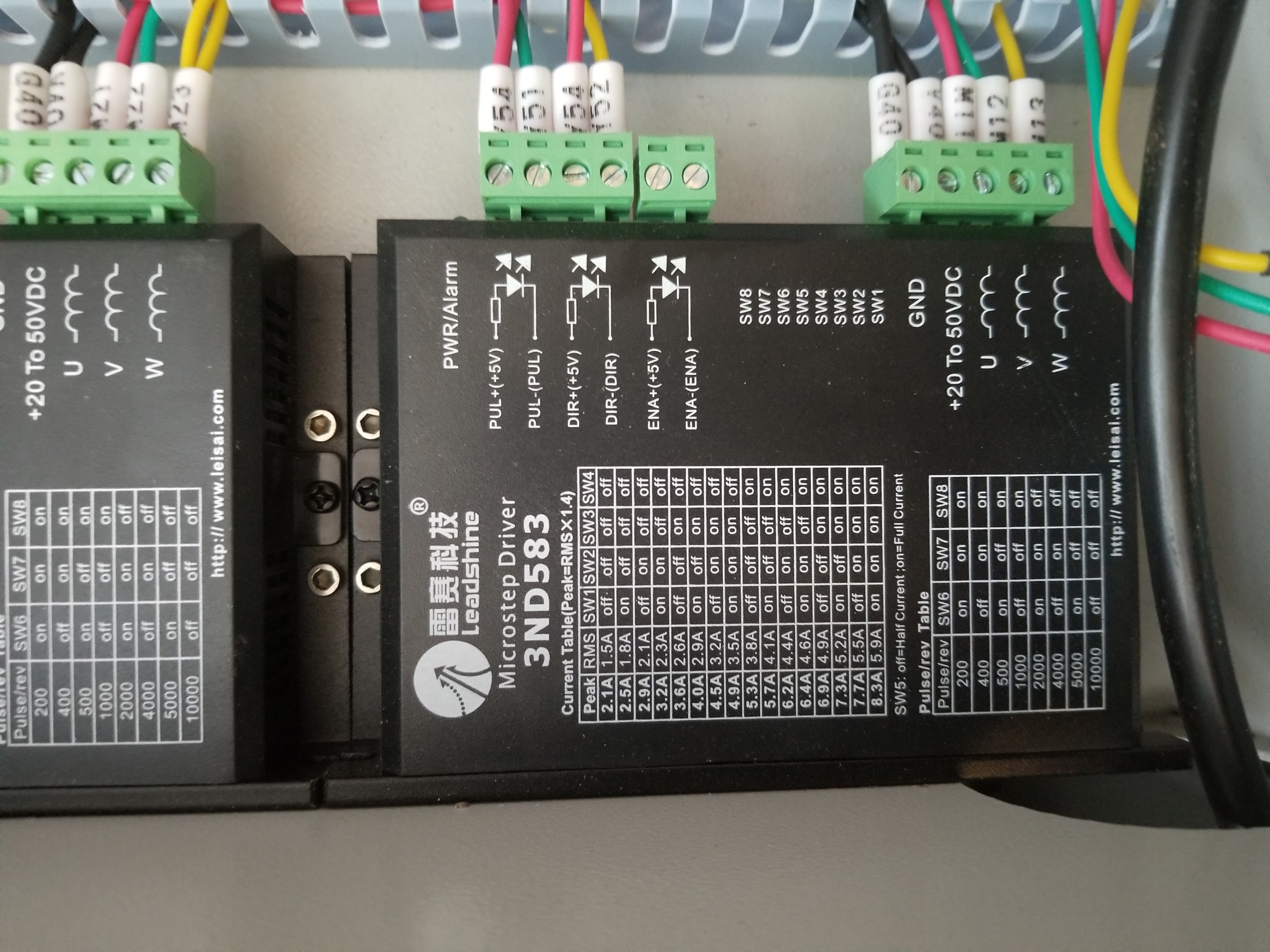

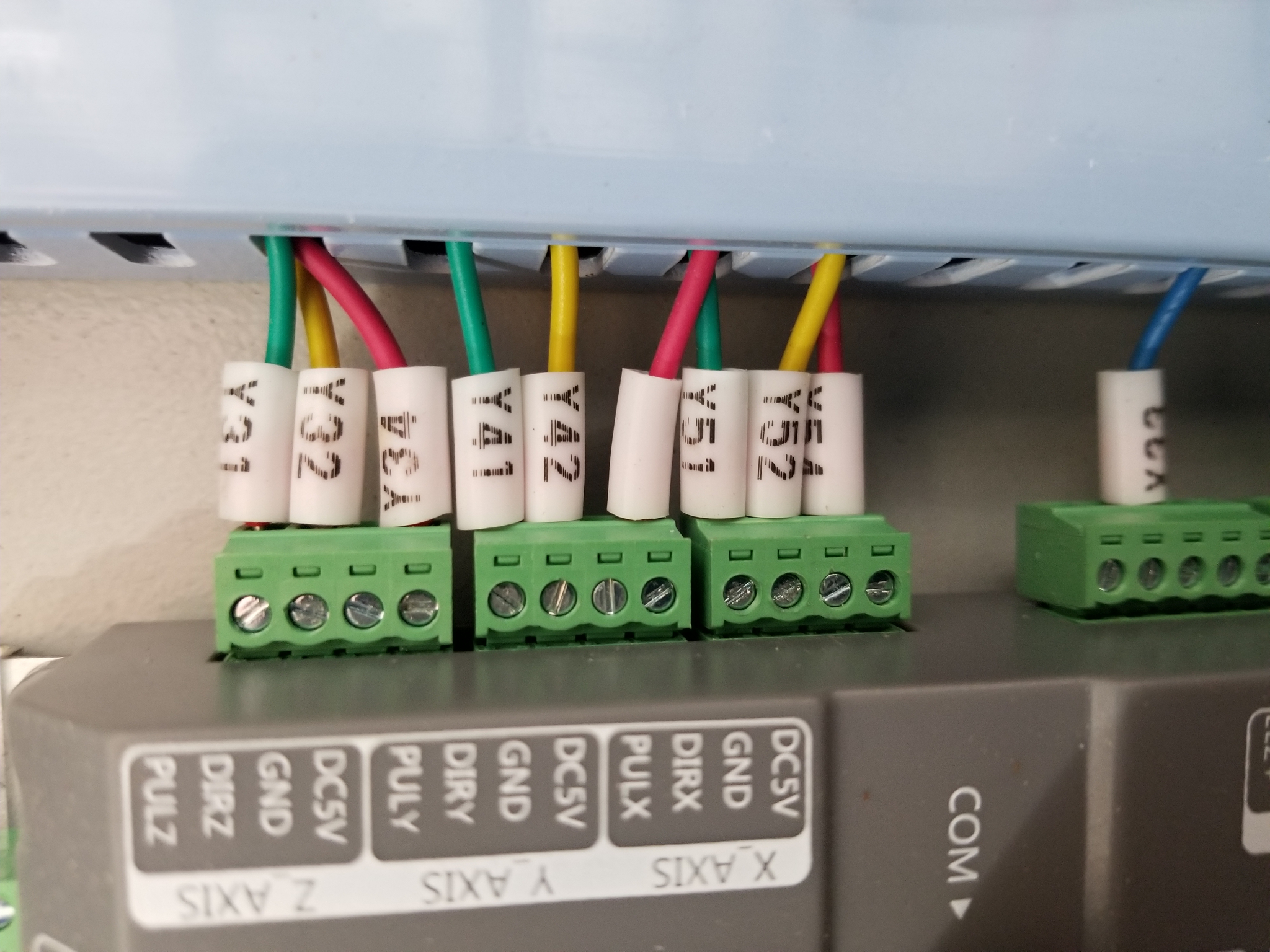

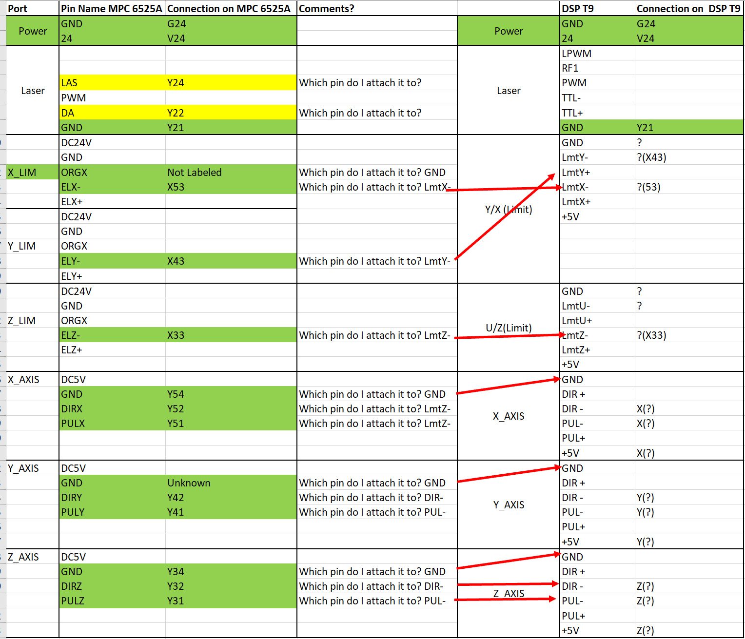

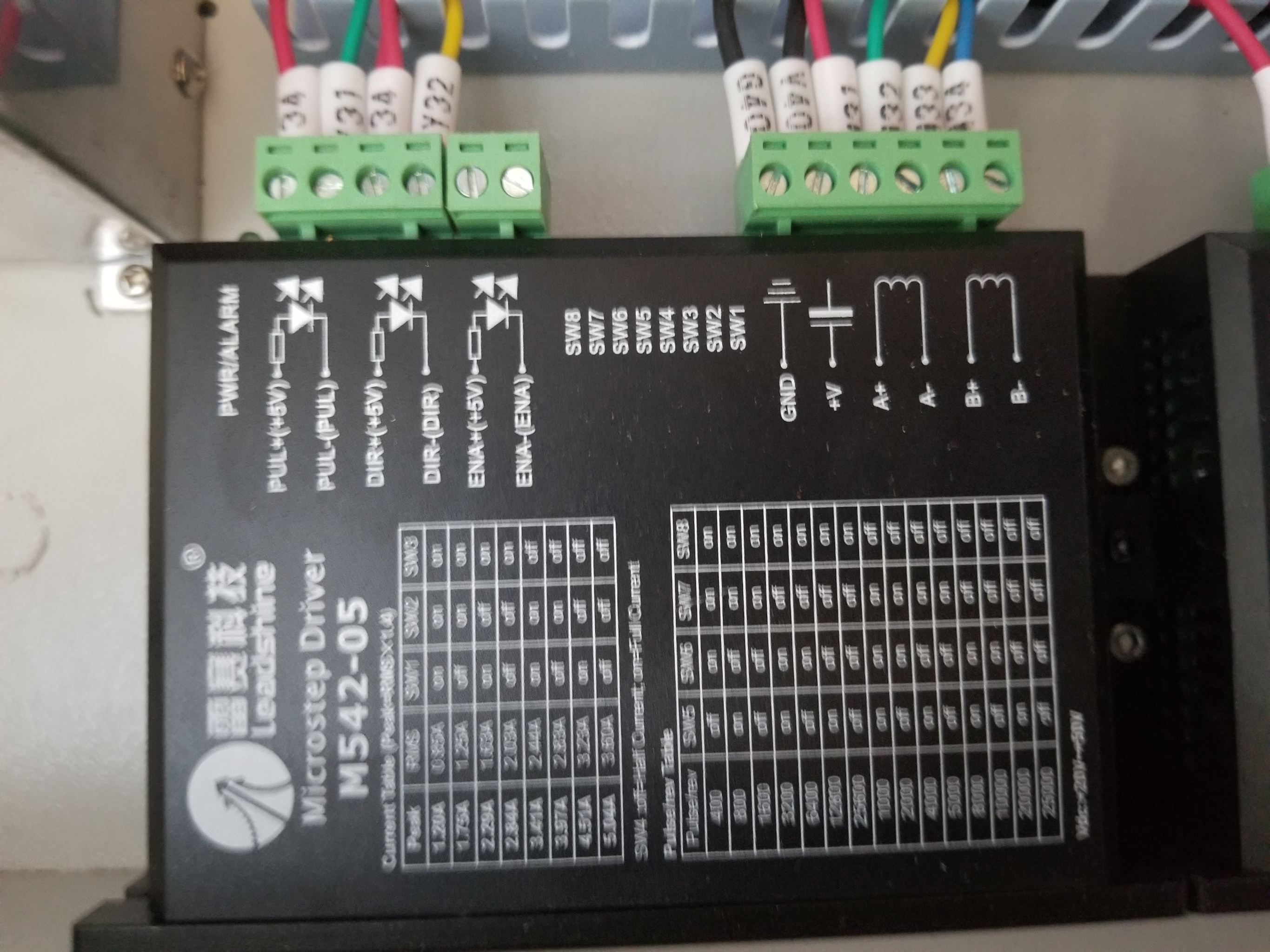

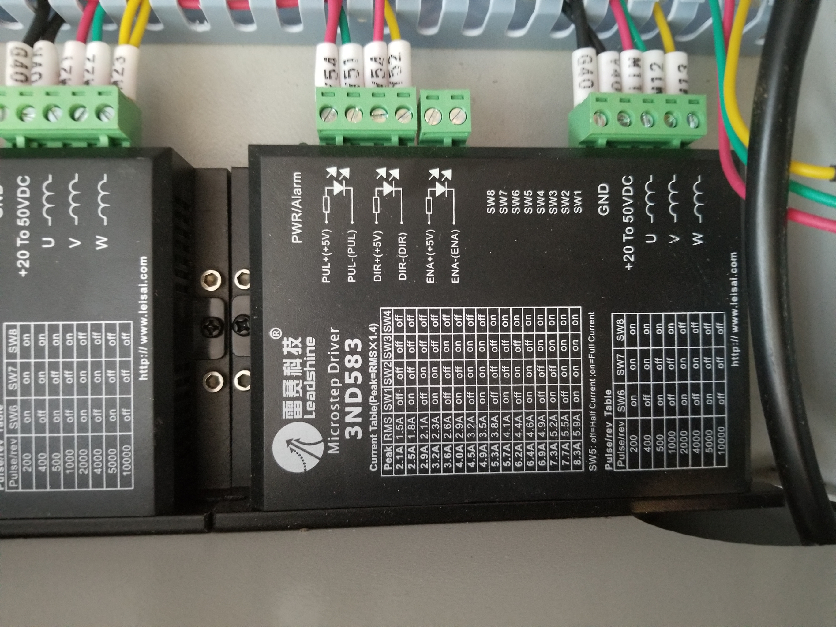

I'm about to replace my MPC 6525A with a T9. After looking at the current wiring and the T9 wiring schematic, I was wondering if anyone had done this already. As I documented all the pinouts and there are many pins which I have questions about. Attached are some pictures of the pinouts both the new and old controllers. If anyone can help, it would be great.

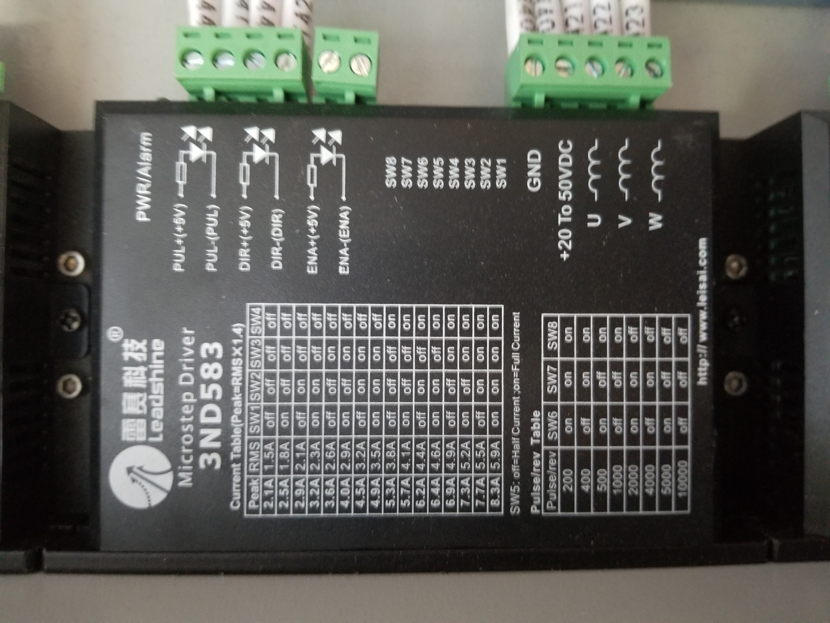

Some more pictures of my current controller:

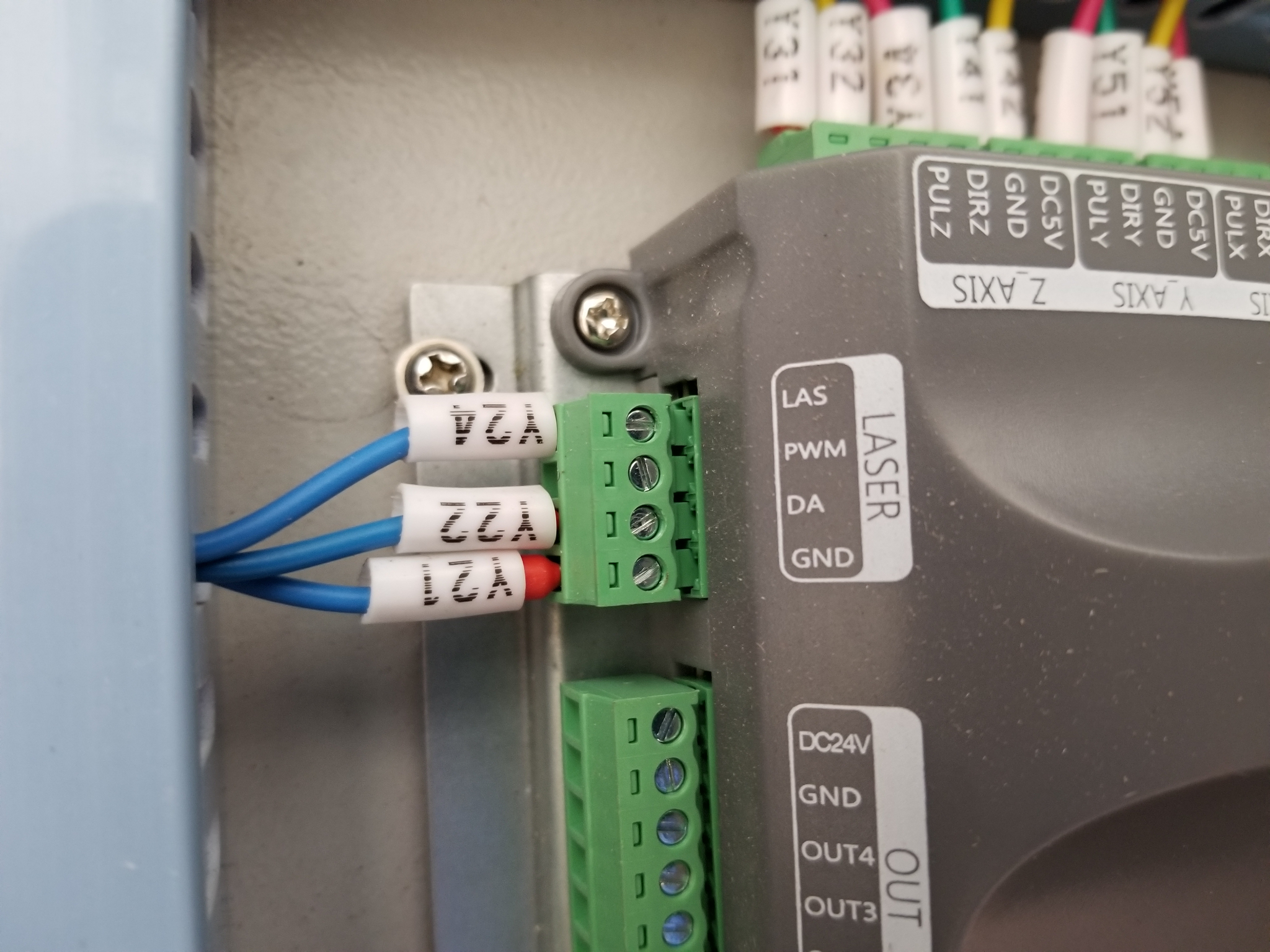

You can connect the +5Vdc from each motor-output (X,Y,Z....) to the + inputs of the drivers (+Dir, +Pul)
For the Laserpowersupply: Just take a multimeter (Select Ohm) to see which cable (they are all blue, as far as i can see) is connected to the lasersupply TTL- etc..
I advise to shortcircuit the WP on the laserpowersupply to GND and connect the Flowsensor (waterprotect) to the controller, between the WP and GND.
