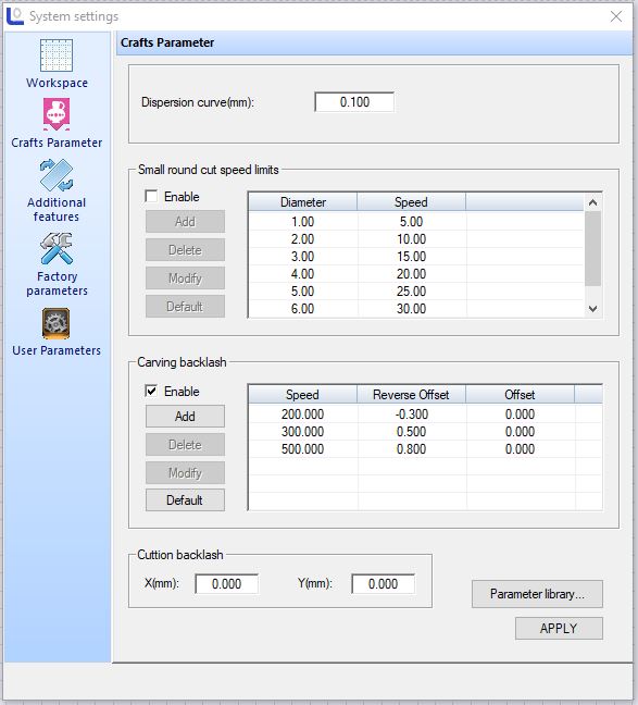

What does Dispersion Curve mean?? I cant find any info in the manual...Thanks

When cutting a circle, you are actually cutting a bunch of straight lines that form the circle. The number here is the length of each "line". The smaller of the number, the more smooth of the circle. But it will slow down the cutting if you set this number too small. 0.1 sounds a good number to be used in general

Thanks, Marco! That clears it up perfectly.
