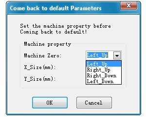

1) Mirror X
(this one could be easy fix. There is a setting that allow you to set either Left homing or Right home. What is yours homing by default? Top Right corner or Top Left corner?
They made two version, one for each. I just uploaded one and I forgot which one I did. But, there is a setting where you can manually set that up

One tech said, the offset issue is most likely caused by the poor connection or wrong connection between the driver and the main board. Do you know which configuration are you using? There are so many different way for connection. Common +, Common -, Differential, and.... u better to send your connection diagram for review. Also, look at the manual, there is four different connections and it's quite standard for connecting a stepping motor driver to the main board and to the motor. It's brand dependence. Different brand driver use different setup on connection.
I've attached a screen shoot of the Top Right and Top Left menu bar for you to review.
You use it to define the HOME when parking.

Re: PHCad not processing a file.
Posted: Sun Dec 12, 2010 5:14 am
by baccus61
Hi Marco.
I set my limits up again and fixed the mirroring problem. It was out all over the place and this is what I had to do.
OPTIONS- DEFAULT - Left up.
OPTIONS - SYSTEM SETTINGS - WORK SPACE- Machine Zero - left up.
PAGE ZERO - Left down
OPTIONS - POSITION RELATIVE - Left down
LIMITS set to HIGH
Swap X+, X- limit wires around on DSP board
Swap A+,A-, motor wires around to change direction.
Phew!!!!! :D
I can now engrave the job as it looks on the page.
