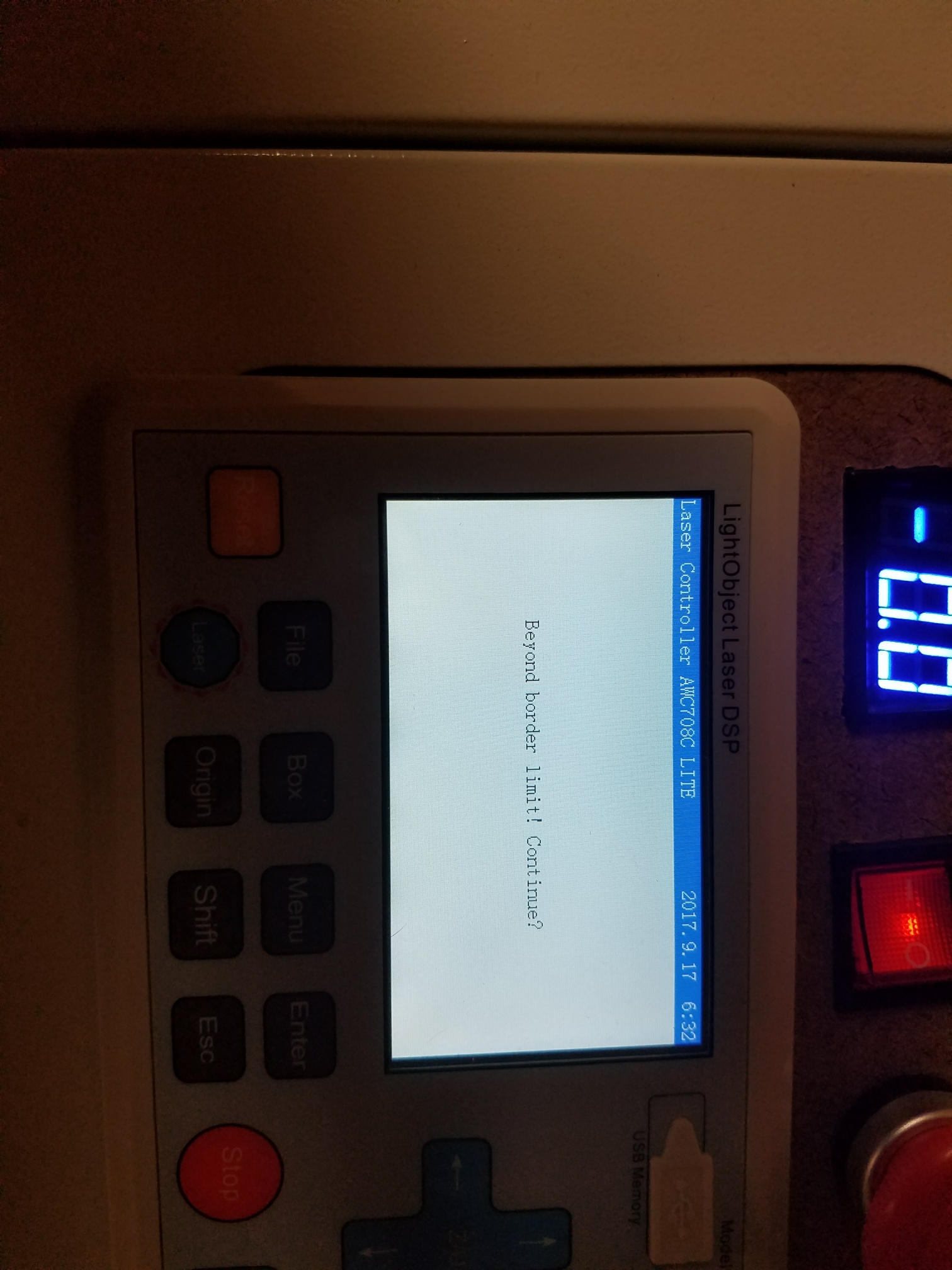

after upgrading my old co2 laser to the current dsp and software, when i try to run the demo donald duck image, i get the 'beyond border limit' on my dsp, what would be the problem? can anyone help?
and when i test engrave it always moves to the bottom right to start engraving....

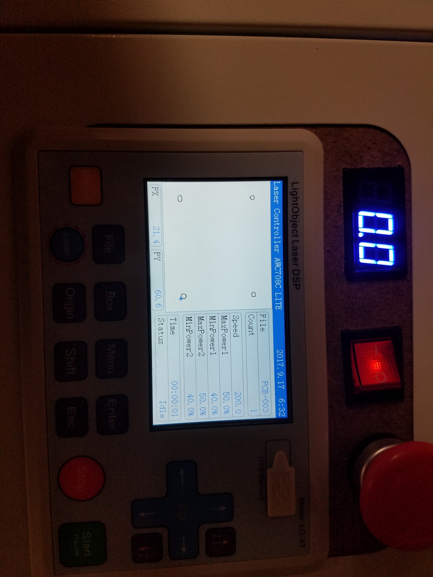

If I have a drawing in RayCam 0,0 is the upper left corner (Edit I had lower right, that's what it had been but it change at some point, probably when I change origins.) . It doesn't seem to matter where I place the drawing it always wants to draw in the same place. This is the case even for drawings that work.
How do I set the Origin relative to RayCam?
I know how to set the origin if I move the gantry to a specific X, Y. But that doesn't seem to do anything either.

Mcaughey
- Posts: 28
- Joined: Sun Aug 27, 2017 7:46 pm
Re: RAYCAM V12 and LO-x7 question
In response ot the FAQ

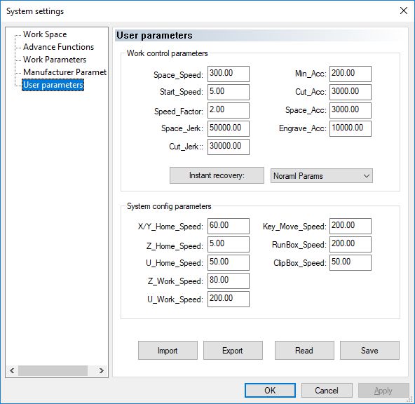

Acceleration = X - 10000 Y - 3000

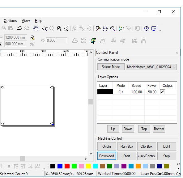

I set the object all over the page. The BMP just will not draw, the outline with BMP removed draws the right half of the board in exaactly the same place no matter where I anchor it in RayCam. I am downloading it to the DSP after every modification.
I have tried various speeds from 200 mm/s down to 5 mm/s. If this is too fast we have another problem.

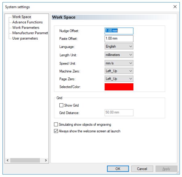

Machine zero and page zero are both Left Top which is where the Limit switches are.
Base Position is Top left.

Why don't you start a new file and draw a small circle on each corner to test it.
I really have no idea how you setup your machine or setting the location of the laser head.
I am guessing that you have setup issue somewhere.

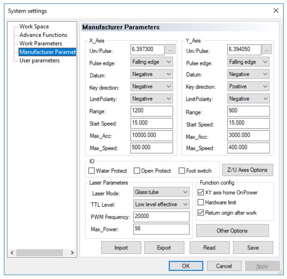

Post screen shot of your parameters as posting acceleration alone doesn't help much

Let me know if there are any other screen shots you need.
I got the limit error again, then it printed 1/4 circle in upper left corner.
Pay attention your Range!
Why you set 1200 for X and 900for Y??
Aren't you working on a k40 with 300x200 range?
