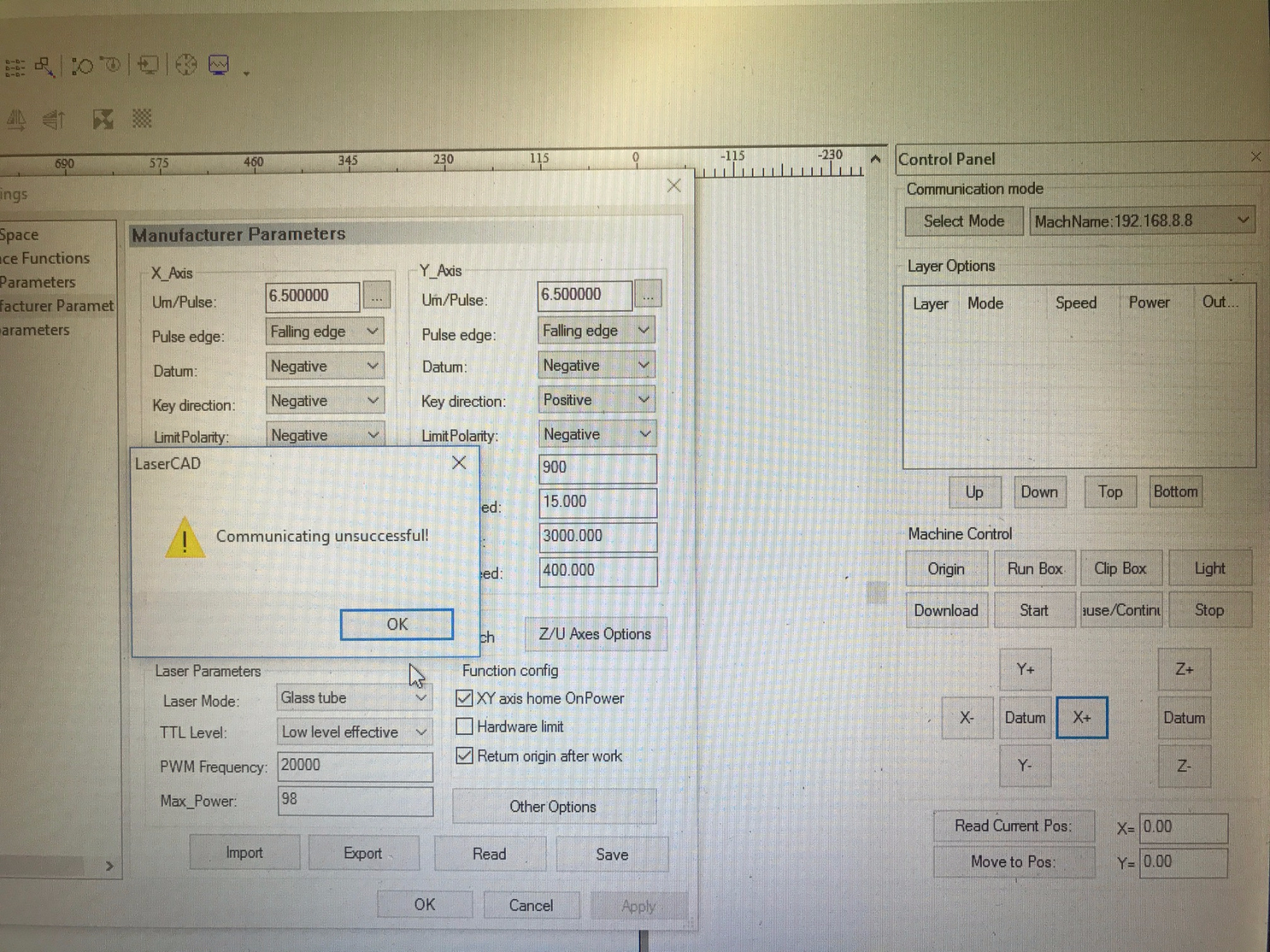

I purchased an X7 DSP and my computer (Windows 10) is able to see the DSP when it's plugged in and powered on. Furthermore the version of LaserCad prior to the latest as of 10/6/16 is able to auto detect it in dialog where you select the port. I'm unable to move the gantry using the buttons nor am I able to read the manufacturer settings. Furthermore, I've tried a various permutation of "run as admin", "windows 7, 8 compatibility" mode, all of which is to no avail.
Thinking that perhaps it's a firmware issue, I attempted to update the DSP's firmware to X7-160822L1.UG5 by formatting a usb drive to fat32, and the DSP is able to locate it. However, when I select upgrade, it fails immediately. A post on the forum suggests that if you're already on the latest firmware then it will not upgrade successfully. In the system menu, it shows 1.16.9.1.
I've also tried the included USB whip dongle that plugs into the side of the DSP, as well as the USB port that's built into the DSP. Both behaves the same way in that my system will see the port, but LaserCAD is "unable to communicate".

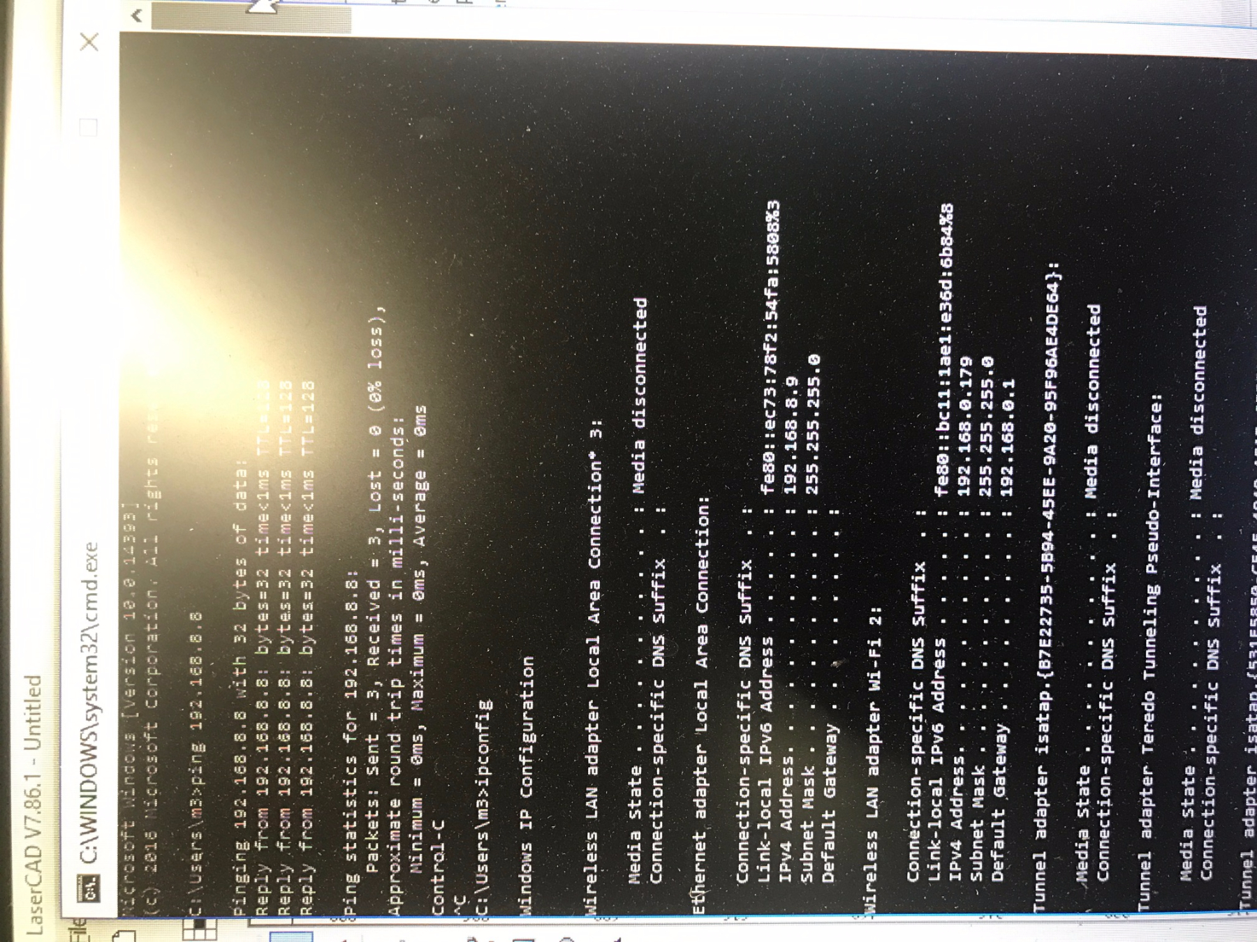

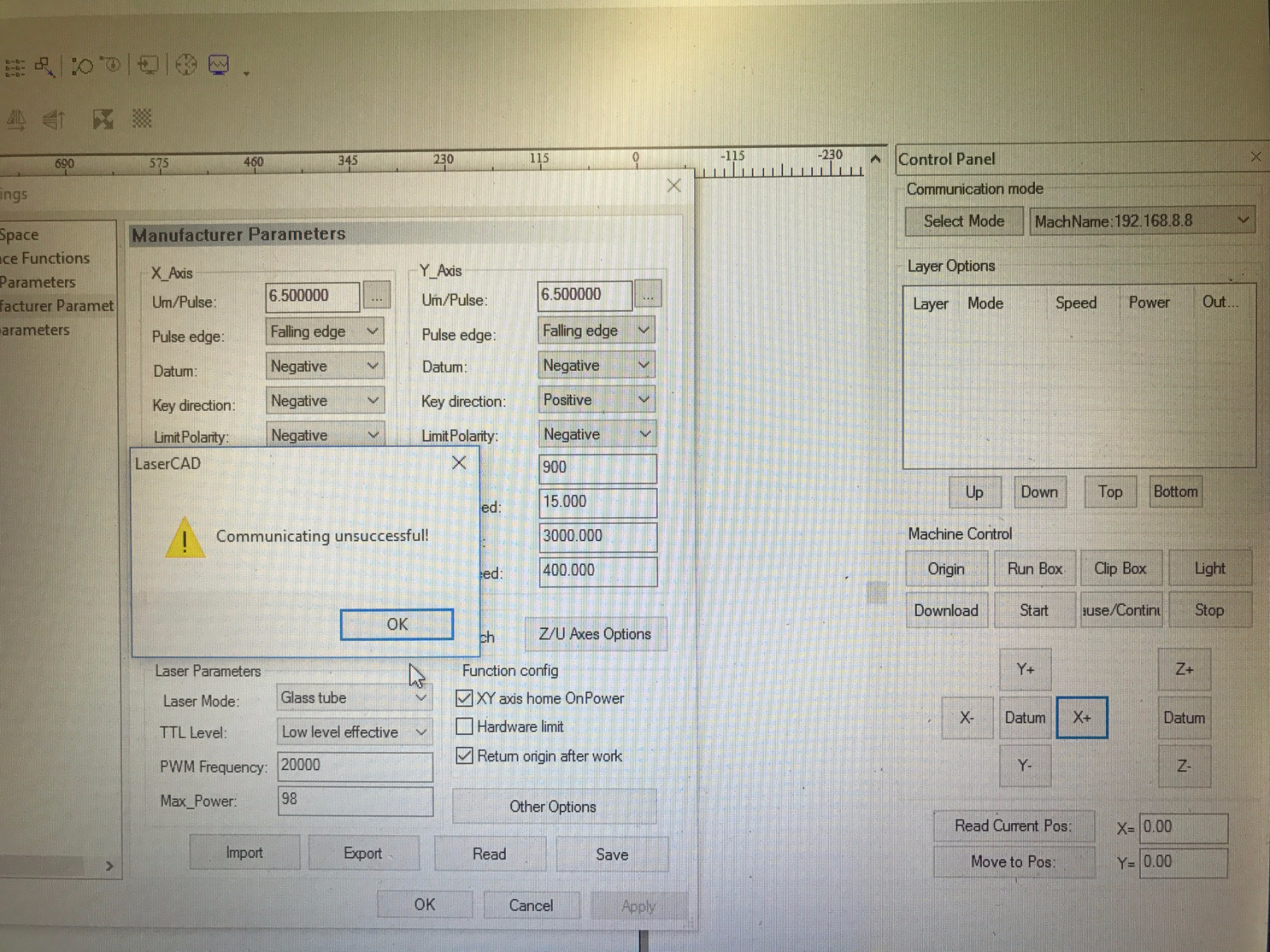

Trying it over ethernet did not help. My host was immediately able to ping the DSP at 192.168.8.8 but alas, communication with LaserCAD was not successful.
Anyone know if this is the latest version as of 10/7/16?

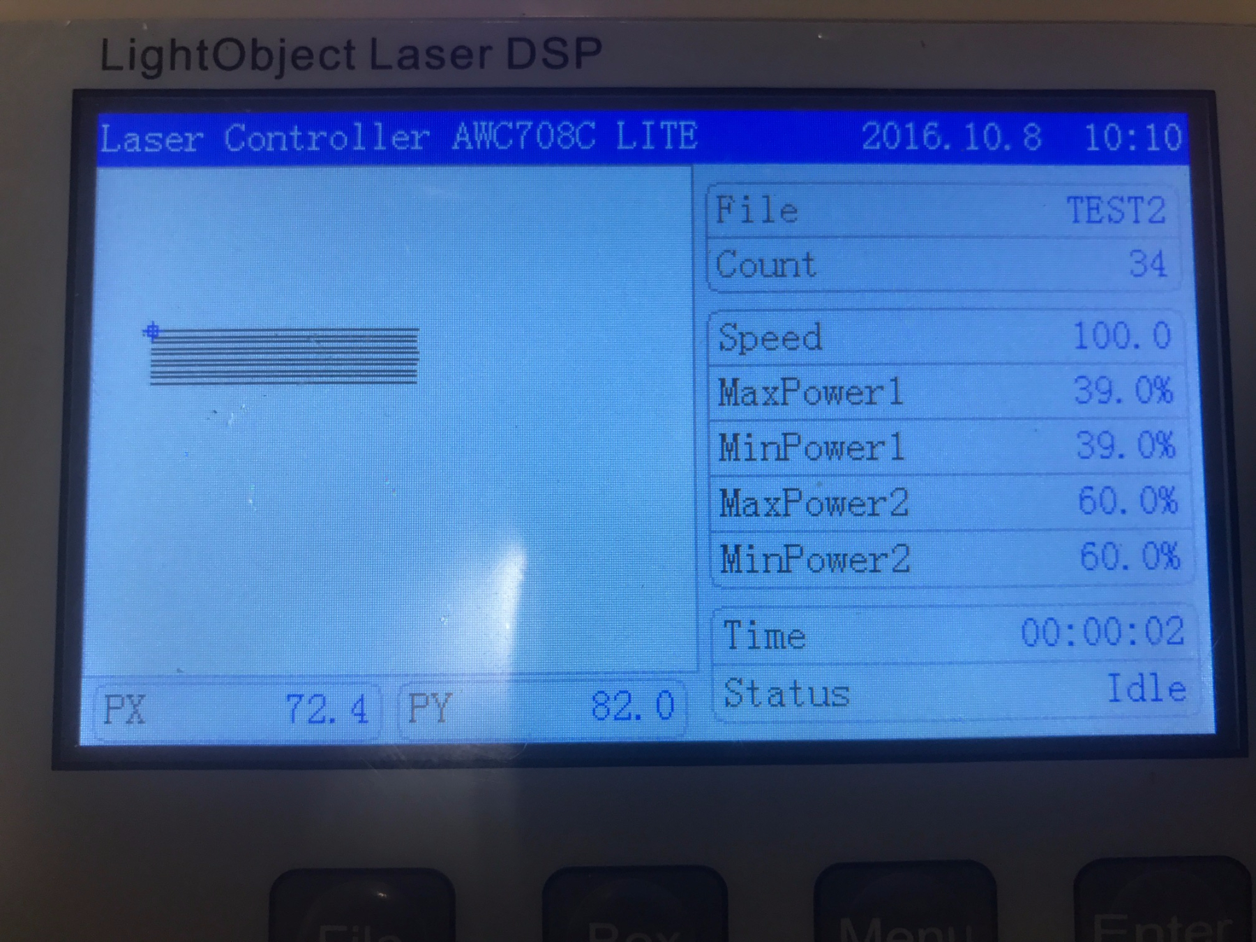

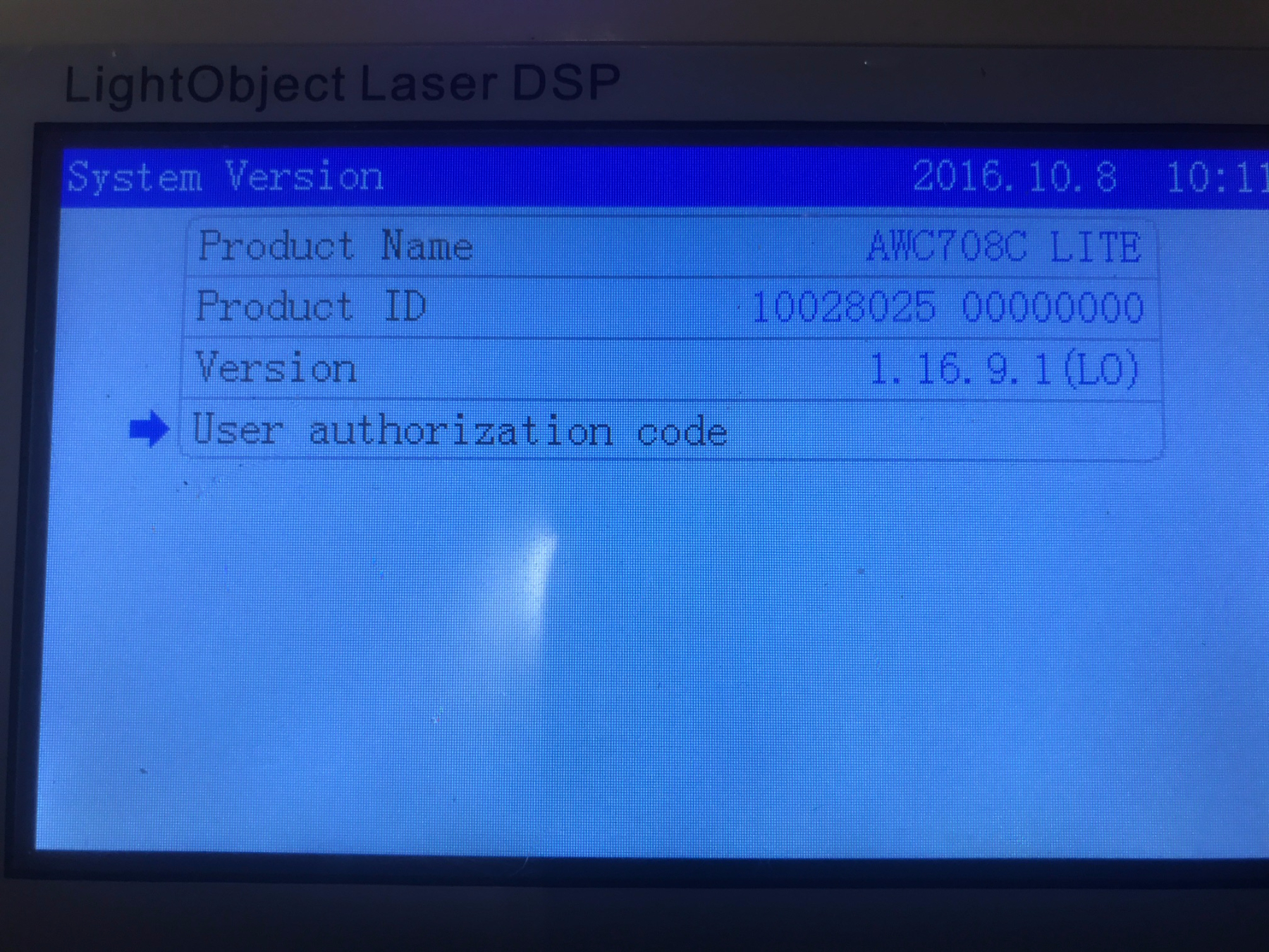

Also... my DSP displays itself as the "LITE" version... is that supposed to be right? Same message, USB or Ethernet host has correct ip and subnet and DSP pings
Re: LaserCAD unable to communicate with X7 DSP
It is a software issue. I will send you a link for the new software.
