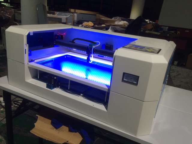

Re: E5 and Z axis for Buildlog.net 2.x laser
How did you find the um value for the Z?
I found the um for Z by making measurements of traveling distance and use the software UM calculator to get the um. Not sure how did you end up 10x more on traveling distance.
We will launch a small laser machine: PRO530 by the end of September. It is 500x300 working area and the Z distance is 150mm. We are using E5 to drive it.
