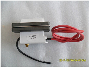

I attached a picture of the component I replaced. Since it is completely sealed I can't look inside. I was wondering what is the purpose of the metal u-shaped thing on the black part of the flyback

The metal U-shape is to keep the two feroxcube parts together tight. It looks one piece but it will most probably be two u-shapes pressed in the highvoltage-transformer.
