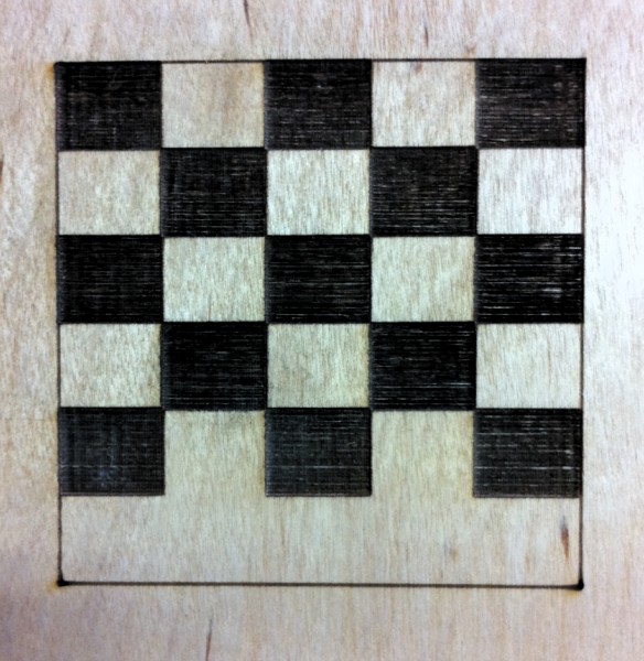

Every time I try to engrave a raster image it comes out short (squished, distorted). The width of the engraving is fine, but the height is always short. I can make it a little better by increasing the scan interval, but it reduces the quality of the engraving when i do. Vector images come out perfect so I don't think it's a problem with step length. Any ideas?

Sure! Here is an example using a checker board pattern.
The border was done by "Frame Cut". The width of the pattern is correct, but the height is short.

Try reducing your Y acceleration speed.
It is likely that the y drive is not keeping up (mechanically) with the steps. I have had the same issue in the past.
The reason it does not show up on vectors is that the vectors are made up of hundreds or thousands of steps. Loosing a single step while coming us to speed is not noticeable on a vector, but loosing a single step on a single step instructions means the head did not even move. So if that happens 20% of the time, your image will be about 20% short by the time you get to the end of the scan.
Reducing your Y acceleration will slow the entire processing time, but not to any great amount. And since we are only reducing acceleration speed, it won't have much affect on vector movements, either. Most of the time of a scan is spent doing X movement, so that is the one that needs to be optimized.

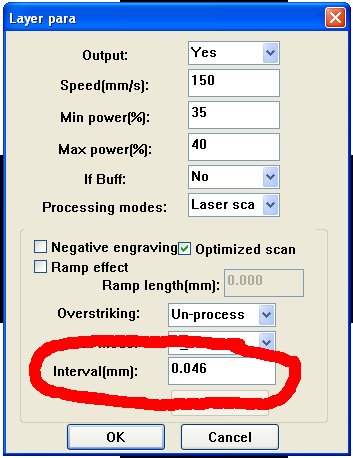

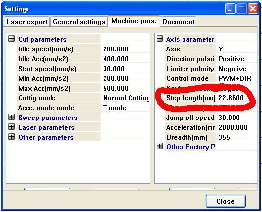

Here's a better explanation (I hope :lol: ) of what I did to correct my problem.
First, in my machine config on the Y axis I have a Step Distance on 22.86um. This is the distance that the axis moves for each step of the motor. It's very important that this number is correct and since my machine is home made my number is probably different than yours. Make sure you have the right number for your machine.
To fix my problem I had to make sure that the "Interval" setting for each layer was an even multiple of my Step Distance. With my Step Distance of 22.86um (that's about 0.023mm) an Interval value of 0.046mm works well. 0.092 works pretty good too. Values that don't evenly divide by 0.023mm cause the image to distort along the Y axis.
