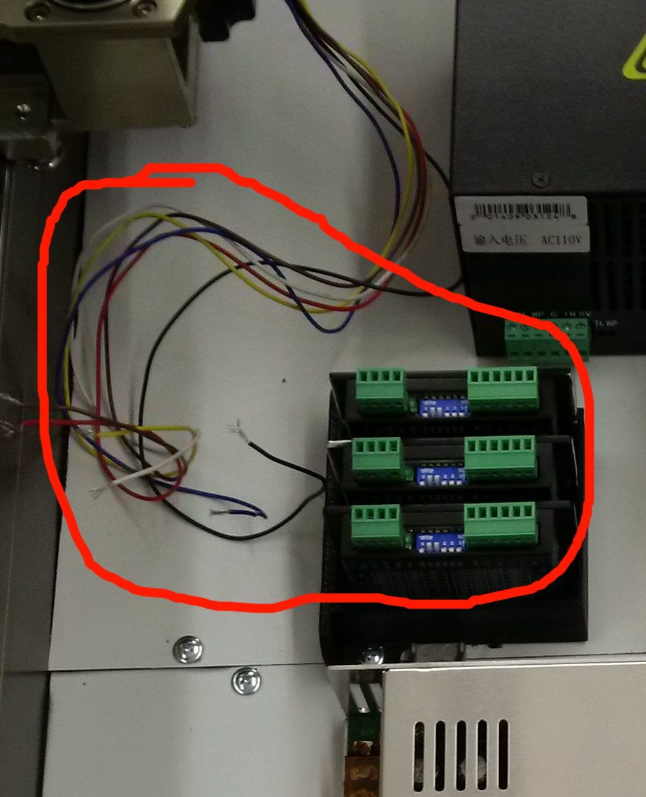

Can anyone tell me which of the 6 wires on the motors goes to the stepper driver?? Which are pairs? Do ALL 6 wires get used?

It seem to me that you have a 2 phase driver? Can you provide the stepper driver model number and the motor model number?

I will get that info. But I suspect I don't have the right drivers for the motors that I have. They are the micro drivers..

Seen from the picture, your wires are colored: Red, White, Blue, Green, Yellow and Black
As this motor has 6 wires, i suspect that this an unipolar motor, but you could connect that to a Bipolar driver.
This unipolar motor has 2 coils with a connection to the middle. You should ommit this middel connection.
The colors that are important are:
Red = A Blue = /A Green = B Black = /B
So the wires White and Yellow can he isolated.
BUT: first measure if the coils are between Red and Blue / Green and Black with an Ohm-meter... Just to be sure that this motors have the wires conected as they should have
