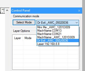

You are getting a communication problem because you have to select the correct laser. My large laser is Dr Evil, my small one is mini me
selection 2.jpg (30.72 KiB) Viewed 3900 times

No, this is not a problem. I always select correct laser in communication mode.
Strange is that I can move axis from software, but cannot download file to laser.
