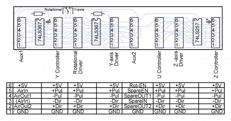

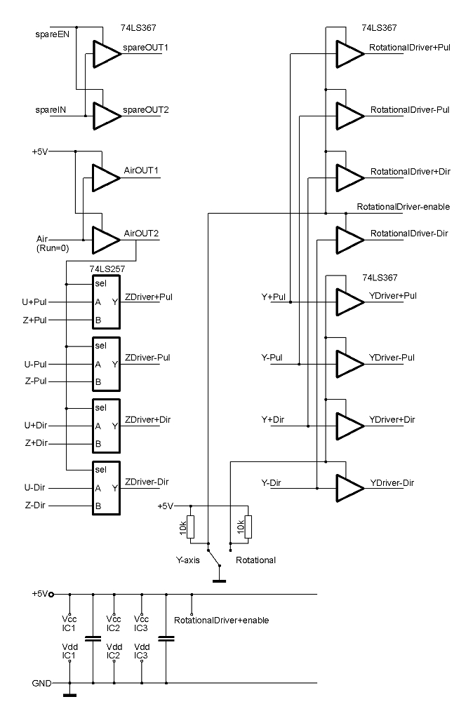

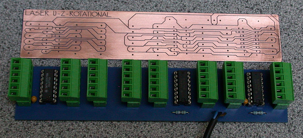

Maybe of any interest: i have a fourth stepperdriver which is normaly in disabled so i can dis/connect my rotary while the machine is on. With a switch near that connector, i enable that drive, make the Y-drive doesn't receive pulses anymore (dir/step) and make a led on the front turn from blue to red..
the advantage of keeping the Y-drive alive is that the bridge is hold into place because the motor is still powered.
I used a small piece of TTL-Logic to do that all for me. It also switches the Z to U while the job is running so i can raise the table in steps when i want to do a multi-pass..
