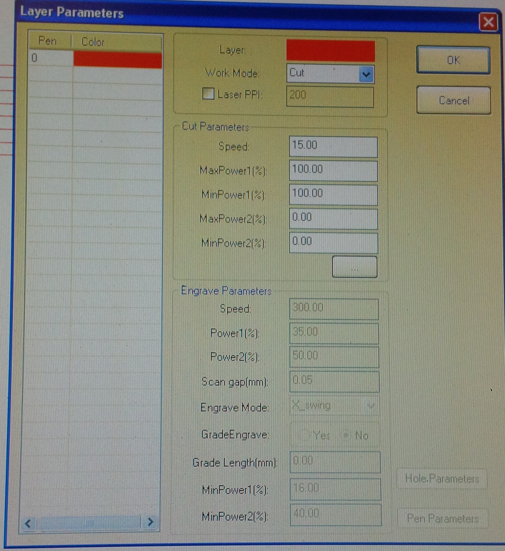

Max power is set by manufacturers max power setting. It is set at 85% which gives me 24mA.

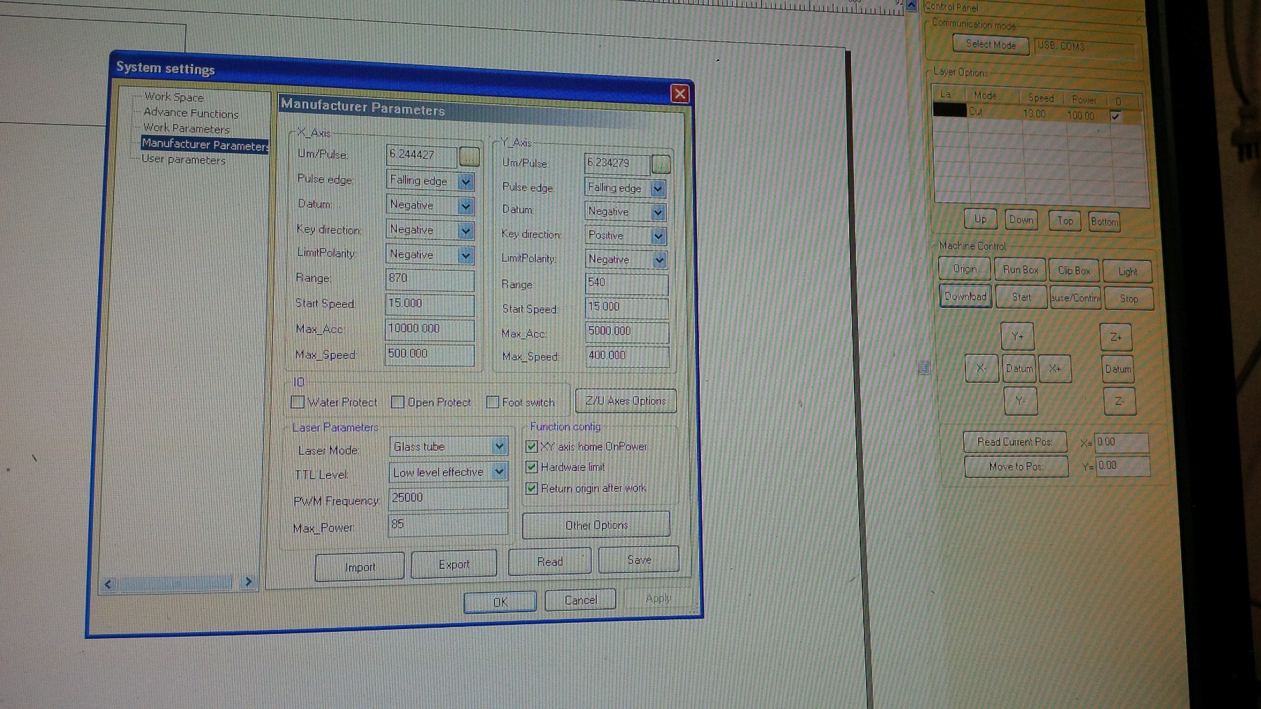

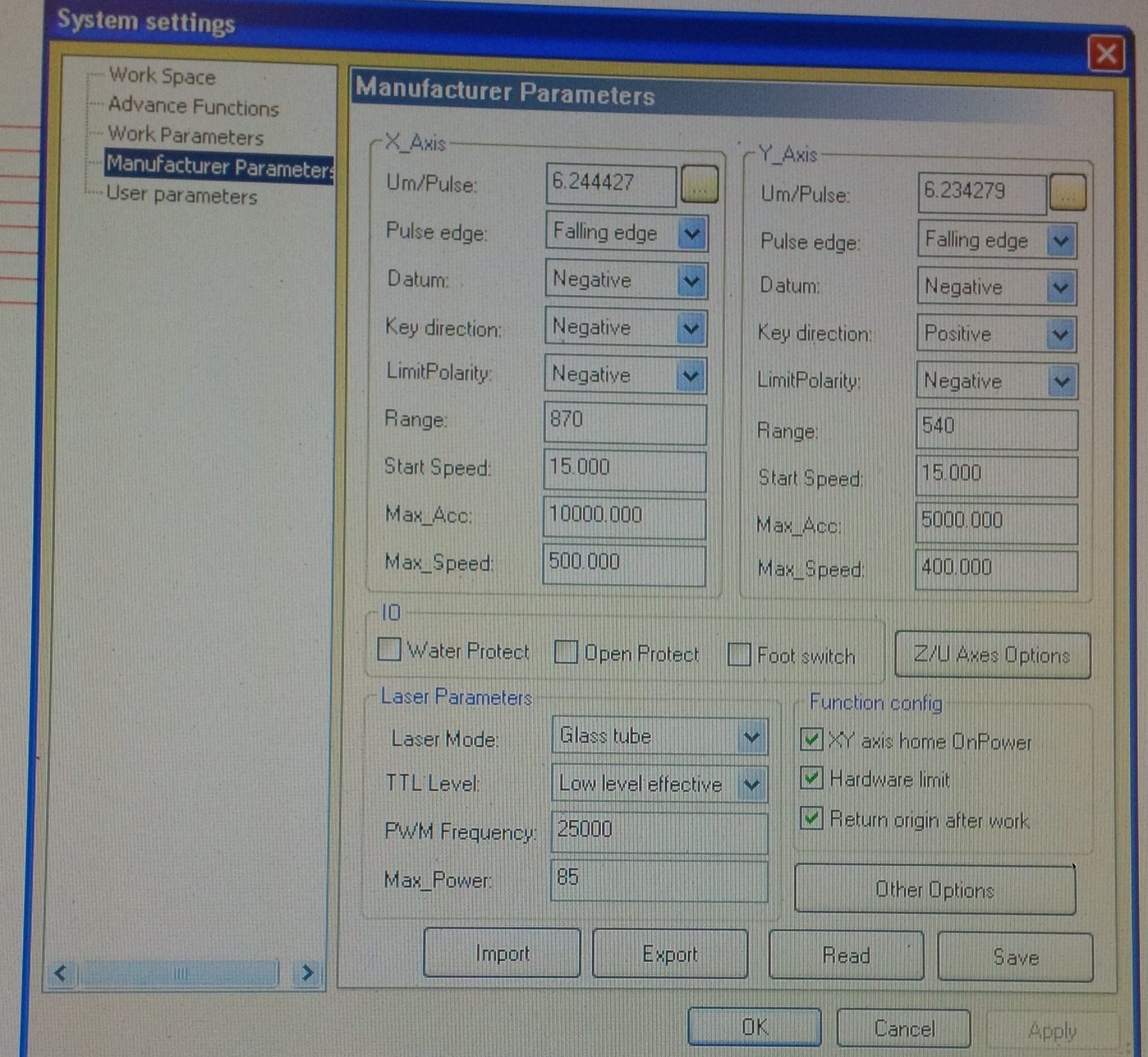

Can you send a screenshot of the 'manufacturer settings' in lasercad? And what wiring schema did you choose (especially between the DSP and laser PSU) ?
Most chinese PSU's implement an RC circuit off the 'IN' pin.
Can you hook up a pot for power control and a switch to test the laser power outside the DSP? Ideally immediately after the power has dropped to a noticeable level?
While unlikely, It *is* possible for it to be the fault of the DSP (specifically the cable between the screen and the distribution board).
There is one relatively easy way to test if its the DSP or not that I can recommend if you have a multimeter and can get a hold of a 47 ohm resistor and 1 uF (microfarad) capacitor. (I'm assuming you don't have a scope)
If you measure the voltage between PWM and ground when the laser is firing 'perfectly' and after the power level has dropped though the following circuit, then the voltage SHOULD stay constant.
If the voltage sags, the DSP is the problem. If the voltage does not sag, its on the PSU/laser end.
I would run this test twice, once with green phoenix connector UNPLUGGED from the laser, and once with it plugged in (so the laser is firing while cutting). This is to eliminate any weird current draw from the PSU affecting the result.

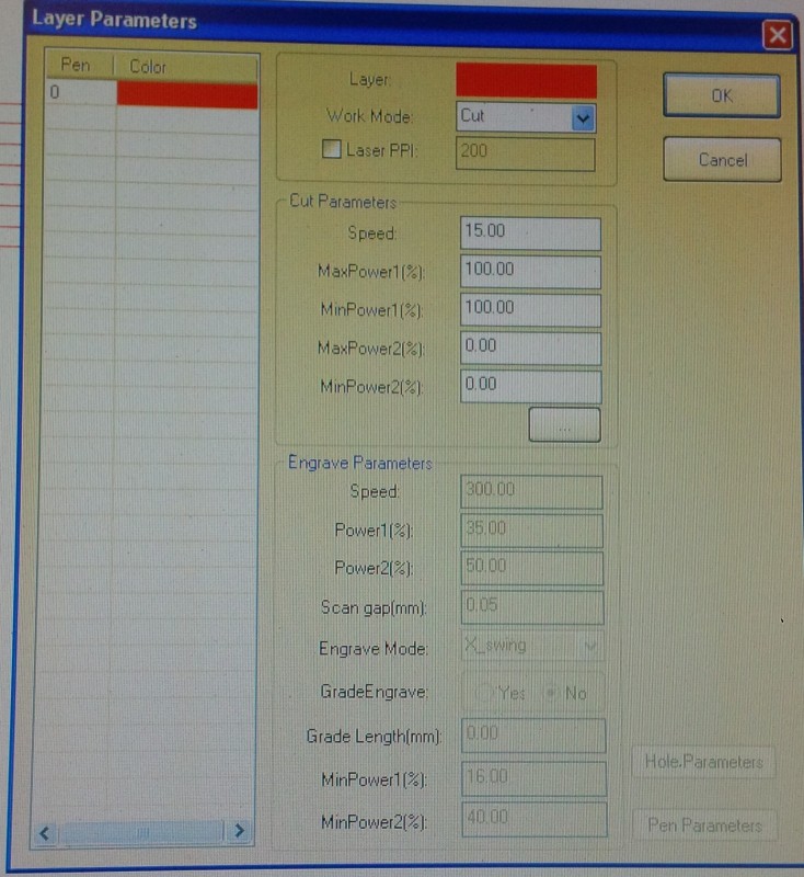

manufacturers params as per pic layer params Wiring is as per the downloadable file on this forum but with the wp connected to g as per your pic. Used cat 5 cabling from dsp to psu.
After installing the resistor and capacitor I got a reading of 4.06v connected and 4.07v disconnected. The machine cuts better with these mods.

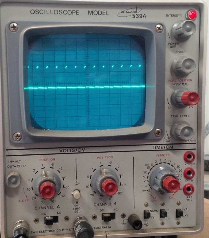

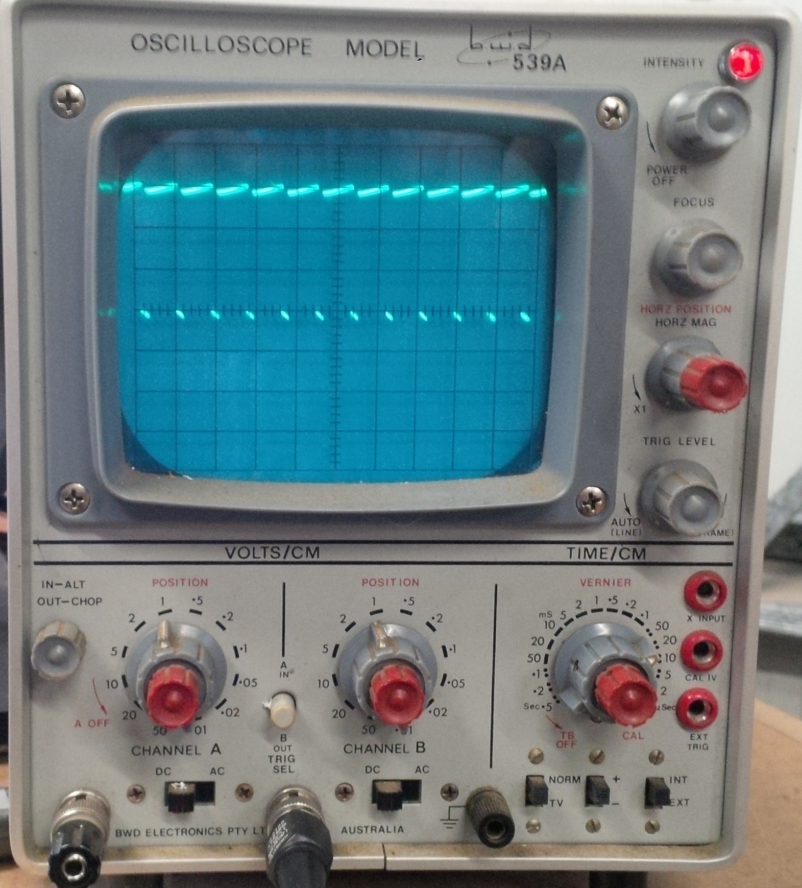

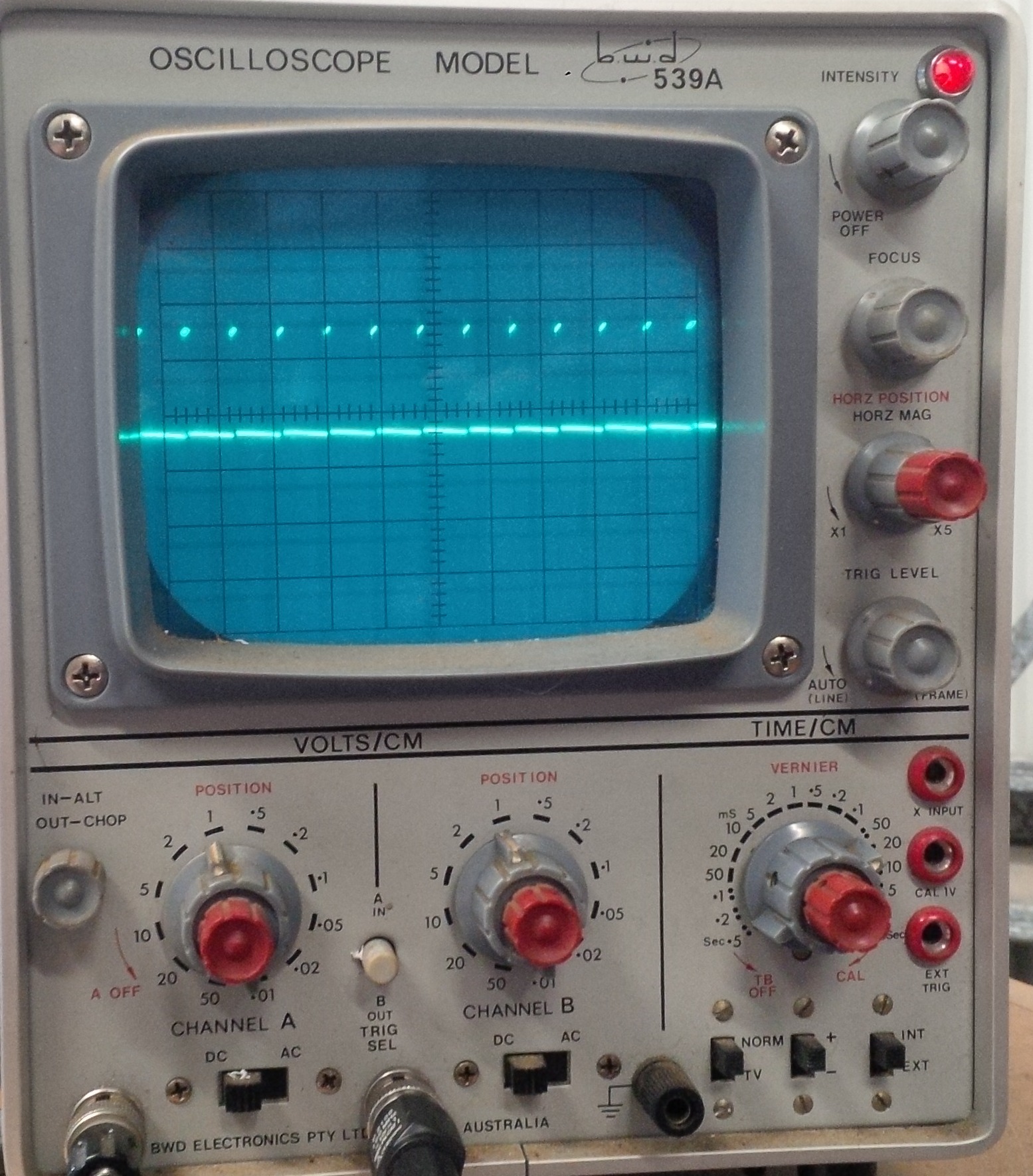

A friend brought a scope round and we connected it up took some photos
At layer 100% manufac 85% at layer 10% manufac 85% Thanks again
Mal.
Mal.
yaddatrance
- Posts: 27
- Joined: Wed Feb 29, 2012 4:18 pm
Re: co2 laser losing power
Perfect...
Now with the RC circuit in (the setup with the resistor/cap and multimeter)... Run a job until the power 'sags' and then run the same test and measure the voltage...
If the voltage is significantly lower, then the problem is on the DSP side, if the voltage is roughly the same then the problem is on the PSU/laser side.
One thing I noted that was slightly odd was between the oscilloscope readings at 100% vs 10% (of 85%), the rail voltage seemed to drop almost 2 volts? The 100% reading impies a 6V rail and the 10% a bit over 4V? Normally both would be at ~5V ish, but it could be easily be due to the age of the scope.
