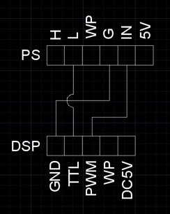

I have the X7 DSP hooked up to my laser and have it working good with the stepper motors but need info on hooking it to my laser power supply. I have looked at the 608 manual but it is not the same. Here are the connections on each. Both were purchased from Marco.
BIll

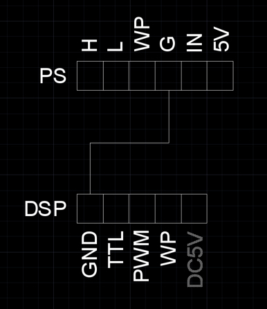

I will go with this and see what happens.

That worked. Also connect WP to G on laser PS.

I had to connect the WP to ground on BOTH the laser PSU and the LO-X7 to get it to fire.
