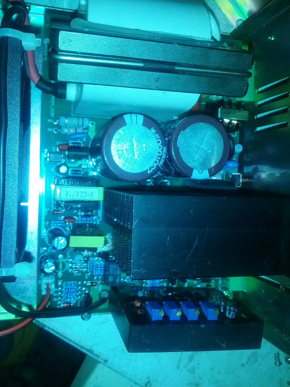

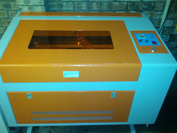

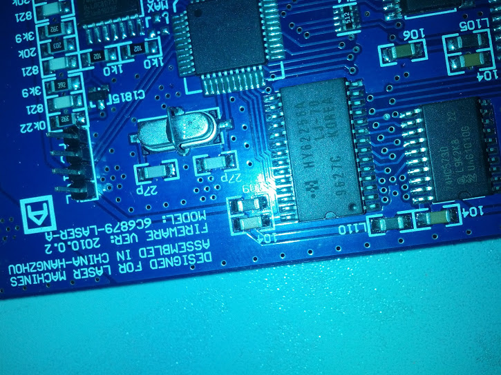

I have recently acquired a used second hand chinese 50W 6040 laser engraver with an orange and grey metal case. I know a lot of these are generic machines.
I am hoping that with some of your advice I can get it working again. It was sold as is "with a broken laser tube" apparently previous owner hadn't filled the laser tube with water.. Hmm.

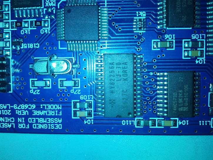

The machine appears to be a few years old and the USB driver board is a 6C6879-LASER-A firmware is 2010.0.2 with for Winseal XP etched on the board too.
I have a CD that came with it which has a title of :zhongpu with 2 directories and all chinese symbols/ files. Nothing in English unfortunately. No manuals or anything else.. including links to manufacturer etc.
The machine has an air pump, a water pump and very little else. The machine when powered up it's exhaust fan runs and the x and y axis travel to the top left hand corner and the red laser dot is on at this time. As the laser tube is apparently broken I have not turned on the laser power or test fired. My Z axis bed also motors up and down by a toggle switch selection inside the working area.
Can anyone assist with pointing me in the right direction for links to the correct instructions for operating this machine please.
I'm looking at replacing the tube but I'm unsure if the laser PSU is working or damaged.
Is this machines axis controlled directly from a PC plugged in? It's not a DSP as I don't see any LCD or directional controls or menus tc.
I want to upgrade to a DSP and perhaps this may be the time to do it.
I have 3 motor drivers from my old chinese 6040 cnc router wondering if I would need to change the existing stepper motors too.
Basically I want to get this machine up and running with something that is going to be easy to use and reliable.
Your advice would be really appreciated

I think you better to upgrade it to DSP. The card it came with your machine wasn't a good system to use. Plus, the power of this machine is 40W only, not 50W because it is using 830mm (or 850mm) laser tube. So, don't expect it can output more than 45W. If it does, then the tube won't last long!
In order to get this machine to work, you better get a upgrade for the K40 machine but with bigger motor drivers. If you already have drivers, then it is great and use it then. The motor of this machine should be running about 3A on X and 4A on Y. So, your motor drivers need to support up to 4A.

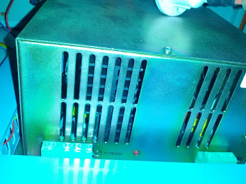

Thanks for your reply Marco

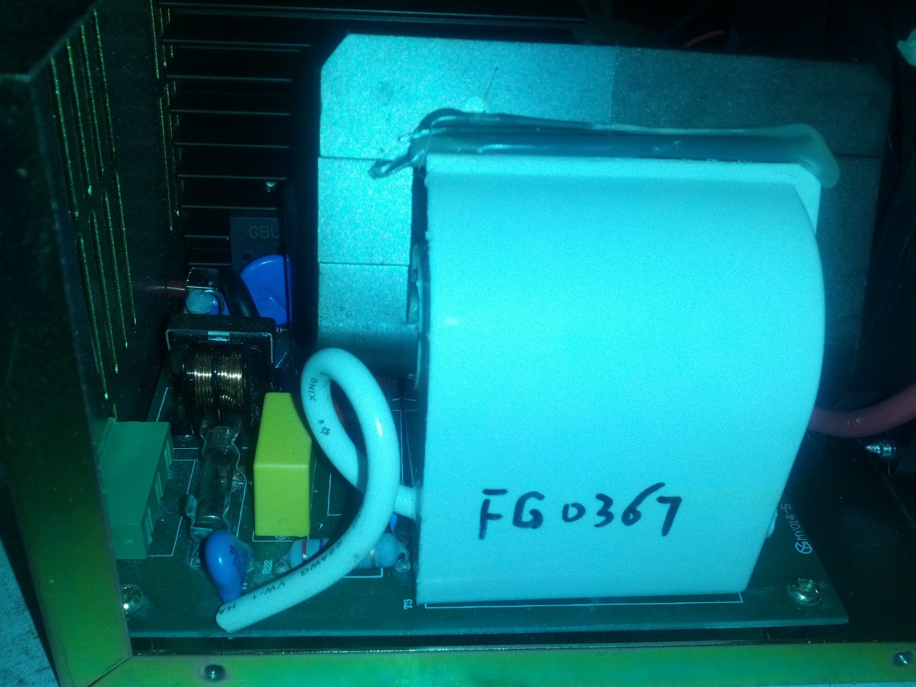

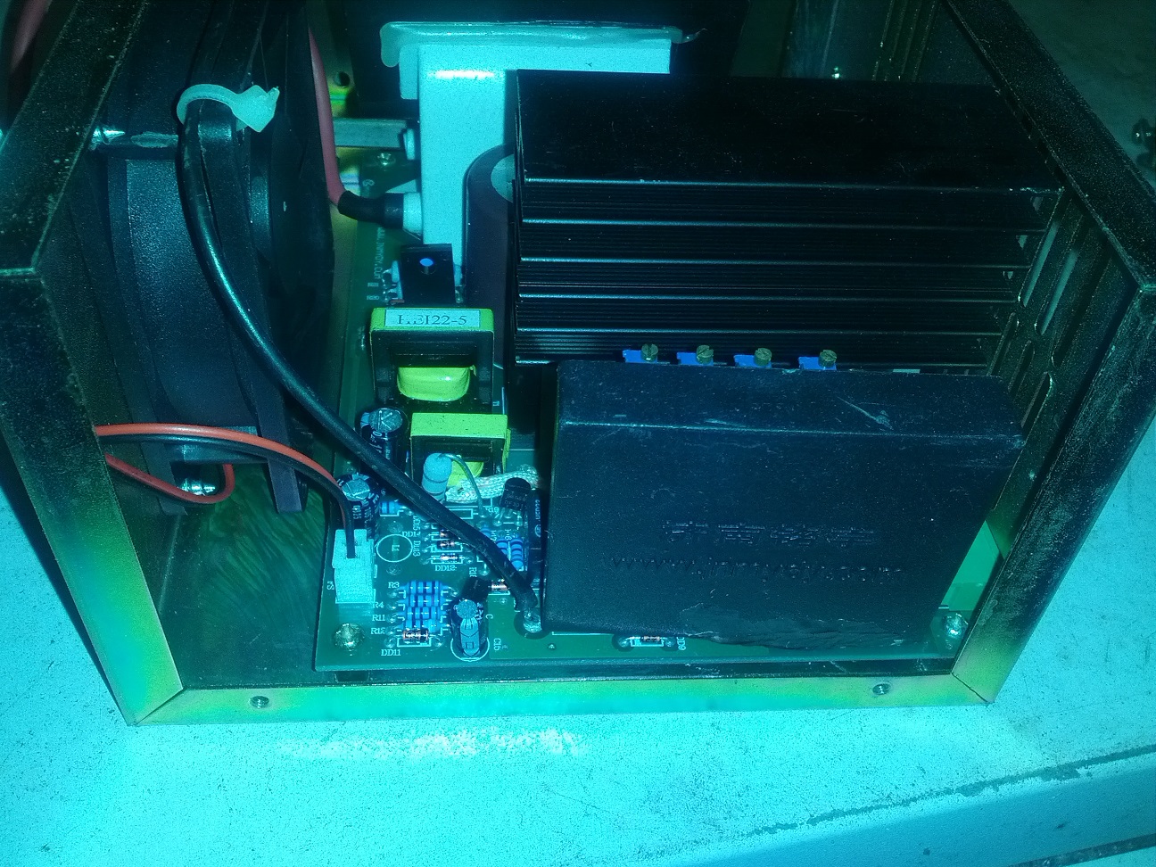

I have just received a dsp from you! I'm wiring it up now. I already have x2 stepper drivers to use M542-05 for the X and Y axis' I have tried to identify the actual motors fitted and all I can find is 17HW 4410N -03-AD- Z and 17HW3448N-15AD I have looked everywhere and cannot find any datasheets for these motors. So would appreciate any suggestions for settings on the stepper driver switch settings please.. Have attached a pic of the driver case.
Also I'm wiring up the laser power supply and would really appreciate a hand with working out which wires are connected. I've attached pics to see if my PSU supports PWM.
The 2 plugs on the laser psu are 6 and 3 pin. With the pin outs as
H L P G IN 5V AC AC FG
The Pin out for the AWC 608 is
1. DC 5V
2. Water Flow Alert
3. PWM
4.TTL
5.GND
I'm thinking that the L Should connect with TTL
Gnd to Gnd
and IN to PWM ?
Please could you let me know if you think this is correct? or is there a link to somewhere with this data?

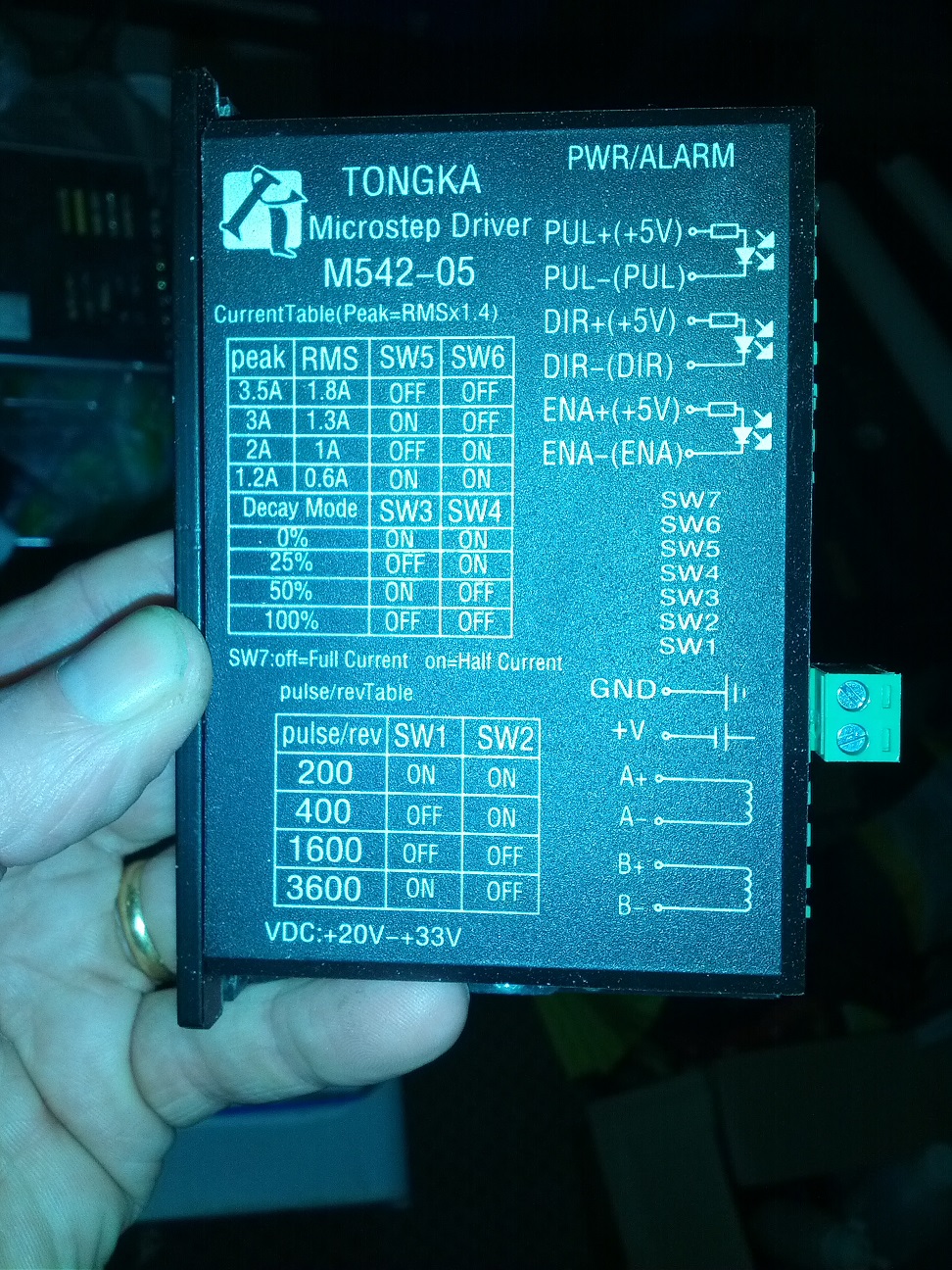

Are those two motor drivers coming with the machine originally?
If so, you don't need to do anything. Otherwise, use 2.8A and 3.5A for X and Y motor. Let it on for 1hr in idle and if it is not super hot like 70~80'C, then it is OK
LPSU setup is pretty standard.
L to TTL, In to PWM, and Gnd to Gnd

Could you please confirm that these are your suggestions for current for the X and Y axis motor settings on my stepper drivers.
Quoted from above Marco..."Are those two motor drivers coming with the machine originally?
If so, you don't need to do anything. Otherwise, use 2.8A and 3.5A for X and Y motor. Let it on for 1hr in idle and if it is not super hot like 70~80'C, then it is OK"
I can't see a 2.8A option on the photo of the controller above? Could you please confirm? Do you mean the peak 3.5A and RMS 1.8A instead for the X axis?? and use the 3.5A peak for the Y axis??
I ask this because my machine works fine when engraving but is missing steps in the x axis causing my horizontal lines in some places to not be where they should be..
Look forward to a reply..
Thanks Andy
Thanks Andy

Was hoping someone could advise me regarding stepper motors and drivers on my generic chinese 6040 50w laser engraver. I upgraded and removed the single corellaser board and fitted a Lightobject AWC608 DSP and fitted stepper motor drivers from a CNC router. I think that the current setting for the motors (especially the X axis) may be wrong?
Perhaps this is the reason behind possible missing steps in the X axis? I have the part numbers of the stepper motors that were/still are fitted and they are 17HW3448N-15AD and 17HW4410N-03AD-Z fitted to the Y axis.
I cannot find any data sheets for these chinese stepper motors so have the following settings on my drivers Tongka microstep drivers M542-05 for both Axis.
Peak 3A
RMS 1.3A
Half current setting on SW7
Decay mode 0%
pulse/rev 1600
Any suggestions for generic values/ settings for this machine please? The laser engraver works fine in raster engrave but doesn't always follow the exact line in the X axis direction. (stopping too short of where it should be cutting occasionally)
Marco or anyone else could you please advise. Thank you
Peak 3A
RMS 1.3A
Decay mode 0%
pulse/rev 1600
Re: Looking to upgrade a 6040 generic chinese 50w laser to a
Sorry I don't know what motors your have. If you don't , then you just need to do "Test and Try" and start with 3A. Let the machine On but without movement (motors will lock up and not movable by hands). About an hr and use your finger to touch the motor feel the heat. If it is warm then it is ok. But if it is very hot like 60~60'C (not 'F), then the current setting is too high and you need to drop to 2.5A or less and do it again
For the micro-stepping, I think you should use 3600 seems better than 1600. But you can do it after proper current is found
