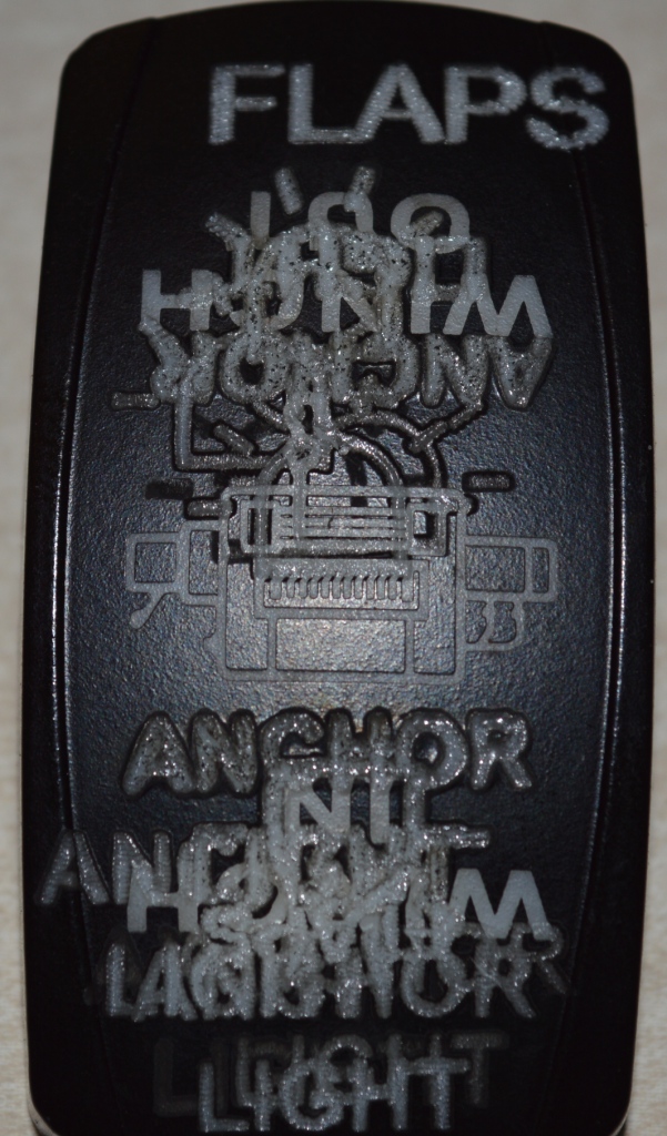

I have attached a picture of a rocker switch that I have been doing some test engraving on. I am using a cheapie Chinese K40 laser with the Lightobject DSP upgrade. This switch was already factory engraved. If you look at the winch symbol in the middle of the switch and the word "WINCH" engraved near the top (upside down) you can see that the engraving is perfect. The edges are very crisp and clear and the engraving depth is very shallow and completely consistent over the engraved area. It is also a good milky white and easy to read (switch is white translucent backlight plastic with a very thin black surface that is engraved through). For reference, the letters are little under an eighth of an inch tall.
Now when you look at the parts I engraved (words "ANCHOR LIGHT" and the light symbol you can see that my results are nowhere near as good. It looks like melted plastic and has been turned shiney and translucent instead of the milky white. The edges are nowhere near as crisp and defined. If you look at the very lightly engraved "LIGHT" at the bottom you can see that it was not enough power to go all the way through the black, but as soon as I use enough power to go through the black it engraves many times deeper than the factory engraving and gives me the melted translucent surface instead of the milky white (and I have cut the plastic and verified that it is milky white very deep, it is not just that I am engraving too deeply, just melting the plastic).
I have tried different speeds and power settings. I did some with a shorter focal length lens than this and got better results, but still not good.
Can anyone tell me why I am getting such bad results? I understand that I am not using a professional expensive laser, but is there anything I can change to at least get better results? Do I need a higher quality tube, do I need better quality optics, is it the difference between a glass tube and an RF tube, is it something with my settings? Any help would be greatly appreciated.

I believe that regular CO2 laser is not the best candidate for doing this kind of engraving. I was told that there is another kind of laser, something call "violet laser" (translate from Chinese).
If you must do CO2 laser engraving with better engraving quality, you must use shorter focus lens like 38.5mm instead of 50.8mm. If you want even better, then you got to have beam expander but it won't be able to fit into the K40 due to the lack of space.

I think the material is just not right to laser.. from its behavior, I should say it is some Polystyrene like plastic. if so, it doesn't matter how small your dotsize or how low your power is.. it will melt..

Techgraphics, this switch is specifically made for laser engraving, but as Marco says, companies doing these switches are most likely not using CO2 lasers so how suitable to CO2 engraving they are I don't know.. I ordered the blue diode cheapie laser, but it has not arrived yet. Coming from China so may be another week.
Marco, I am using a 25.4mm focus lens. I can't fit in a beam expander since it is just a K40 machine. I sent you some of these switches probably five or six months ago. Did you ever get a chance to try them on a machine you have and see if you get better results?
