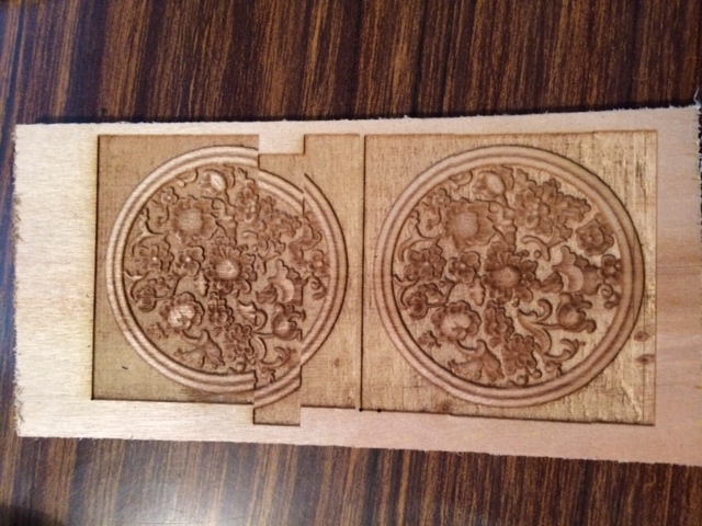

I think the picture says it all!
Top (first) one showed the problem which - unusually - then went ahead and 'corrected' itself (a bit too late to be useful).
A second print under identical conditions worked perfectly.
Any thoughts please? This happens a lot and is VERY FRUSTRATING!!!!!
Nick
Note: The picture has been rotated by the board (forum) software, the one on the left is the 'top' picture and the jump is on the x axis.
download/file.php?mode=view&id=2082
Engraving (only?) jumps its x=0 point halfway through
NickWL

Re: Engraving (only?) jumps its x=0 point halfway through
Nick:
I sent you links for new OS patch. Try it and let me know if it fix the problem
