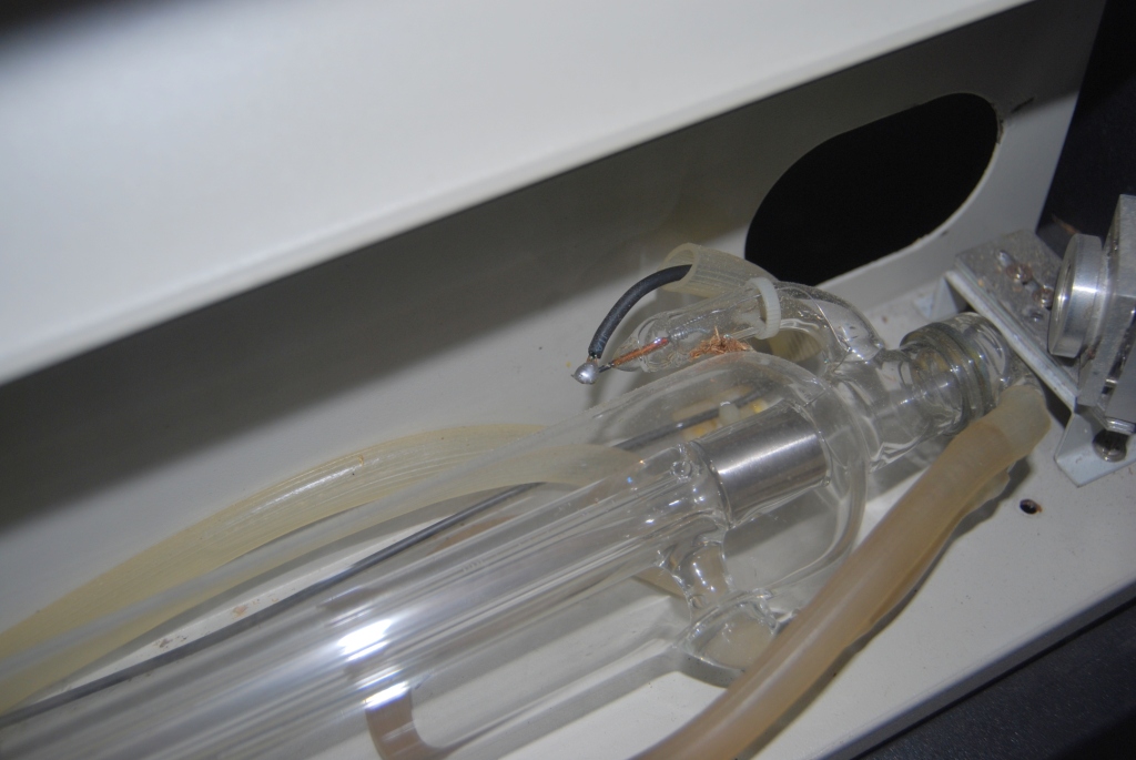

I am in the process of upgrading a 40W cheap Chinese laser with better optics, electronics and hardware.The good Chinese folk who built my 40W machine decided to solder the high voltage supply to the pins on the glass tube. I had read on this forum that this should not be done because it will cause premature failure and gas leakage. However, I need to remove the tube to fit new tube mounts and to better aim the mirrors using a red laser module temporarily fitted to the tube mounts via a dummy glass tube. Can anyone tell me if I should try to desolder the connections? Are there any other options? I was considering cutting the wire just off the pins and then rejoining it with screw type terminals. Pic shown below. If it is best not to disturb it I will try to lift the existing tube out of the way.
Also, the soldered joints are not shielded in any way. It looks like the "engineers" slipped some tube onto the wires, then soldered them and then realised that they couldn't slip the tube onto the connection and fill it with silicone as is usual. This is another reason I wanted to desolder the joints. Any advice would be appreciated.

I've no idea whether you can de-solder, though personally I would just tear the wire out of the solder and snip any excess away (without trying to be perfectionist about it!).

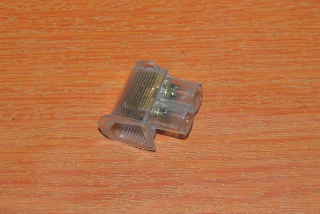

Then I'd use a connector like the one you've shown - brilliant idea and I can't imagine why no-one has come up with this move before.

I had sort of decided that I would do as you suggested but then the problem sort of resolved itself. While I was inspecting the tube, one of the wires just fell off the terminal, solder and all. It appears the solder never properly alloyed with the terminal material which I am guessing is not copper. If I can get the other wire off the same way the fix will be simple. After some more research, I have found that the screw in the terminal connector should be non-metallic so that it cannot arc to the chassis. I will make some nylon ones.

That pin I believe is Tungsten which is why the solder didn't stick (to solder to Tungsten takes insane temperatures for hobbyists).

I had a feeling it would be tungsten. The connectors I am thinking of using are sold here in Australia as "BP" Mains Connectors. Link on Ebay is http://www.ebay.com.au/itm/40A-Mains-Cu ... 5c1&_uhb=1 You can buy them with single screws for active and neutral and double screws for earth. Maybe just filling the screw cup with silicone would be sufficient to stop arcing to the chassis.

Thank you for that connector info...that's a big help. I'm going to hunt down a piece and see about finding just a single terminal and wrap it up in silicone so it'll be nice and snug.

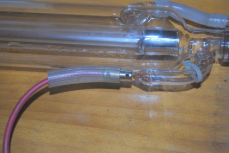

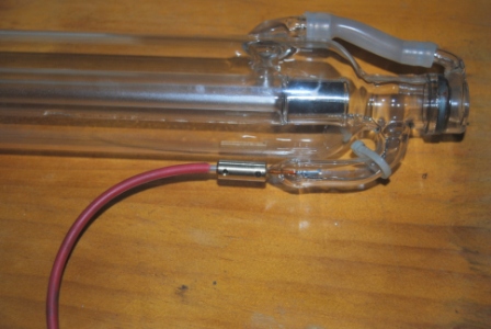

I have moved on from the idea of using BP Mains Connectors to join the tube terminals to the HV wiring. Today I machined two brass rods with 3mm socket head grub screws to clamp the tungsten tube posts to the HV positive and negative supply. These are just slightly bigger than the internal bore of the silicone water tubing so that I can run a sleeve of silicone over each connector and then coat each with a smear of silicone sealer to stop any moisture seeping into the joint. The tungsten posts are around 1.2mm diameter and the connector is drilled out at 1.6mm diameter. It all seems to go together OK. I won't know for sure until I get my new power supply!
Regards
Preso
Regards
Preso
- This view shows the silicone tube partially pushed over the brass connector.
- Brass HV connector sleeve.jpg (75.43 KiB) Viewed 6013 times
- This view shows the brass connector snugged down onto the HV wire and the tube post.
- Brass HV connector.jpg (73.37 KiB) Viewed 6013 times

Not recommended to attach such big 'weight' connector to the fragile pin. You may break the pin with a tiny movement on the HV cable
I'll try to get some pin type connector; one end is screw and another end is snap on
