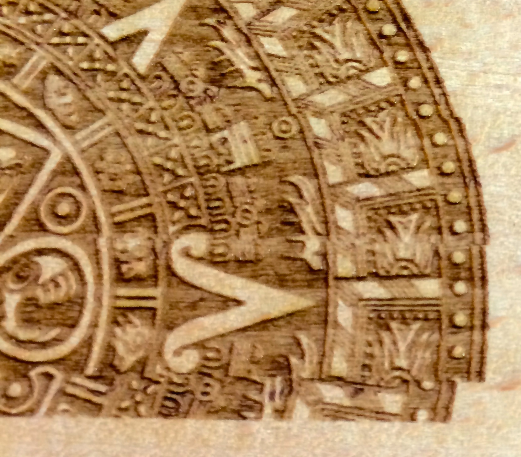

Thanks to Walt the innie-outie problem is solved ... only to reveal the next problem!
This is a K-40 with a complete DSP (Ligtobject's of course!) replacement control system, drawing done in CorelDRAW and fed to the machine via LaserCAD.
The x-axis keeps skipping anything from 1 to 3mm to the right, easily seen at the perimeter of this circle where it has happened several times (although the topmost 'skip' is - confusingly - to the left!). If this was on my 3D printer I'd say I was printing too fast but I'm not yet familiar enough with this system to know whether the same analysis applies.
Does it?
Nick

Re: Engraving - in and out
try to set the stepper driver to a lower setting. check your belt if it is a bit loose tighten ion the right site of the carriage

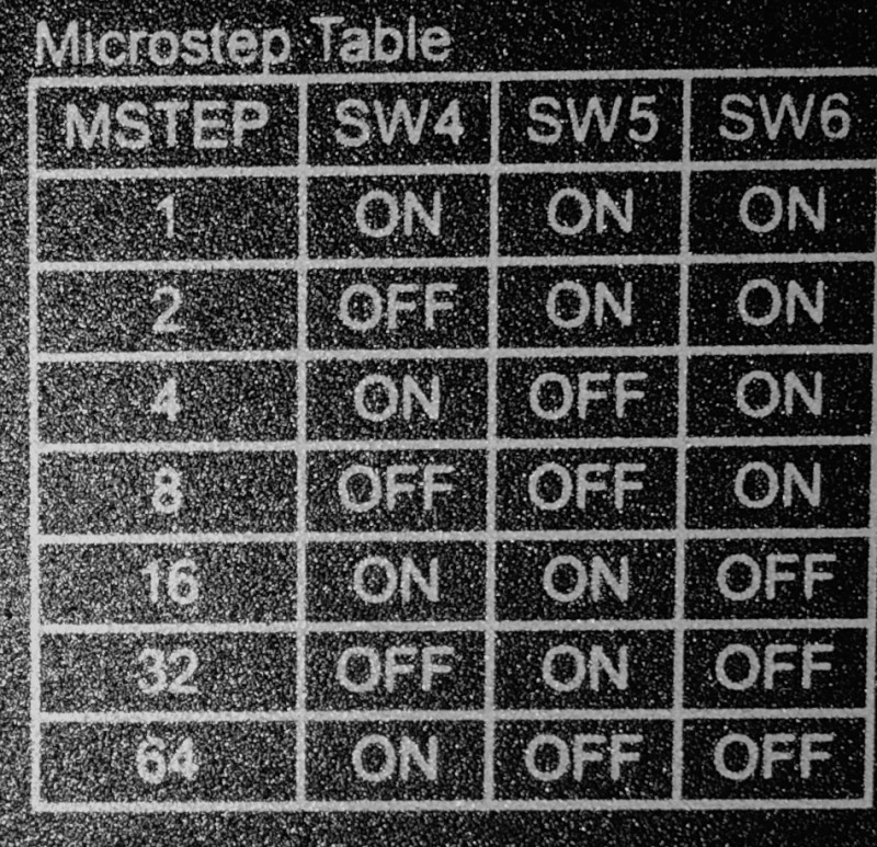

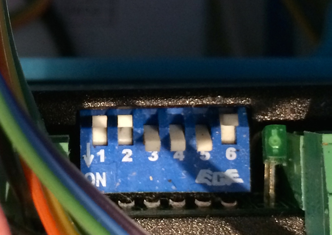

The stepper drivers are M415B from Lightobject, the relevant DIP switches and table are shown in the attached pictures.
The first 3 DIPs are set to give a current of 0.63A.
Nick
Nick
take it down to 8 and try
NickWL wrote:The stepper drivers are M415B from Lightobject, the relevant DIP switches and table are shown in the attached pictures.
