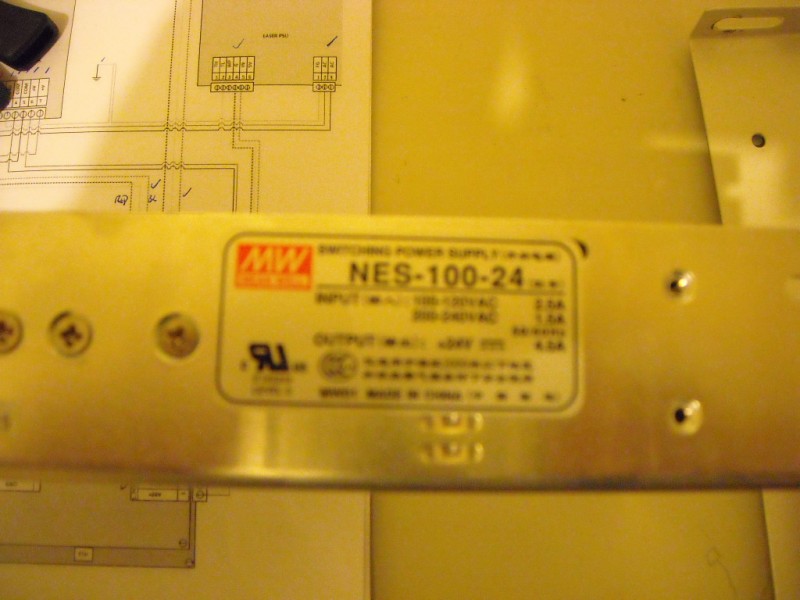

Looking at ciberbob's psu, mine is the same except for the 4 pin plug(green) to the right of the psu and also the big white bulbas thing on the Anode wire line (big red wire).
Mine had the 24V psu also, I have already installed the DSP kit but need to know if my PSU is any good, hope the attachments work but here are three pics to look at.
Thanks for any help.
PS: Whats this lasercad an firmware do I need them if so can you send the link to them Inv # 113981B
Thanks for the help.

not to worry bout it just ordered a new Laser PSU thanks :)
