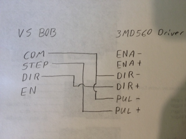

My 3 phase, 3 wire XLE steppers lock up when the system is powered up. I am running them with 3MD560 Drivers and an v5 BOB.
The BOB appears to be functioning properly. See the attached BOB-Driver wiring diagram.
It is my understanding that the 3 wire steppers can be wired in any combination to the U,V,W outputs from the driver - is this not correct?
Any Ideas?
Travis
Any Ideas?
Travis

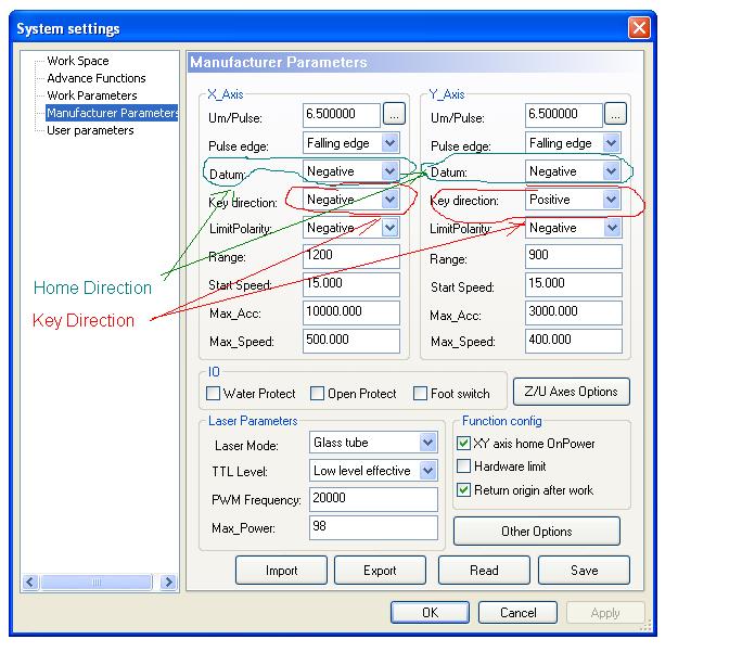

Re: XLE steppers locked up when powered?
Use LaserCad parameter setup to reverse the direction. See manual pleaselauckstreet wrote:Ok, one important piece of the puzzle was missing. Power to the stepper drivers. I connected 24V DC to the Voltage VCC and ground to ground and now the motors initialize and move when I press the arrows. However, direction seems to be reversed. I'm not controlling it from software but from the controller display. Is there a setting to reverse the direction? Based on the location of the limit switches, it appears that 0,0 is in the right hand upper corner. Therefore, the + direction should be down and to the left but that's the - direction. How do I reverse that?
Bob
See image
- DSP_Direction.JPG (82.41 KiB) Viewed 6666 times
