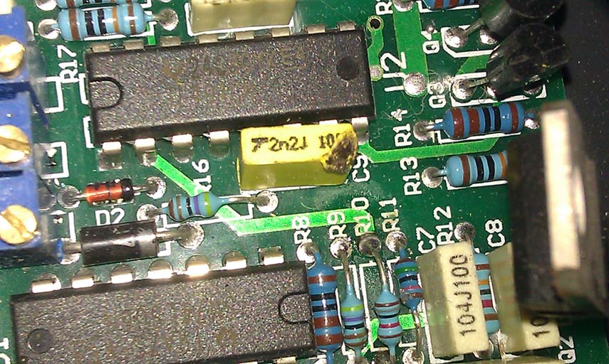

Delving deeper into the failed power supply I saw this
Not good........
It might be just over 12 months since I bought it but maybe 300 only hours total in use !.
John
Not good........

If you want to, you can send the board back to China for repair.

I have bought new one ( locally) ..probably not worth the postage sending this one back...though be good to have a spare ...what do you recon?

If you just take the PCb board out without the case and the transformer, the postage fee shouldn't cost you too much, right?
You can use the cheapest way to ship it. The return shipping cost runs about $30. I can use my "Mighty Power" to call for free repair service

Thanks Marco I might just do that............
