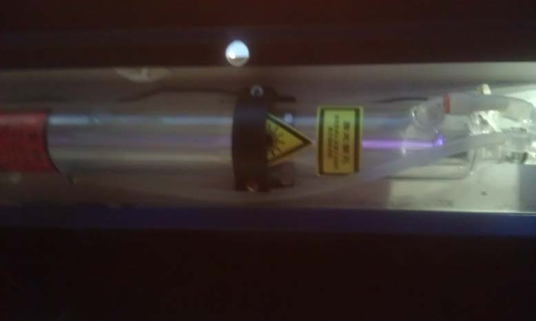

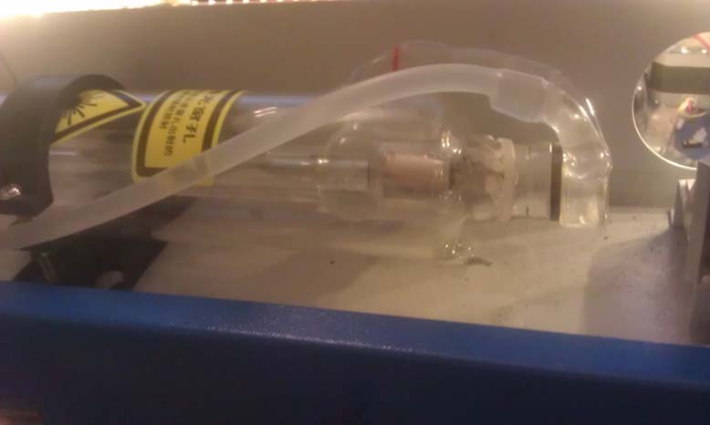

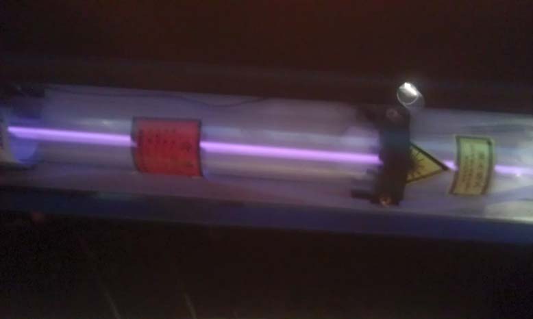

Could someone peek in the back of their machine to see if this glowing is correct ?...thanks
Sorry for poor pics but could not use flash
ok when machine is turned on (no glow)
Bright glow with laser firing
dim glow after laser has fired ..this glow goes away the instant the machine is turned off.
As you can imagine I don't want to ruin a new tube if there's another issue here.
John
Re: Losing power and a faint purple glow
Posted: Wed Aug 28, 2013 1:54 pm
by waltfl
hi john
I got a crazy idea check your connection between the DSP "Laser1" and the power supply, make sure you got a bridge between WP and G on the powersuply and the connection to ether TL or TH the setting in the manufacturer settings need to be the same ( ether high level for TH connection or low level for TL connection)keep in mind if you wana change something in the manufacturer settings you need first hit "read then change the numbers then hit " save"
it could be the power supply even if this is very seldom. check the tube wiring
the tube should not be glowing if the laser button or from the program is not on.
Posted: Wed Aug 28, 2013 1:58 pm
by waltfl
no this should not be at all.
it looks like the tube gets power from the power supply because this does not turn off.
now try to format the DSP with the display menue and then during download from the program
did you use the right OS update?
try also disconnect the DSP from the power supply the big green plug, then use the red test botton to fire the tube
and see if the glow is still there afterwards

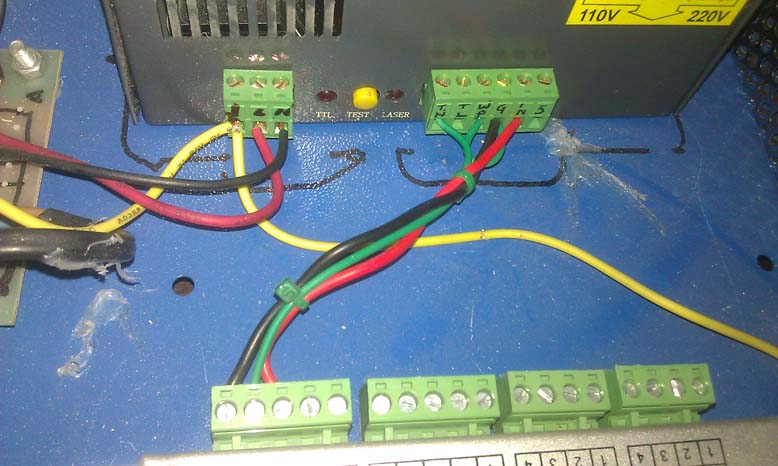

Posted: Wed Aug 28, 2013 3:31 pm
by waltfl
OK john
what connector on the dsp did you use for the laser???
make a picture from the connection on the DSP
check your ground connection especially the black or blue wire from the negative of the tube should not be connected to anythings else except the mA meter and the power supply not to the machine ground
make sure you got a good ground for all the parts with a extra ground rod on the outside.

Photo of wiring
Posted: Thu Aug 29, 2013 2:39 am
by waltfl
hi john
did you try to change the TTL to low in both connection on powersupply and in machine settings???
did you set the laser #2 to zero??? in the cutting file when you select the cutting perimeter?
I could not see which laser plug on the DSP you are using laser #1 or laser #2?
Posted: Thu Aug 29, 2013 3:00 am
by 1n2
HI walt
sorry,
I am using laser1 (The one showing the dsp side of the connectors was badly out of focus))
Yes laser 2 settings set to 0.
Yes changed both the physical and software settings and remembered to read first.
I even tried with the wrong setting (for completeness) and indeed it was all back to front and still when the TTL was "off" the tube glows
Did you see my reply to Marco that with an analogue control (pot)? It glowed the instant the pot was moved (with and without any connection to the TTL )
would this not (normally) rule out the dsp?
Can you check the PWM voltage on your dsp when the cut (or test fire) is finished and see if the volts are still present. If so this will definitely mean my DSP is good.
John
John

waltfl wrote:hi john
I will check the voltage on my machine and report it back.
1n2 wrote:HI walt
sorry,
John
