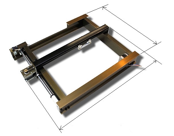

In the UK it's easy and convenient to buy materials in A4 sheets (297x291mm) but the xy stage in my machine won't allow me to cut that size. You've stated that your Lite 300*200 X-Y Stage was a working area of 300mm x 220mm... which sounds like it would allow me to cut the whole sheet... if I can fit it into my machine.
So I could do with knowing the dimensions indicated in this image:

by Tech_Marco
I will measure it for you tomorrow

by Tech_Marco
See my measurement.

@Marco: Thanks for that info. It looks like it will just, but only just, fit into my machine. It also looks like it will be fine with an A4 sheet provided that I'm careful about how I mound the head. I'll get Easter hols out of the way and then place an order

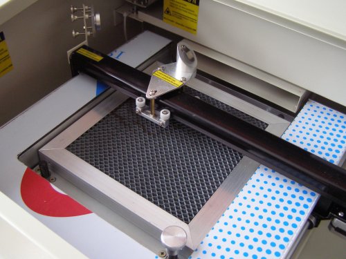

I've had a look at pictures of the K40 and although the cabinet appears to be the same, the XY stage in my machine is completely different:
That image show it as it came. The honeycomb is only 170x190mm. Removing the honeycomb gives more space but the screws on rise/fall bed prevent an A4 sheet from being loaded. I removed the rise/fall bed as well and replaced it with a pin bed, but even then I had to remove the extractor shroud (you can see it in the picture). Having done that I can load an A4 sheet but I still can't machine all of it (only about 250mm of the 297mm length).
It's got to be 4 or 5 years now since I bought my machine so I guess they've upgraded a few things since then... which would explain why your newer cutter can machine a full A4 sheet while mine can't.

Ah, the one I got didn't have an adjustable bed, I had to make do with a piece of mdf under the whole lot to raise it up :)
that white surround looks like it covers up a lot of the space too.
wow safety warning stickers, thats posh. :D
Re: Lite 300*200 X-Y Stages for DIY CO2 Laser
Posted: Thu Mar 28, 2013 2:21 pm
by andyslater
twosoc wrote:that white surround looks like it covers up a lot of the space too. :D
The opening that you see in it is 'framed' by sections of aluminium that form the structure of the xy stage; so there's no easy way to modify it to get more usable space.
