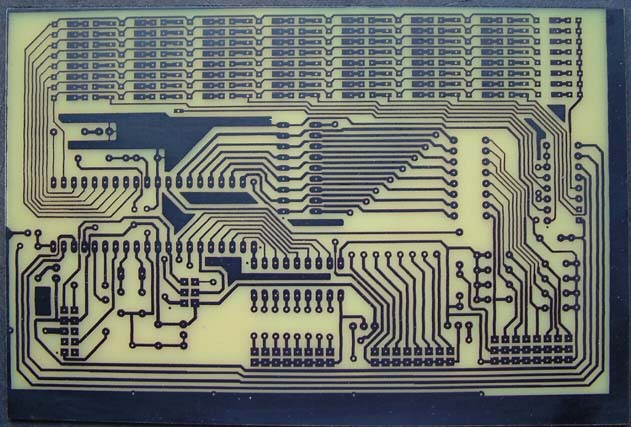

I am curious about the method you used to make your PCB. Did you use a paint and engrave method? If you could provide details that would be great! I have been considering using my laser for PCB etching for a while, but haven't had time to experiment with it yet. I hear that some paints leave a residue after being engraved that can't be etched through.
Re: a few things I have done with my machine
Posted: Tue Oct 01, 2013 9:26 am
by 1n2
tech_builder wrote:Hi,
Hiya
Yes big issues with residue but I cracked it, and it is simple beyond belief.
You are correct in the method.
I draw up the pcb in "layout 50" then I save the drawing out as a BMP
pop the BMP into Corel paint and use the fill brush to make the bit you want to etch away black and the bits you want to keep white..(I found clicking several times when "filling" sharpens the image a treat).
There are probably better ways But I am no expert with Corel.
I then open Corel draw and draw a box the exact size of the drawn board ..then import the BMP and stretch/shrink it to fit the box.
I Use normal fast drying satin black spray ..just one reasonably heavy coat.
Every paint I tried left awful residue and even doing a Google search showed only solvent removal methods ....and everyone claiming success (yeah right!!!) simply no good for fine tracks.
Engrave the bmp
now here's the cool bit (I tried dozens of different solvents)
Simply get a scouring pad with water and a little washing up liquid and literally just rub away the residue..(I have not yet taken a track away with this and I do quite a few boards for the flight simulator I am building. It turns out it really is that easy LOL!...I should do a You tube vid !
Hope this helps ..if you have questions please please ask.
Here's a pic of an etched pcb I made at the weekend (the thinnest track is .4mm) to give you some idea the whole pcb is 100mm x 160mm

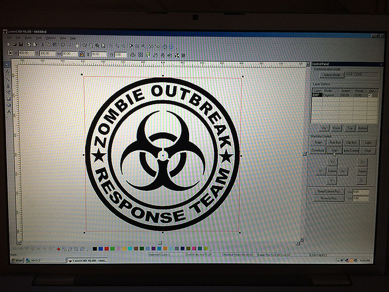

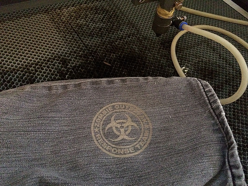

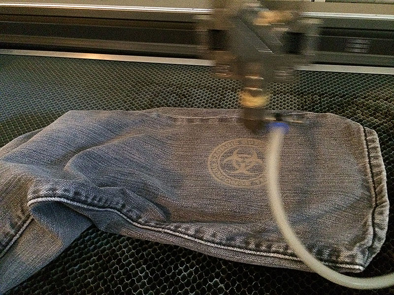

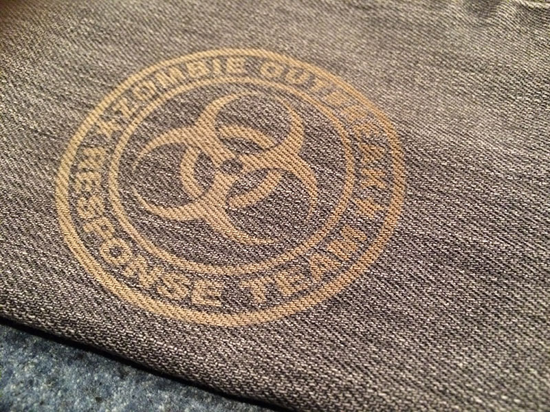

i set up a raster engraving for the old standby zombie logo.
and etched it at 15% power and 200mms/s into an old pair of jeans.
i was a little concerned about getting the power levels and speed right
but it worked like a champ!

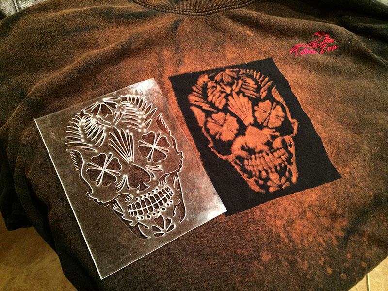

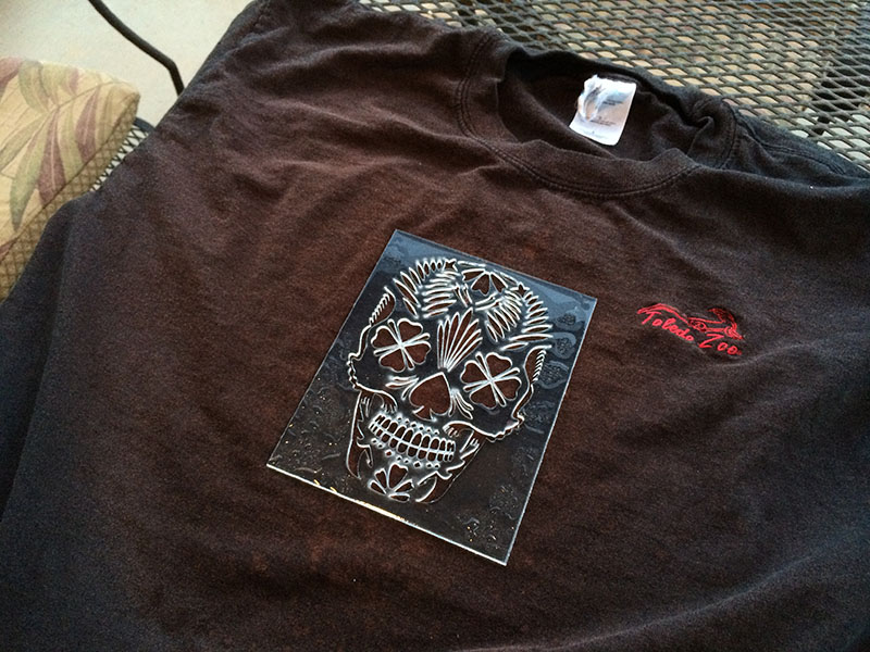

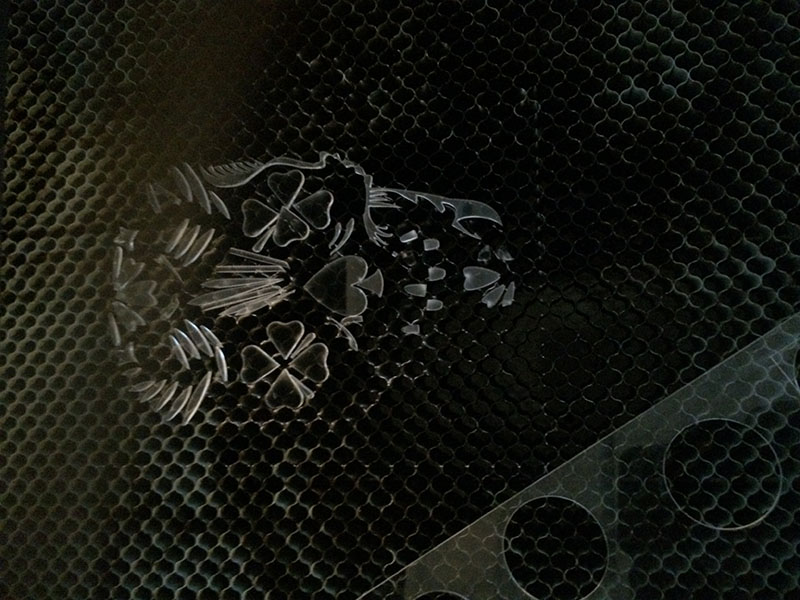

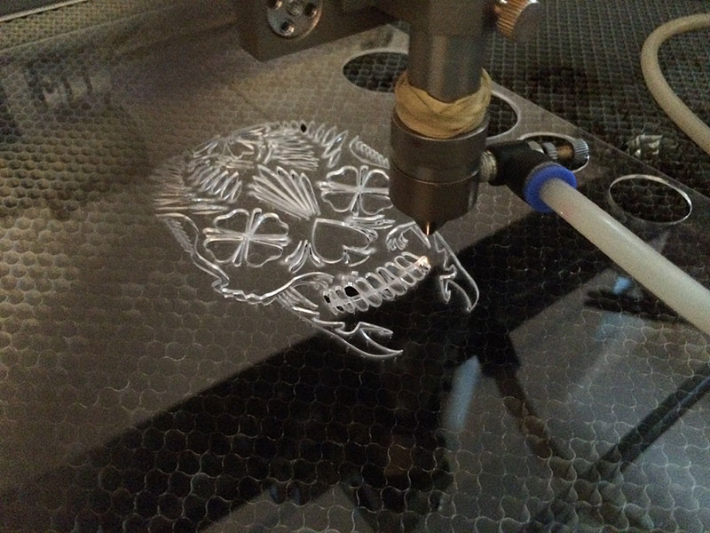

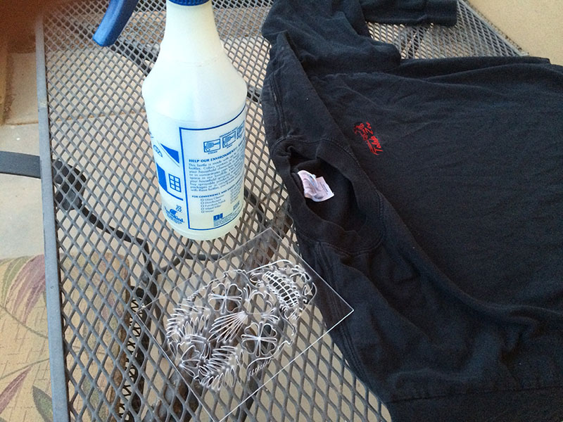

i started with a day of the dead design that i found online. i reworked it in illustrator to make it more suitable for laser cutting.
it's really satisfying to lift material out of the cutter bed and have the cut bits retain their arrangement.

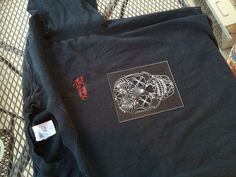

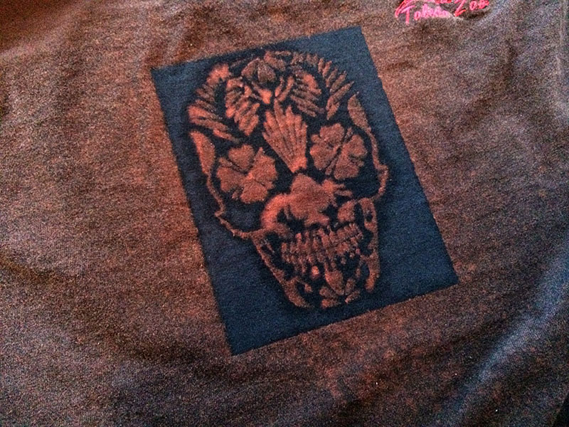

i mixed a 1:1 ratio of bleach and water in a spray bottle.
there's a piece of sheet metal inside the shirt so the bleach doesn't bleed to the back of the shirt.
i spritzed the bleach water all over the shirt being totally unconcerned about uniform coverage.
i let the bleach water soak in for about five minutes and enjoyed view of the moon from my back yard.
i removed the stencil and rinsed all the bleach out of the shirt.
how cool is that? ;)
