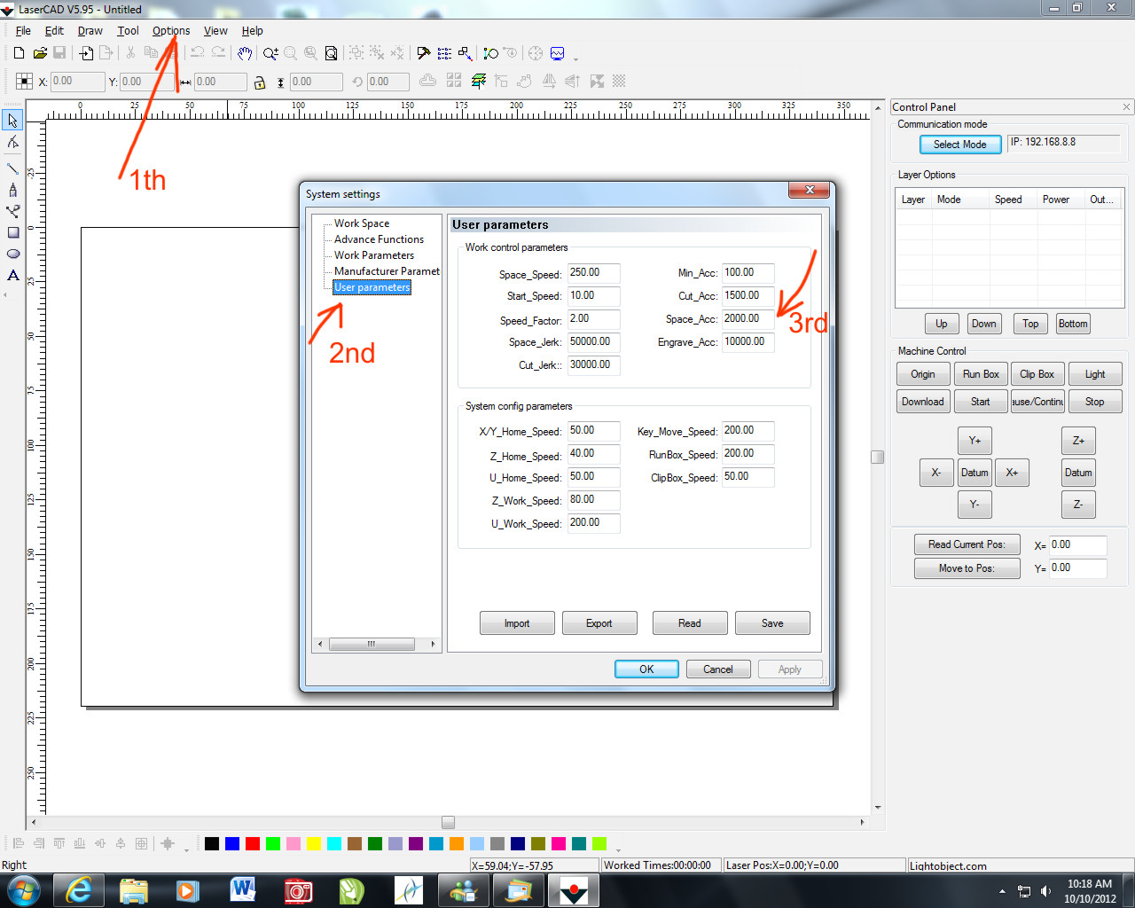

in the video the sound seams to have to do with your space acc set it down in the manufacturer settings.
the stepper driver sometimes need to be set to a higher setting ( 3200)
check your X- axis switch if he gets earlie enough engaged.

space acc is space acceleration setting in lasercut - opiton - system option - user parameter then see picture
the 3200 micro steps need to be set direckt on the stepper driver see manual
