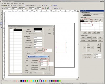

Try the Overlap in the Cut Parameters. That may do it (I haven't tried it).Greolt wrote:Will LaserCAD allow overcutting?
By overcut, I mean where you can specify that the end of a closed vector cut will continue a set distance past the start of same cut.
Very common feature in CAM software.
Greolt

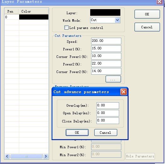

Re: Overcut in LaserCAD
For a closed loop cutting, you can use the "overlap" to extend the cutting.
But it won't work for an open line per programmer Li
Update: so far it can do up to 3mm extended cutting.

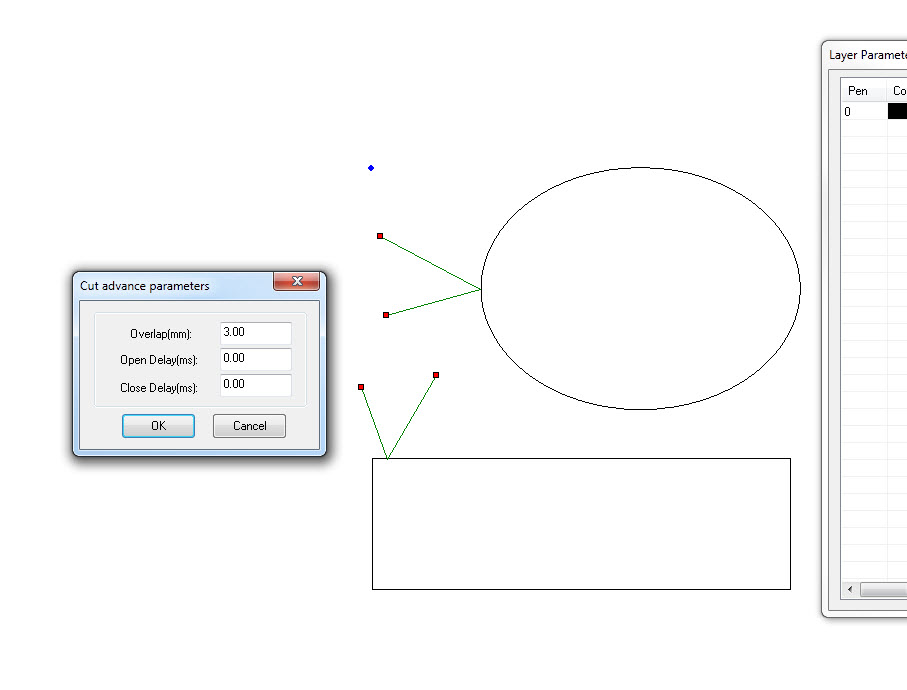

It appears like it does not work.

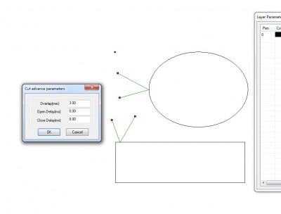

Just to illustrate, here is a pick showing lead ins and lead outs.
Overlap of 3mm has been set but not showing.
Ellipse and rectangle are about 5mm wide overall.
Also if I don't use lead in and lead out, and simulate the cut, it does not do the overlap.
Greolt

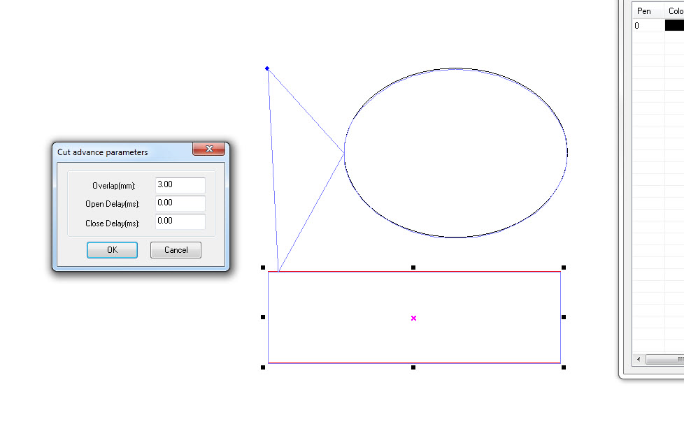

Here is the same example.
Overall size is approx 5mm.
3mm overlap has been set.
Simulation run (blue line)
No overlap apparent.
Greolt
Greolt
It won't show it on graphic. Did you ever try it on machine making a real cut?

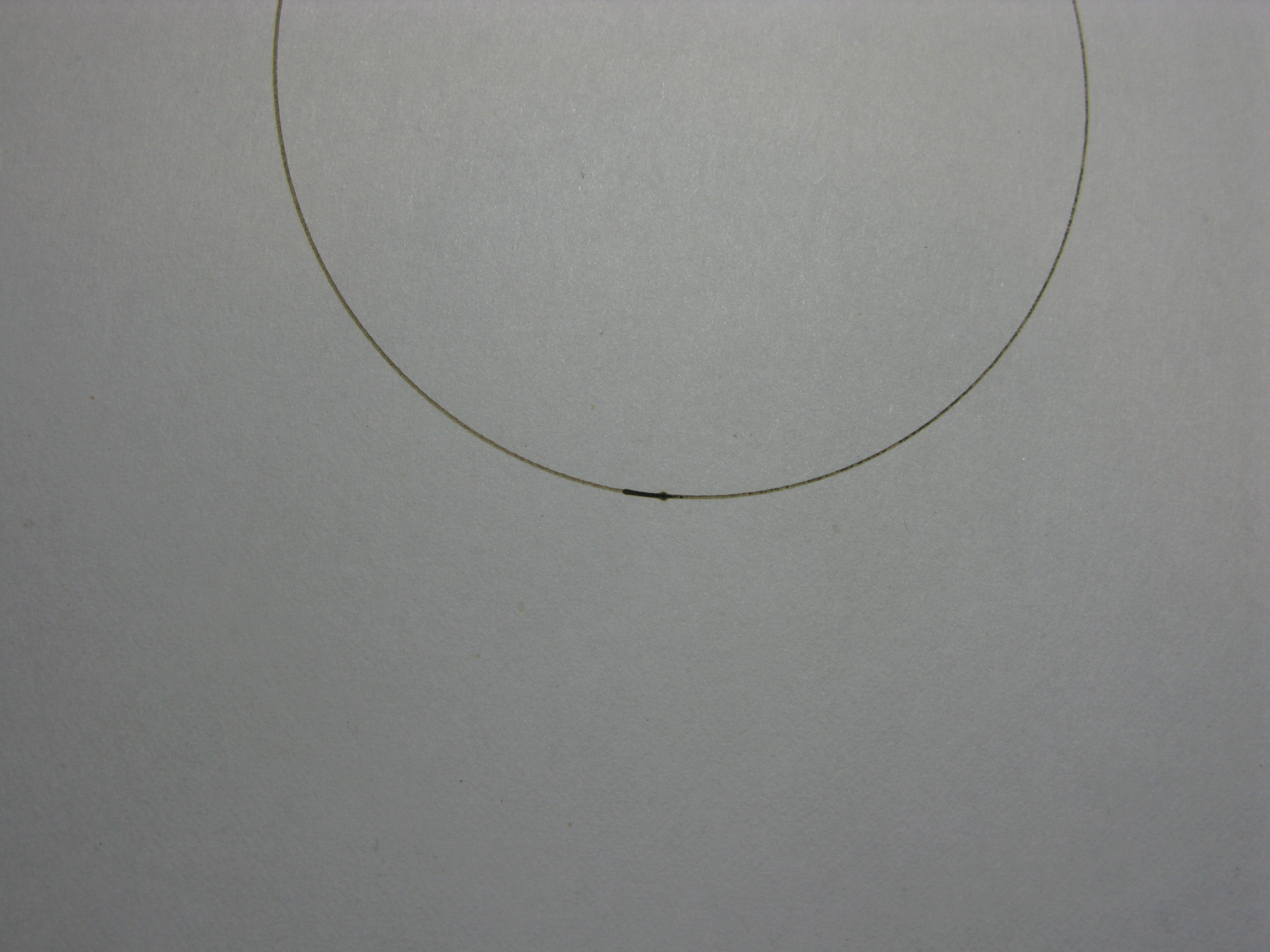

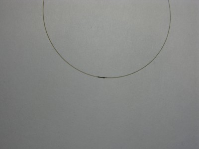

See Youtube video
http://www.youtube.com/watch?v=l-MKAP2VW34
To let you see more clear, I have added delay before and after the fire. There was a clearly 3mm over-cut

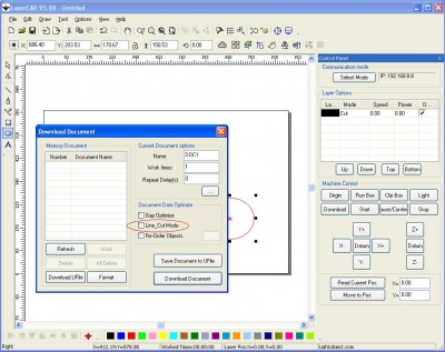

Greolt wrote:AWC608
8:12:02:23
LCD 5:12:01:05
LaserCAD 5.88

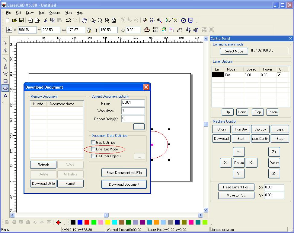

FYI, I tested old one (8:12:01:08) and (8:12:02:26), all worked great.
The reason your didn't work could be a setting issue. If you put a check mark on "LIne_Cut_Mode", for sure it will disable the "over-cut" feature as over-cut won't work on line alone. See image.
If it's not the case, please try something else.

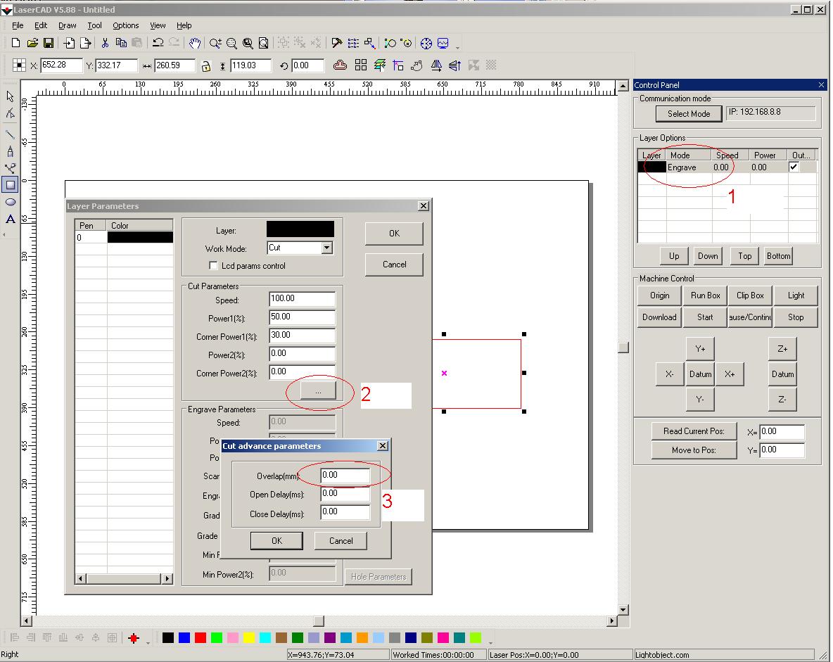

Did some more tests and this is the results so far.
Overlap does not work in combination with lead ins and outs.
Overlap does work if leads are not used.
The "LIne_Cut_Mode" checked or not, does not make any difference. Overlap will work either way.
Overlap does not get simulated. Perhaps this should be on the list for a fix.
And maybe when leads are set then overlap setting should be greyed out to show it is not available.
Overall I am happy that overlap works.
Thanks for the support.
