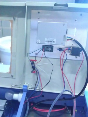

WOuld like to post some pictures of the K40 conversion,
With being nervous how to connect everything, reading for days this forum, occupying Marco a lot.. it took me 4 days to get this done.
So ofcourse being proud i succeed, but also still have some issues,
I have removed everything out the K40 controller space and build all new parts into the same space.
The limit swith had 3 legs and i have soldered one cable to the other leg, to get the proper signal.
My worry was that the Red laser feeding cable (wich i left on same length for future machine) was also in this space, and had the feeling that this causes inductional behaviour
to dsp and controller card. e.g. Loosing connections between laptop and controller, I have transported the long cable into the lasertube space and it disappared.

The cover where you can see the shunt for the mAmpere
