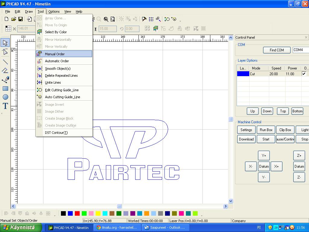

Thank-you for the screenshots, I will try that tomorrow and let you know how i get on

if you look at the manual order whether from the shadow of the object in the cutting coaster?
- Posts: 14
- Joined: Fri Aug 26, 2011 12:35 am
Sorry Teacdance i'm not sure what you mean by that, i have selected manual order, but cannot find anything in regards to 'shadow'
Even when i select manual order it still does the same
