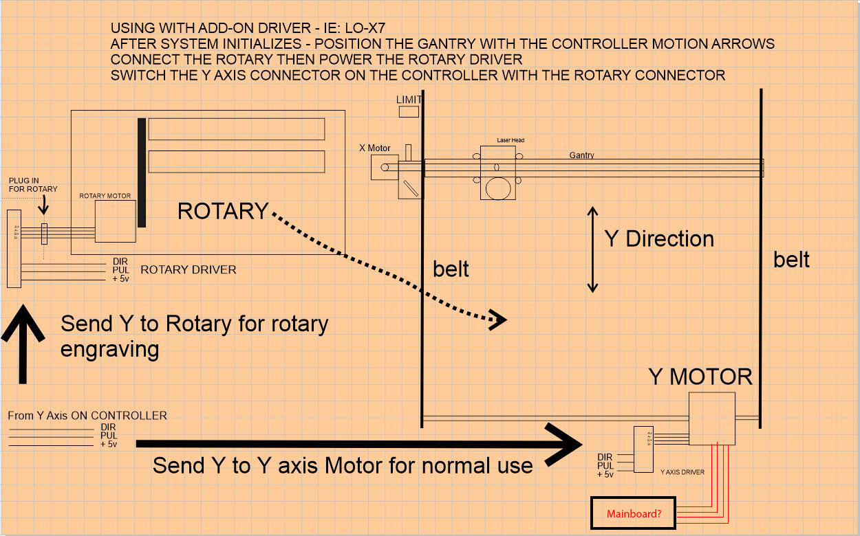

Yes, Please go back 1 page to page 4 of this thread and the instructions with photos are here.
You need the Mini Rotary, A Stepper driver http://www.lightobject.com/Mini-2-Phase ... -P650.aspx
and some wire.

Thank you. What does this plug in on drawing one on page 4? And which wire I need?

000ooo000 wrote:Thank you. What does this plug in on drawing one on page 4? And which wire I need?
Chris
I used a Network CAT5 cable joining all the same colors together (yellow with strip joined to Solid Yellow...) and RG45 Plugs, You can use any 4 wire plug

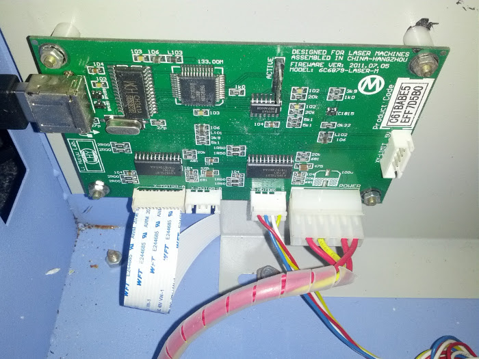

The instructions on page 4 does not help me. From my Controller go 4 wires in the Y motor. How do I take DIR PULL +5V for the rotary driver?
Or do I have the y Rotary motor connect directly to the controller ?
Thanks for help.
I have this controller. Where should I install the Rotary driver there?

000ooo000 wrote:The instructions on page 4 does not help me. From my Controller go 4 wires in the Y motor. How do I take DIR PULL +5V for the rotary driver?
Thanks for help.
Sorry, The mods I gave are for the Light Objects Controllers like the LO-X7, not the Mushi Board. I am not sure if you can adjust the settings on the MushiDraw enough to use a rotoary. it is a very basic controller and the outputs are A+ A- B+ B- directly to the stepper motor. The stepper motor on the rotary may need to be changed to a lower amperage or you could fry the mushi board. I recomend you upgrade your controller.
