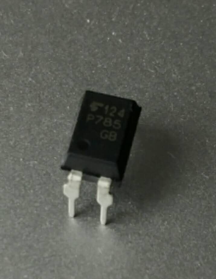

Still need electrical specs for hookup. Had this card for months, still waiting on the shelf.

Connection diagram does not help. Need basic electrical spec!
The "OUTPUT1". Is that an open-collector? Open-drain? Driven high/low? 5v? 24v? Is it an opto only capable of a few mA, or can I drive a relay with it?
We cannot continue to integrate this until you provide documentation!
Re: Lightobject new DSP laser controller card
I don't have those detail info from the manufacturer and I have no problem to use the out out to control an IO board or driven a SSR.The output is 5V that's all I know. The current should be 10mA or less and itis better to drive a SSR but not a relay
I really don't see the difficulty to use it to drive an exhaust fan with the output signal. Anyway, let me ask the manufacturer see if they have info to share. Stay tuned
The manufacturer send me a picture of the device that used to output the control signal. It is an Opto switch
It look like it is an ok Toshiba TLP785
http://www.mouser.com/catalog/specsheet ... 120220.pdf
That's all I got
That's all I got

So it's gonna have to be open-collector or open-drain, it can't be both- which is it?
I don't know.
I think with your electronic knowledge you can test it and figure it out
When the output is "off", there is 5V appears on the output terminal. When it is 'On', it dropped to "0v" in respect to the Gnd
Techgraphix
- Posts: 492
Seen from the datasheet, it's Open Collector.. And according Marco's post, it also acts like one..
Nothing special about that..
Is its polarity programmable? I would most likely connect that to an NMOS, so high=on, but if it's an opto in open-collector mode, "on" is low. How does that work?
