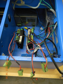

I make a few picture from the rest setup but the card is allready on its way

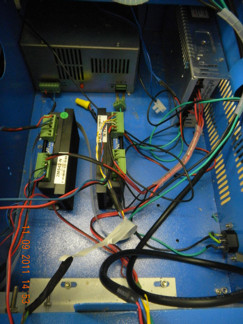

here are the picture of my setup. on the left the laser supply, to the right the 24V PS, in the middle the 2 driver 2m5042
I had the card allready taken out befor I read your email nut you can see all the wire.

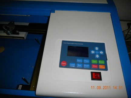

the other picture is the LCD panel.
I hope you see all you are looking for.
