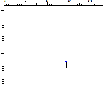

I believe the issue is related to the little blue diamond that LaserCAD shows - This appears to be the software origin, and it is calculated to be the upper-left-most part of the figure to be cut. I would like to know how I can make that blue diamond always be at (0,0). Today I do this by adding a Pen Run around my figure.
Hopefully this will illustrate: When I create a new figure and put in my box, here is what I see in LaserCAD:
10mm square at (100,100)

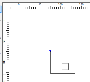

The blue diamond seems to be the figure's origin. I will call this the "origin dot."
If I add another figure, the "origin dot" moves along with it.
new rectangle, new origin dot
What I want is for the origin dot to be at (0,0).
