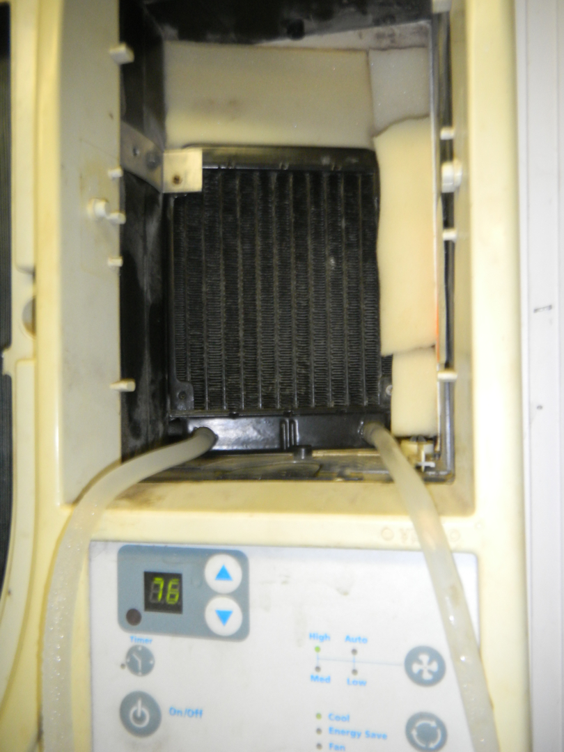

just a note at the side especially for florida I am in south west florida and I can tell to run a laser in a un air-conditioned space the cooling water temperature goes pretty fast in the range where the tube gets destroyed above 15degree Celsius (78F) there the tube starts loosing integrity and then the front lens cooling chamber comes off and that's it.
if the temperature goes below 60F the cutting power does not go down it stays .
I have a window A/C running which also is used as cooling for the water with a 120mm register ( see picture) and I have on very hot days ( above 95F) a hard time to get the temperature below 24C .
this small fridge will probably not do for heavy cutting.

I am thinking that modifying a small fridge would work OK. I have seen some small ones that are made to cool just a six pack for pretty cheap. just put a quickie temp sensor and controller on it and should be quick and cheap.

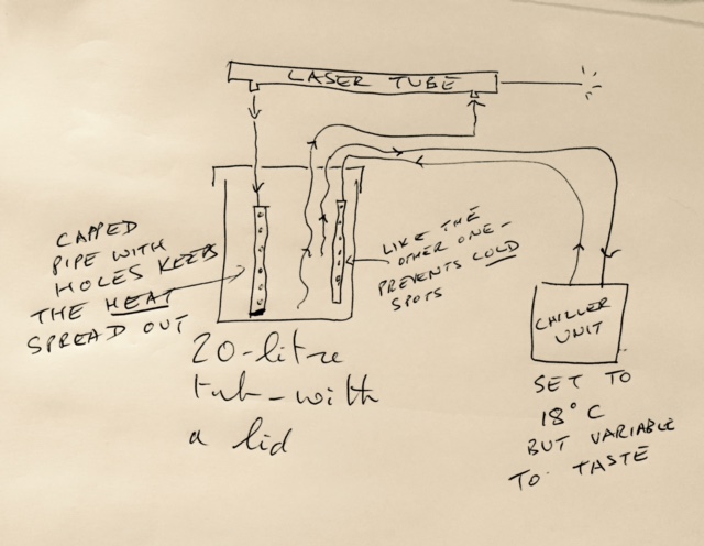

What I ended up buying on eBay was one of these: Arcadia Aquarium Chiller 500ltr 250w AT250 Summer Fish Tank Water Chiller; I've never looked back. I always run the chiller and circulating pumps for a while before firing up, so as to avoid thermal shock.
Here's a picture of the setup - I've omitted the pumps because a) the picture is cluttered enough already and b) if you can't work them out for yourself your mummy shouldn't have let you play with lasers in the first place!

they are way to expensive for a water chiller, the system I use is a 20.000 BTU window AC with the radiator and it holds the room temperature at a normal ;level and the same time it cools the laser water.
the window AC and the radiator cost about the same as the aquarium chiller .
