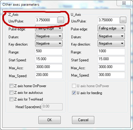

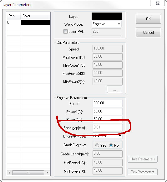

Perhaps I could make a couple of other small suggestions for usability improvements that you might mention to Li during your discussions.
1. Allow three decimal places in "Scan Gap (mm)". See pic. Presently it restricts to two decimal places. This would be much more flexible with differing DPI pctures.
2. Allow a setting less than 1 in "Z axis Um/Pulse" See pic. Presently if I enter 0.375 (the correct pulse distance that my Z axis needs) it rejects that and defaults to 1.0 This would suit many motorised table users.
I am optimistic that Li might see these two suggestions as easy to implement.

Re: Z axis soft limits
1.) I think it is possible feasible But 2) is impossible. Anything less than 2.5 would be unstable per Li. He suggested the range is between 4 <> 20. If the um must be less than 2, he suggest to change driver setting.

That is great news Marco. This would allow for almost any DPI photo.Tech_Marco wrote:1.) I think it is possible feasible
This news does not affect my use of the controller. As explained previously, I completely disregard the Z axis DRO. If DRO says table has moved 50mm, in fact it has only moved 5mm.Tech_Marco wrote: But 2) is impossible. Anything less than 2.5 would be unstable per Li. He suggested the range is between 4 <> 20. If the um must be less than 2, he suggest to change driver setting.
However I thought it might be good for other users.
Greolt

Hey Greolt,
I think your going to have to change the microstepping amount on your driver. if it's at 8 then you could set it to 4 or 2. You loose resolution but with a um setting so low, I don't think it will hurt. If you are using servos, then you need a new encoder unless you have an encoder multiplier setting enabled.
I use drivers with a fixed ten microsteps. If I move the table 50mm by the DRO, it in fact only moves 5mm. Correct setting would be 0.375 Um but I use 3.75 Um instead. However because I disregard the Z axis DRO, it does not affect me.Telrad wrote: Hey Greolt,
Other users may find it a problem. The typical motorised table gearing reduction, is quite large (compared to a belt driven X or Y). A setting less than 1.0 Um is often appropriate.
I had hoped that it might be a comparatively easy fix, but alas it seems not. As I say, it does not bother me personally.
