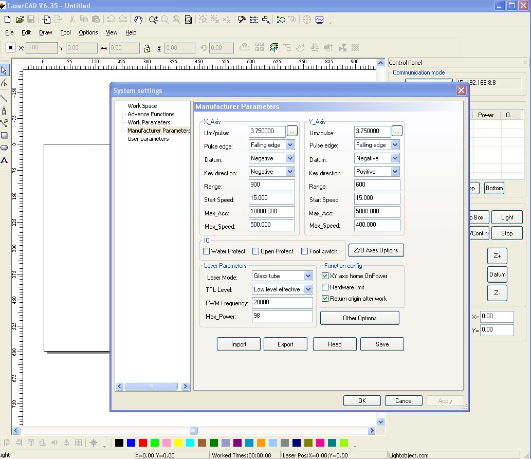

Now I read about a setting/choice that if incorrect will or can cause miss alignment issues....All I have to do is find where I read it
Found it ...look at the "pulse edge" setting. The manual says
"[Pulse Edge]: Trigger edge when motor is rotated by motor driver. If the pulse edge setting is not correct, may lead to cutting dislocation."
hope this helps

Indeed you're getting somewhere.
hope this helps
John

Thanks guys,1n2 wrote:Hi Dan
hope this helps
John

How do you tighten the X-Belt on these machines?
Is it possible that the pulley could be slipping?
If i could remove any chance of the problem being a mechanical one i can move on to look at other things.

Hi Dandubstar_04 wrote:How do you tighten the X-Belt on these machines?
I would think it doubtful if its a belt slipping especially at the low speeds you tried also a slipping belt would give random results (or at least a worst effect than you are getting ie slipping at each end of the axis) and a belt with teeth missing would surely cause every cut to step out of align where X meets Y ?

Re: Dubstar_04 - 40w Chinese Laser DSP Conversion
Dan, what is setting of pulse setting on your DSP, Falling edge or Rising edge?
If you have Rising edge, change it to "Falling edge", one by one X & Y see if any improvement

I am using the falling edge. Is it worth trying rising edge?
Dan
Dan
Tech_Marco wrote:Dan, what is setting of pulse setting on your DSP, Falling edge or Rising edge?
