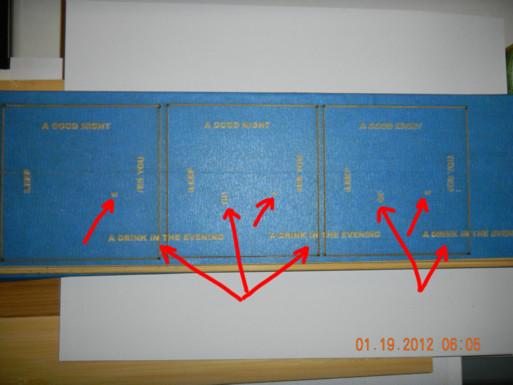

here are another sample where it jumped out but this time without that any chnges was made.
the job did run tree times perfect and the this jumpe has happen ( see picture) and ruined the piece
the new boards looking fine now I will send you my old one but without the cabel for the LCDpanel
and the USB to safe some money
I would aske you that you send the new one right back because I have jobs stacked up now
the red markings are where the jum p happen

Re: I need help verifying jump when setting change on LCD pa
waltfl wrote:Hi marco
Walt:
Why don't you just purchase a new set and return the one for refund. That way, no 'empty period'. Plus, I think the jupming issue was not associated to the DSP, it could be the stepping driver. Or, you can verify it by swapping X and Y to try it.
I'm having stomach flu and I won't do any test for today or tomorrow. I need some rest.

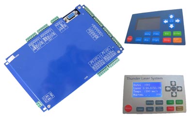

Now a question what is shown on your website is completly different it is a PH system not a AW 608B system
what is wrong on this picture??? I dont want a PH system i want the better AW 608B system
please let me know ASAP that I can order it.
