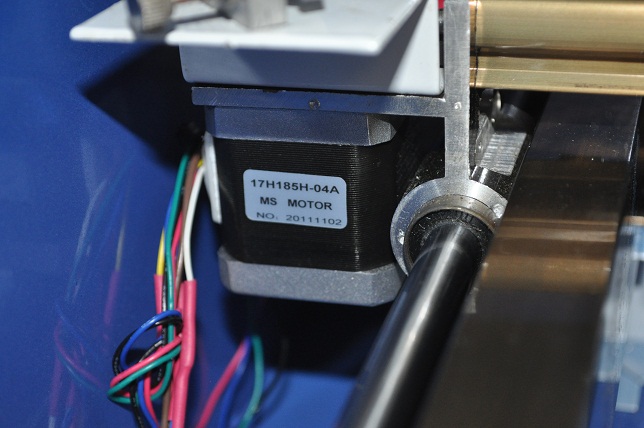

I have replaced the X motor with a Nema 17 and the heat issue is gone, so it must off been a bad motor. the nema 17s are a lot bigger in size to but fit perfectly.

I found that the Nema motor does run a lot better and smoother.
I do mostly engraving than cutting.
I gave it a good run and it didnt even get warm.
It also runs a lot quicker without missing a beat.
Definately worth the change.
I havent changed the Y axis one yet as its running really well and not giving me any trouble, nor does it get hot.
If you change the Y axis motor dont forget to order the dual shaft version unlike the X axis one that is single.
I will fit mine to my bigger x/y chassis when I get round to making it.
Ian

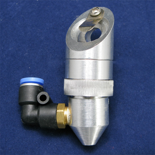

See the air-assisted laser head I just received.
http://www.lightobject.com/Product3.asp ... egoryId=17
Only 30x available at this time. With help from this module, the power can be boosted by 20%. I could cut 3mm expozy glass with the new laser head or 2.5mm without

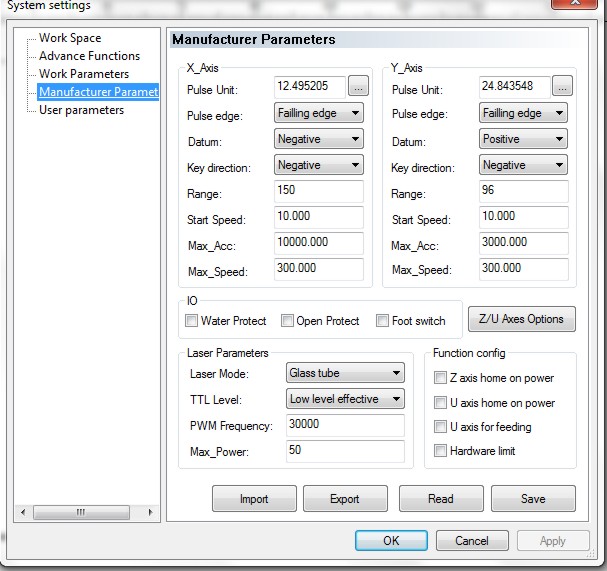

I have replaced the Y motor with a nema KL17H247-168-4B from keling it worked super but you have to change the hole in the pulley if you have the version with 5mm axel also the couppler on one site ( half) for the pulley take a 1/4 inch drill bit measure the diameter they are differ about 1/132 and you need the smalest one or better teke a reamer then you have to press sit the pulley. take the short end for this. to press sit take the motor set it on the long end of the axel and put the pulley on the short end then take something like a piece of brass and carefully give it a light blow with a
. the probleme is that the most pulleys in the K40 are only 18 teeth and I could not find one anywhere MXL 18 teeth with a 6mm bore only 20 teeth but then I needed to change both sites and the extension axel too.
here are the settings I did not replace the X axis motor jet it gets hot but it still works fine set on 1.0A 1600 steps.
download/file.php?id=690&mode=view.

The motor ID number on my Nema 17 is 17H185H-04A.
Running at 8 micro steps at 1.8 amps.
