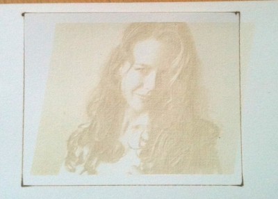

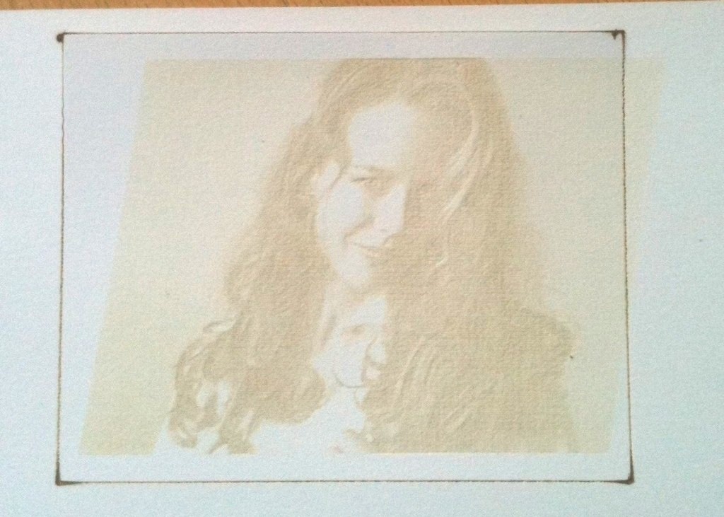

I have a problem with engraving too. I guess it´s a settings issue... The output is skewed/slanted, it´s like as if every line is shifted one step to the left, and eventually the laser head will hit the limit switch. This is very consistent, and I don´t think it´s a mechanical problem.
Any ideas on that?

It is in how you have your drive wired up. Read this: http://www.buildlog.net/forum/viewtopic ... 5638#p5638pairair wrote:Hello!

Thanks Tim!
That solved it.
