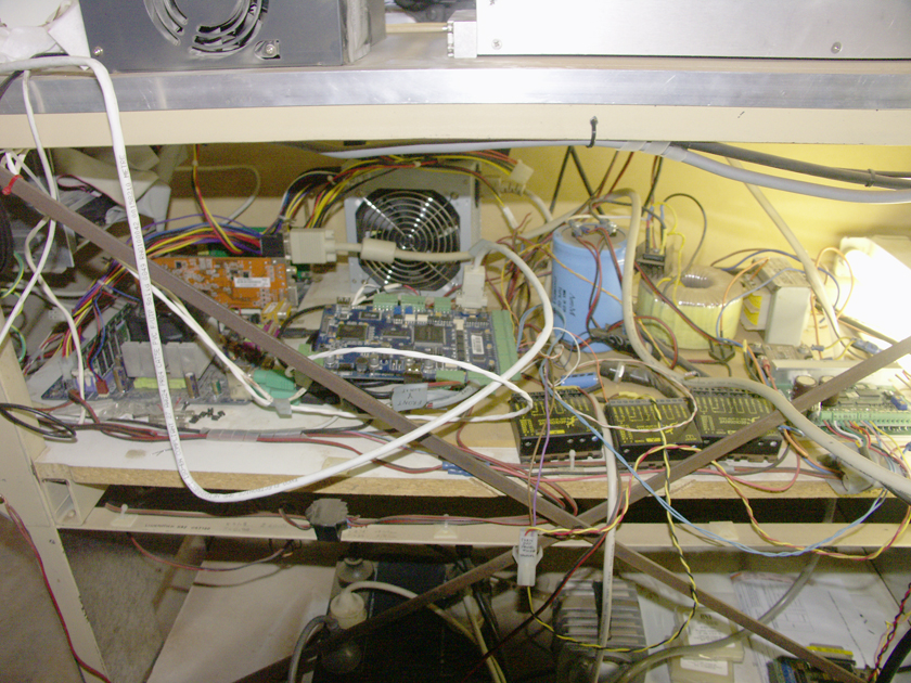

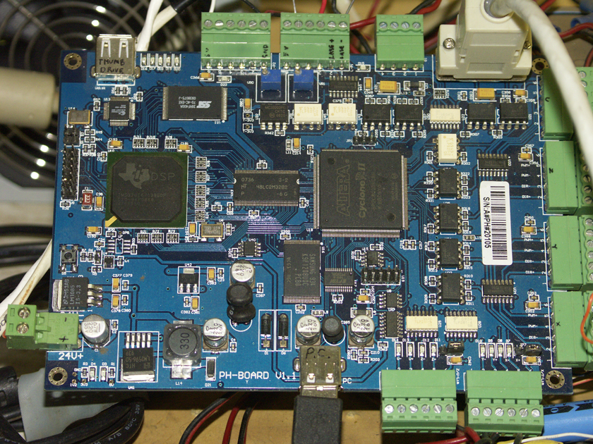

Here are some pictures of my setup and the DSP board.
The wiring is really crappy but I have rewired it probably 15 times so I am not bothered with making it tidy at the moment.
When I need to do Raster engraving I have to revert to the old Linkmotion set up which means I rewire the whole thing which takes about 10 minutes to do. (I can do it blindfolded now) Then I just re-enable the old software.

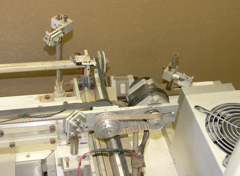

I replaced the X axis drive pulleys and belts with XL type and not the XML which was way too small in the tooth.
I still have the same problem. I just can't get below 1mm offset when engraving.
I tried pins 1-4 again for the umpteenth time and all I get is 4.8 volts constantly with no modulation.
I tried Laser with NO pre-ignition. Still the same

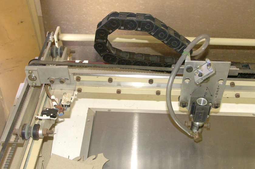

The X axis limit switches don't work. The light on the board lights up but the board wont recognize it so it keeps banging it's self to pieces when homing.
I wish I could turn the Auto home function OFF. It wastes too much time and is a pain when it doesn't work properly.
PWM Logic High pin 4 not working on Laser output

I haven't got the X-axis limit switch working either. That's another problem. The led on the board works but the board won't process the switching and stop or reset the home limit.

The X limit connection is 1 and 4 while Y limite is 1 and 2

One more thing you need to pay attention. The polarity of X & Y limit is selectable from the software. You need to double check it. See page 6/12 of the "Specification of MC-Board.pdf"

I swapped the RH X limit wire from 5 to 4 and swapped all the setting about in the software and now it's working fine. Thanks for that.
I also tried the laser settings on pin 5 but I still get the same result. No lasing on 5, full power all the time on 4 and modulation on 3 but with double image 1mm apart.
Re: PWM Logic High pin 4 not working on Laser output
Manually set the power to 50% and the output should be 2.4~2.5V
If no, then you need to send it back for exchange. Also, I'm taking a trip to China on next Monday 10-11, if you need to send it back do it asap with Priority Mail. I must receive it by the end of this week

I finally tracked down the 1mm over-strike problem.
The new XL belts I bought last month don't fit the new XL pulleys properly. Grrrrrr!!!!
With all the tension on them it was hard to see the movement.
The trapezoidal shape on the pulleys wasn't deep enough for the belts to seat all the way into the groove and the teeth were riding on the bottom of the profile instead of the flanks. NOT GOOD !
I have now ordered another 2 new pulleys and 2 belts (1 spare) with the HTD-5 profile and 15mm wide.
These have a round profile and should fit properly into the groove.
I checked 2 of my other machines and they have the same problem with less movement than the laser table has but it is still there. I know what to look for now. Buying new sometimes isn't as good as you think.
