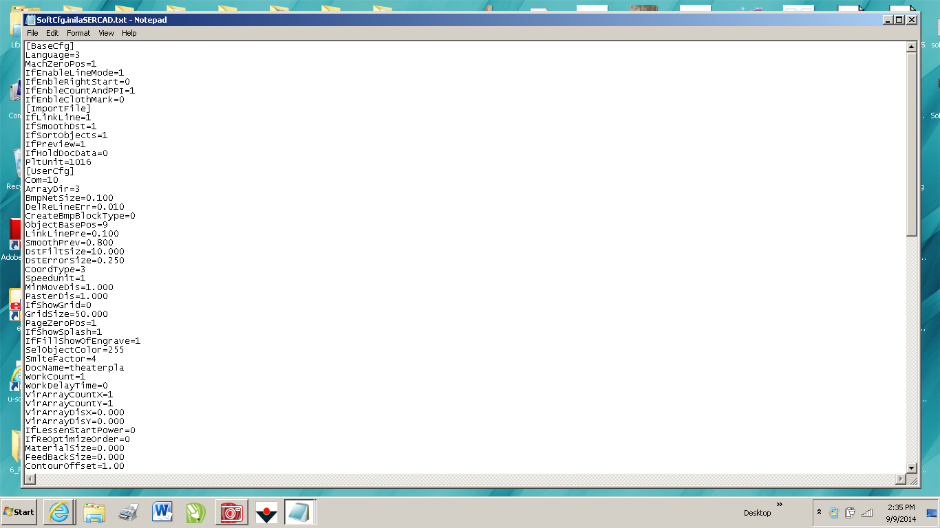

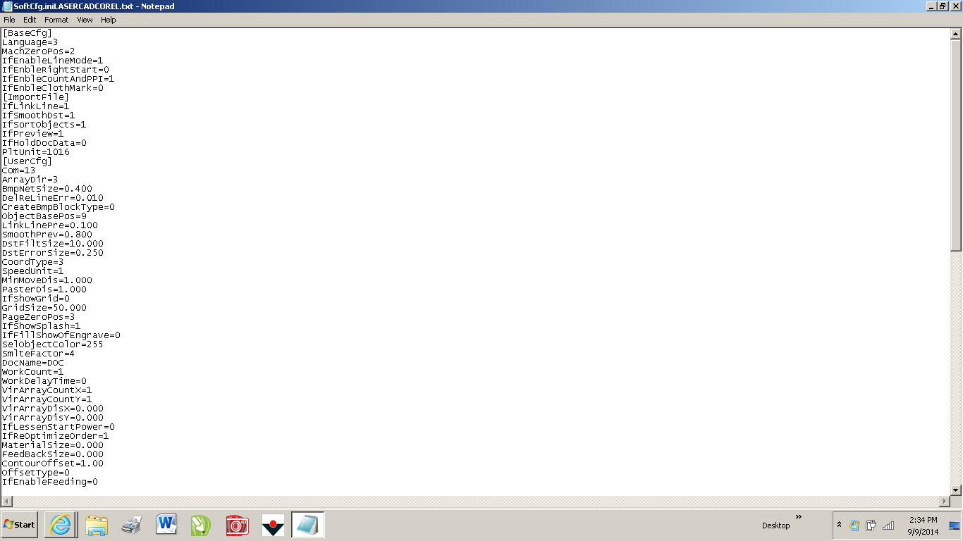

hi marco
here are the printout of both softcfg files from lasercad corel and lasercad stand alone

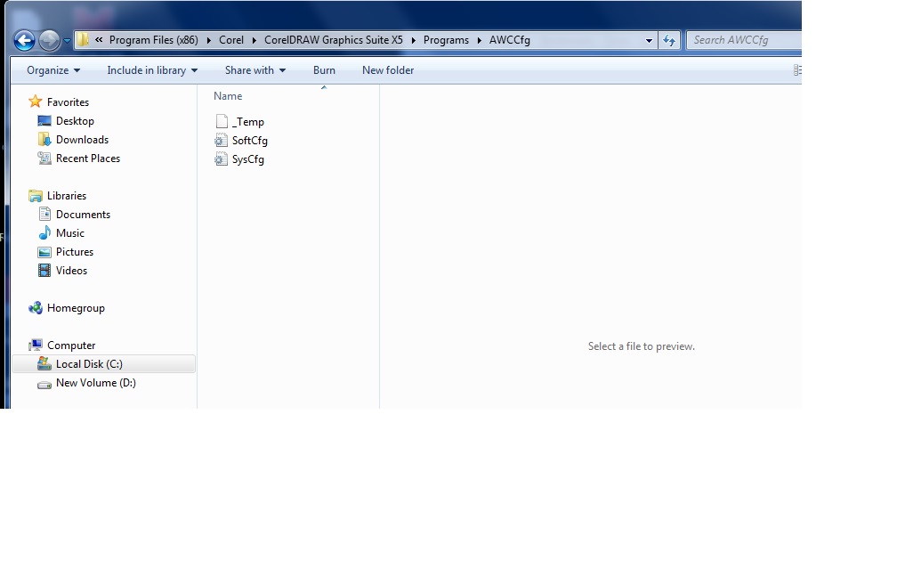

Walt, trust me, it must be there!
When you use CorelDraw to initiated LaserCad, it will create a temp file to the the "Corel" folder. See the path on the image attached.
If there is none, then I don't know what else I can do. Then, it must be your system somehow somewhere remembered the old setting.
