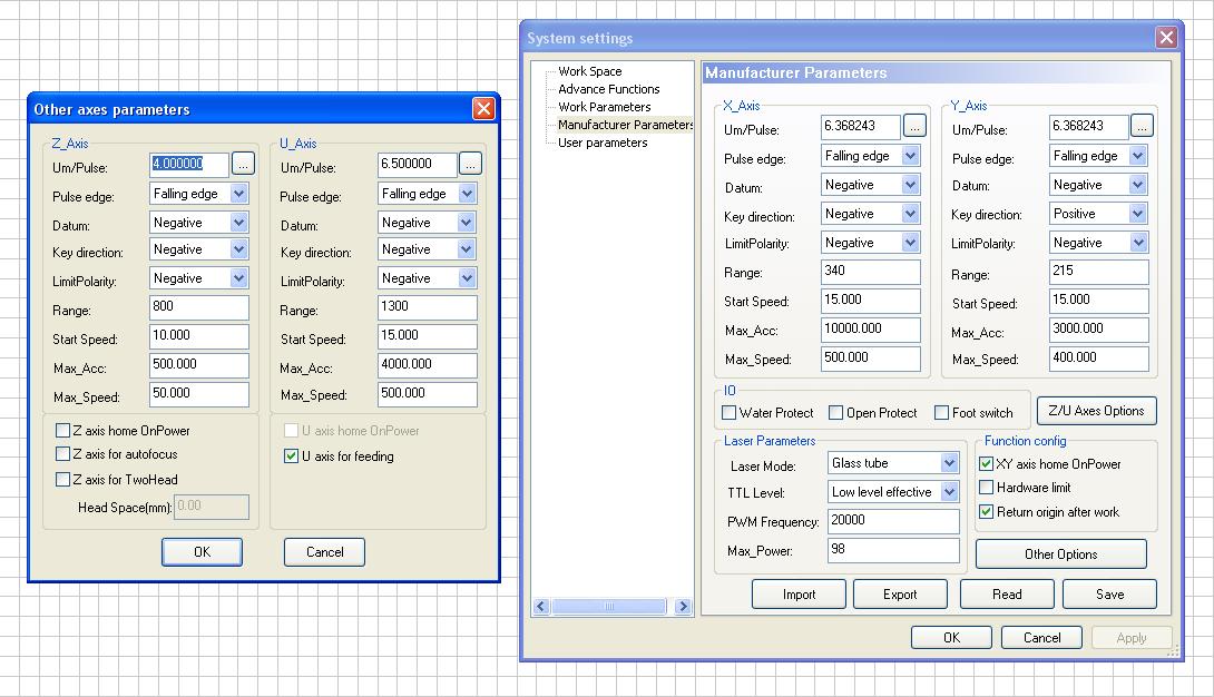

If you don't have limit switches installed and setup on the Z table, the DSP will initialize the position of the table to the middle of the range (set in the Z-axis section of Manufacturers parameters). If the table is not physically in the middle of it's range upon powerup/reset, the full mechanical range will not be available.
It seems that it is not possible to set the correct µM/pulse value to achieve the proper Z axis distance calibration. The table has a range of 80mm of movement, which would require a µM/pulse value of 0.4. Unfortunately, values of less than 1 are not accepted by the software.
My work-around is to set the Z axis µM/pulse to 4, and set the range to 800mm. I just remember that the indicated values are always 10x the actual distance. (i.e 750mm on the display is really 75mm)
Whenever I powerup the DSP, it automatically sets the current position of the Z-table to 400mm (40mm) regardless of where it physically is. This value will only be correct if the table was parked at the 400mm physical position when it was powered down.
Since I currently have no limit switches on my table, If I want to calibrate the table I use a set of dial calipers to set the table to the midpoint of it's range, and then hit the reset button. The DSP then sets the Z-axis to 400mm (40mm).

What version of LASERCAD? The main difference in smooth operation I found is the level bed with the nuts on the threaded rods loose until the bed is completely level; once set operation is smooth. But other options may not be available to configure in my version of LASERCAD.

Go into manufacturer parameters and click Z/U axes options.
