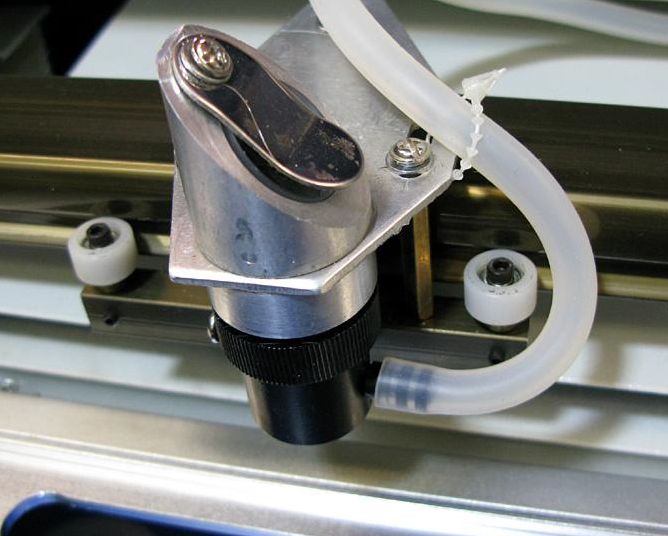

ok real quick question, the laser head mount that is included with the kit, comes with air assist barb, in the pictures it has the fitting that goes over that barb, but it was not included, i even ordered another one just to make sure i get it but even separate one did not come with that connector, can someone tell me what i need to get

Re: Rookie at Laser, NEED stupid questions answered
<img id="ProductImage" src="/Assets/ProductImages/LHK40AS2-500.jpg" border="0" alt="18~20mm Laser head w/ air assisted. Ideal for K40 machine">
this is the L shaped thing, i did not recieve on mine, i dont get it
We changed the connector to a small "M3" barb as using the "L" type air host connector make it so bulky and blocking some space
See image
See image
