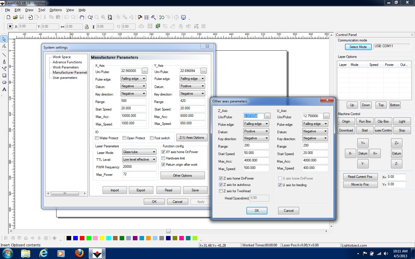

Re: Z axis soft limits
Greolt, where did you find the ""Other Axis Parameters". I couldn't find it on LaserCad.
Can you post a screen shot
Attached image is what I have on the setup panel

If you look at the picture that you posted in the above post, you will see the smaller of the two windows is called "Other Axis Parameters"
Greolt
