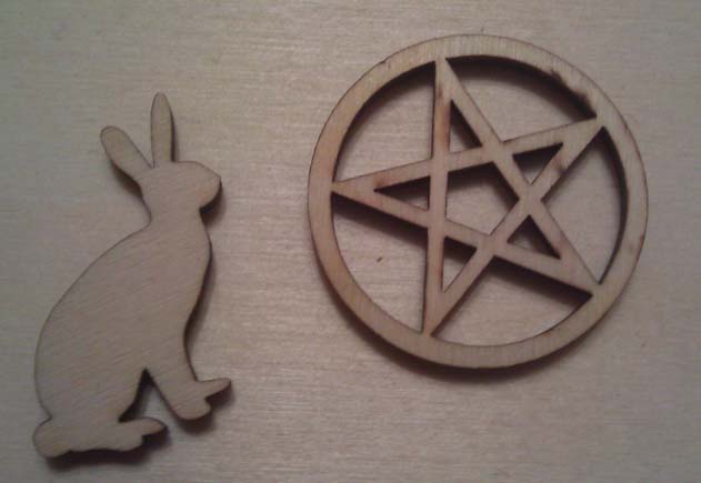

Have popped up a couple of pictures of just some cutout I made (basically testing and playing)
this is the cut from the top.the pentangle is 1" dia
When using mesh for the tables I think I must be getting reflected heat which was burning the wood even with my home brew air assist. (a nice one from Marco is next up)

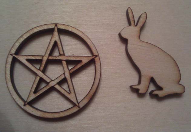

same cut but from underneath ..next to no burning....

I am making a little progress.
Power:
It seems to be a problem with using the PPI feature. i.e If PPI is selected the machine cannot fully cut 3mm Birch ply with a power setting < 75%
Without PPI, 10mm/s and 25% power gets a clean cut.
Alignment:
It seems that the problem is caused by engraving.
if i cut an object that has no engraving it works fine,however ifi cut the same object with engraving it all becomes missaligned.
I can reproduce this consistantly.
