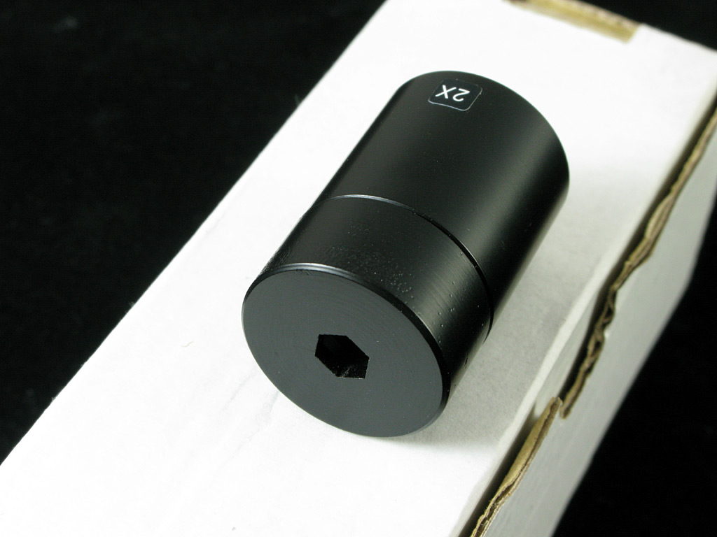

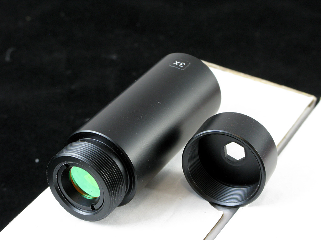

See current 2X and 3X beam expander.
2X: 10mm/10mm lens (in/out)
3X: 10mm/19mm lens (in/out)
I was told that there was 2.5x available with 10mm/28mm lens.
Also, another model of 2x is available with 10mm/19mm lens

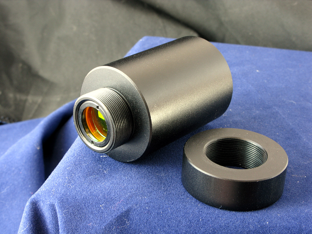

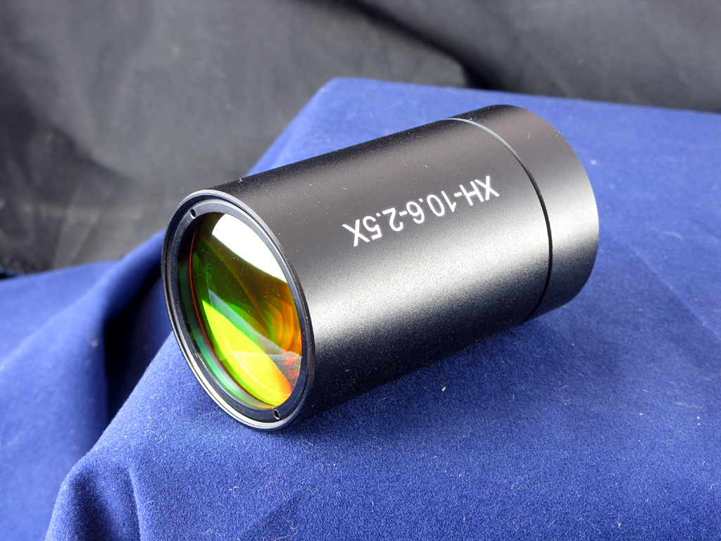

Folks, beam combiner of 20mm and 25mm arrived. The lens mount was ordered and it should come in about 2~ 3 weeks
A new design of 2X and 2.5X beam expander also came and it's so beautiful. See the picture of the 2.5X!!
- Expander25X1.jpg (313.12 KiB) Viewed 7990 times
- Expander25X2.jpg (299.33 KiB) Viewed 7990 times
