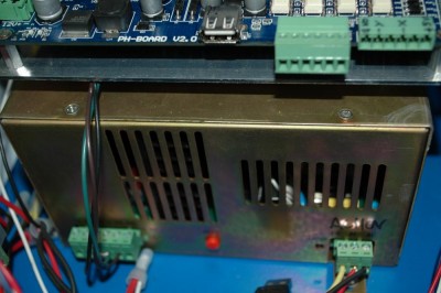

Just got my DSP today. I have the same Laser power supply as seen in Dennis's pic below. Am I correct that with this PWM Laser Power Supply and the DSP that the big green resistor is NOT needed and can be removed ?

That is correct. PLEASE ensure that you are not overdriving the laser tube. Use a mA meter and don't go over 18 mA. The DSP will likely be at about 50%-60% to max out the tube.SScnc wrote:Just got my DSP today. I have the same Laser power supply as seen in Dennis's pic below. Am I correct that with this PWM Laser Power Supply and the DPS that the big green resistor is NOT needed and can be removed ?

Pay close attention to what Tim says about overdriving the tube, its very easy to do. Once you have it hooked up you can set the power in the control panel and use the laser button to test power the mA being sent. Start at around 7% and slowly increase the power till you get to around 15ma. I have the same power supply and with the 2012 DSP I max the tub at 15ma at only 32%. Once you know your max set that max in the manufacturer parameters to prevent the software from accidentally going over that.

twehr wrote: That is correct. PLEASE ensure that you are not overdriving the laser tube. Use a mA meter and don't go over 18 mA. The DSP will likely be at about 50%-60% to max out the tube.
Okay, thank you both for your very helpful information ! I will do just as you describe. I just got my DSP working tonight, still have some issues to work out with the BuildLog 4 axis board running the steppers but at least I have movement now. I have the AC unplugged from the LPS while working out these issues then will move on to the laser operation.Gadroc wrote:Pay close attention to what Tim says about overdriving the tube, its very easy to do. Once you have it hooked up you can set the power in the control panel and use the laser button to test power the mA being sent. Start at around 7% and slowly increase the power till you get to around 15ma. I have the same power supply and with the 2012 DSP I max the tub at 15ma at only 32%. Once you know your max set that max in the manufacturer parameters to prevent the software from accidentally going over that.
