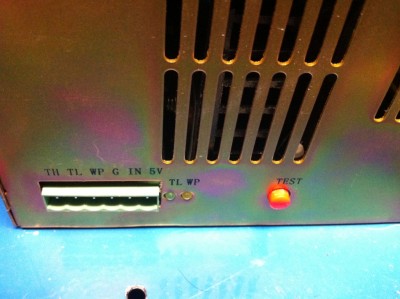

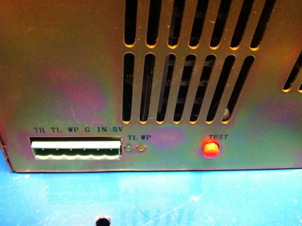

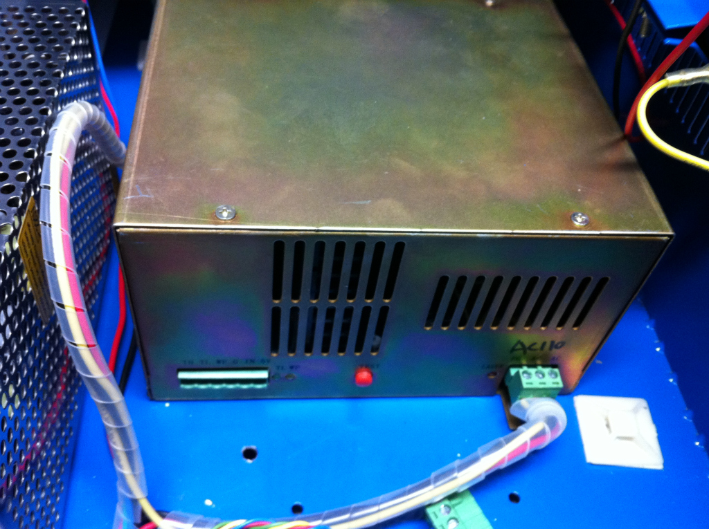

Hi everybody! I'm new in to this forum and guess what! I also purchased one of those chinese laser engravers with "moshidraw" which forced me to do a major surgery to it by converting to the DSP controller. Well I got the 2012 controller and the stepper drivers this week and I already started working on it. I got the stepper motors working, limit switches installed, laser power supply connected and now is time for some questions and help.
How can I find out if my laser power supply is capable for PWM mode? If it is not PWM capable, is there any module than can be in between to make it work as PWM mode? I just want to avoid to buy another LPS if possible as money is tight right now.
I will appreciate a lot some help, Thank you!

put a picture of your power supply

Hi Marco, I still a little confused and I hope you understand that. My machine came with this power supply and it has the big green coil in series and I don't know if I need to bypass it now that I'm using the DSP, Should I? also let me make sure I understood you, (you say my power supply is PWM capable or not)? if yes, how do I enable PWM for photo engraving?
Other than that I got my stepper motors running nice and smoothly after a few hours of experimentation with different parameter settings, however it may still need a better tuning but that will come with practice and experience with it.

The Power Supply you have IS PWM compatible.wctx1977 wrote:Hi Marco, I still a little confused and I hope you understand that. My machine came with this power supply and it has the big green coil in series and I don't know if I need to bypass it now that I'm using the DSP, Should I? also let me make sure I understood you, (you say my power supply is PWM capable or not)? if yes, how do I enable PWM for photo engraving?
Where is the green coil - on the return from the laser tube or in series someplace between the lps and the controller? If it is on the tube side, I would just leave it alone.
You don't have to "enable" PWM. The LPS takes whatever is presented to it at the "IN" pin. If it is analog (0-5v) then it treats it as analog. If it is PWM (5v - 0-100% frequency) then it treats it as PWM. Just just the standard minimum connections from the documentation and the laser should fire just fine.
You mentioned "enable PWM for photo engraving". The PWM is not related specifically to engraving, or photos, or cutting. It only sets the power at which the operation will be done. For a photo, as example, the entire bitmap will be engraved at the power level set by the software. That level is communicated to the lps via PWM (or analog). If you are thinking that the PWM will make it change levels with various shades of gray, that is incorrect.

Hi twehr,
I appreciate your info and your willingness to help others. Sorry I was confused and thinking that PWM was related specifically to photo engraving. My laser seems to be shooting just fine but then don't know what I need to do to make it engrave photos with various shades of gray. I'll be playing more with it today and see what else I can find.
