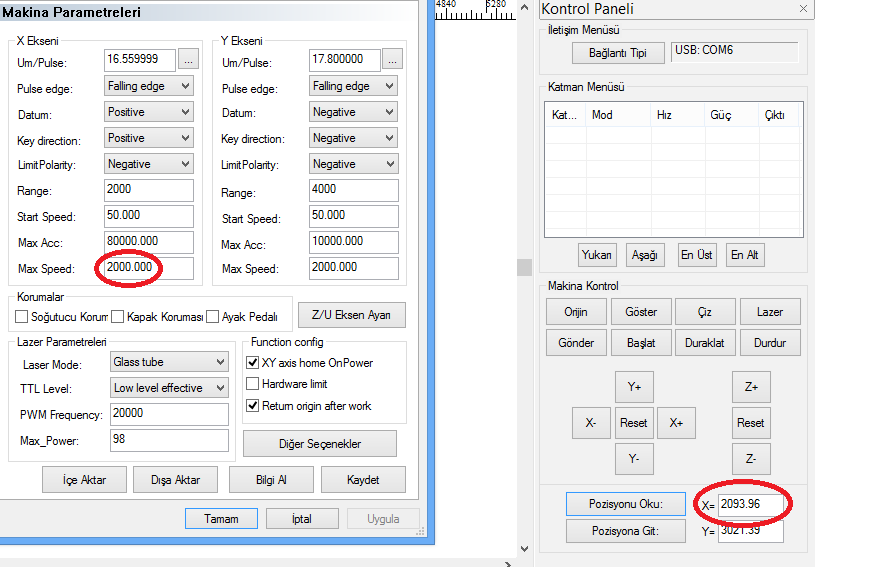

I use yaskawa servo 750watt but this problem continues when I remove all pin connections to DSP too.
X range: 2000 mm
Y range: 4000 mm
When I press key move button (right or left ) X goes out of my range limit.
As you can see on picture, my limit 2 and 4 meter but both out of limit when I press key move.
And when I press again its moves back to limit position.
Please I need help for fix this problem.
Again It happens when all pins out too. ( I tried 2 DSP both same problem)

I used Yaskawa analog position servo driver . So it works with pulses and directions. There is no microswitch just "virtual gear"
It works like microswitch. So we gave um/pulse from controller and forward x axis like 10mm and if its not 10mm we change virtual gears.

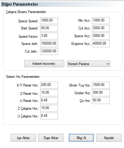

But I think problem is acceleration I can give much high acceleration then stepper. So I dont think controller handle much acceleration. Its why cant stop and slips out of range.
By the way its not about servo. I removed all pins from controller and tried again ( I tried 2 DSP both same result)
I think acceleration is problem with servos for your controller. When I gave high speed servo accelerate suddenly and brakes realy hard. So looks like there is no acceleration. there is no ramp on speed. when I give lower acceleration like 10000 servos move too much for engrave ( 30cm move for 10cm width engrave area)
I think there is acceleration problem with high powered servos.
