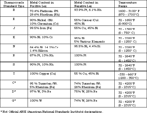

Maybe you could have a tray of water underneath the tray of food. If you are just keeping food hot then that would be the best way as it would be even heat throughout and quite easy to measure the temp with a normal thermocouple. Bain Marie style.
I have included a file/picture with the different types of thermocouples you can get.
I use the K type for my furnace as it goes way up near the melting point of steel and is just right for heat treatment and finding out when it is a good time to pour Aluminium. Really hot if doing small intricate pieces or just melted for large bits without much detail.
I think your best bet would be the J type as it is readily available.
